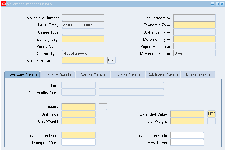

To create a manual adjustment record, use the Miscellaneous Transaction Type:
Movement Statistics Summary
Using the Movement Statistics Detail form, you would create the necessary adjustment record:

Alternatively, instead of updating an existing arrival movement record, you can create a new arrival movement record if the movement record status is either Open or Verified, and if it has been invoiced. Complete the following steps to create an arrival movement:
Navigate to the Movement Statistics Summary window.
Select File > New to display the Transaction Types window. Enter the Legal Entity, and Transaction Type = Miscellaneous.
Click OK.
