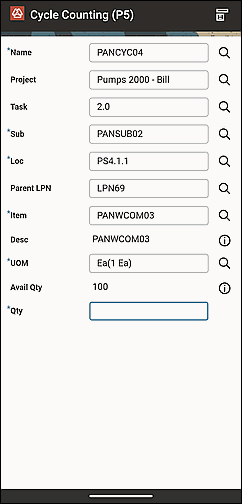

Cycle Counting in Oracle Project Manufacturing and Oracle Warehouse Management Enabled Organizations
You can identify the Locator by scanning the physical barcode, followed by the Project/Task label that was prepared when the inventory was introduced.
Count reporting is performed for each Storable Unit, which carries a unique Project / Task.
For a project manufacturing-warehouse management enabled organization, on navigating through the regular cycle count page, the List of Values field for project and task is displayed.
For unscheduled count entries not allowed cycle count, project/task is restricted to only those locators that have been defined in the schedule request. (Example: Suppose a subinventory has Projects P1 P2 P3 defined. The material for which the counting is to be performed is in project P1 and P3 only. Then the Project LOV shows only Projects P1 and P3).
For unscheduled count entries Allowed cycle count, all projects/tasks defined in that Organization are available (Example: Suppose a Organization has Projects P1 P2 P3. the material for which the counting is to be performed is in project P1, then the Project LOV shows all the Projects i.e. P1, P2 and P3)

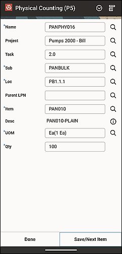

You perform physical inventory through mobile device, you must define physical inventory and generated tags using desktop windows.
Log into the mobile device and navigate to the Physical Counting window.
Physical Counting Window
When the Allow Dynamic check box is unchecked in the physical inventory, project an task is restricted to the locators you defined in the Physical Count header. (Example: Suppose a subinventory has Projects P1, P2, P3 defined. The material for which the counting is to be performed is in project P1 and P3 only. Then the Project LOV will show only Projects P1 and P3).
When the Allow Dynamic tags is checked, all projects and tasks defined for the organization are available for selection (Example: Suppose a Organization has Projects P1 P2 P3. the material for which the counting is to be performed is in project P1, then the Project LOV shows all the Projects i.e. P1, P2 and P3).

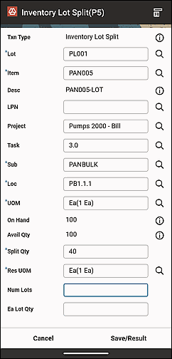

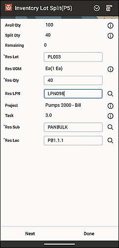

Lot Split functionality allows you to split a lot using a Mobile Device. For a project manufacturing organization, Project and Task fields are displayed on the start Lot and resultant lot windows. The resultant lot from lot split have same project and task as original lot and are not editable. project and task are editable for the first start lot only.
In the result page, the Project, Task, Sub-inventory and Locator fields are defaulted from the start lot page. The defaulted values can be changed for all except for the Project and Task fields.
In the start lot page, if LPN is entered, the project, task, sub-inventory, locator, on hand and available quantity defaults from the LPN, but Project and Task fields are non-editable
If Start Project and Task fields are not entered, Result Project and Result Task fields do not display.
If there are any lot attributes for the item, Lot Attribute page is displayed after entering the Result Lot.
Inventory Lot Split
Inventory Lot Split Continuation

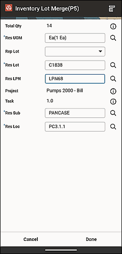

Lot Merge functionality allows you to merge lots using a mobile device. The Resultant Lot from Lot Merge have same project and task as Merged Lots and are not editable. Project and task are editable for the first start Lot only. With the project manufacturing integration, Project and Task field are displayed on the start and result windows. At least two or more lots can be merged into one resultant lot.
Inventory Lot Merge
Lots can be merged only from the same project and/or task.
If for Start lot, Project and Task fields are not entered, Result Project and Result Task fields will not be displayed (Non-Project Lot Material)
If LPN is entered, the project, task, subinventory, locator, on hand and available quantity are defaulted from the LPN but, the result project and/or task are non-editable.
Project and Task fields are only editable for the start lot. The following lots defaults the values of Project and Task fields, from the start lot and Project and/or Task are non-editable.
If there are any lot attributes for the item, Lot Attribute page will be displayed after entering the Result Lot.

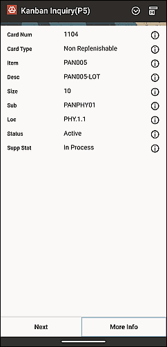

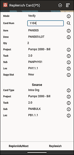

The Kanban Replenish pages and Kanban Move Order show Project and Task information for project manufacturing organizations. Kanban Pull Sequence can be created for source and destination locators, which are associated with same Project and task. However, once the Project and task is defined, it is non-editable on the mobile page.
Replenish Card
Kanban Inquiry
Note: If project inventory resides in an LPN, only material or LPNs with the same project and task can be packed to that LPN.
