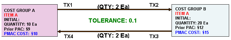

The significance of the iteration process is illustrated in the following example.
There are two cost groups, CGA and CGB, under the same legal entity. Each cost group is associated with the appropriate inventory organizations. Use an example of a recursive inter-organization transfer of Item A between these two cost groups. Period beginning quantity and prior period PAC in CGA are 10 each and $9 respectively. Similarly in CGB they are 20 each and $12 respectively. PMAC is the current period moving periodic cost calculated prior to valuating the inter-organization transfers.
This transfer can be viewed as four transactions:
TX1 is inter-organization shipment from CGA
TX2 is inter-organization receipt into CGB
TX3 is inter-organization shipment from CGB
TX4 is inter-organization receipt into CGA
Standard PAC:
In standard PAC, TX1 and TX2 are valuated at $9 (prior period PAC of sending cost group) and TX3 and TX4 are valuated at $12.
IPAC:

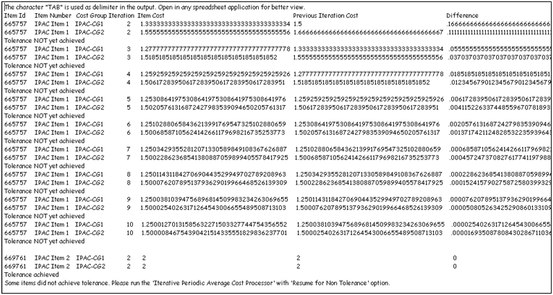

In IPAC, these transactions are valuated using an iteration process. At the end of each iteration, item PMAC cost (aggregate of all sub-elemental costs) is compared with the item PMAC cost derived in the previous iteration and it is verified that the difference is within the tolerance. Tolerance can be specified when running this process. PMAC is calculated using the following formula:
You should first consider CGA. TX4 is a receipt and must be valuated with PMAC of CGB: 15. Based on this, the revised PMAC for CGA is 10.833. Use this to valuate TX1 and TX2. Based on this, the revised PMAC in CGB is 14.6212. At the end of one iteration, the costs in both cost groups are:
Because the tolerance check is done between the item cost in nth iteration with the item cost in the previous n-1 iteration, no tolerance check is done after the first iteration. Tolerance check is done from 2nd iteration onwards. In this case, the second iteration is performed at the end and the costs will be as follows:
Differences after the second iteration are as follows:
CGA: 10.8333 - 10.7702 = 0.063
CGB: 14.6212 - 14.6154 = 0.0058
Because the difference is within tolerance, the iteration for the item ends at this point and these costs are used as periodic costs for further processing.

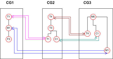

Absorption Hierarchy
Absorption hierarchy determines the correct sequence for processing items. This absorption hierarchy is derived based on the BOM level of an item across cost groups. Use the following procedure to determine the absorption hierarchy:
Identify the corresponding level in all existing BOM across cost groups for each item.
Identify the highest BOM level across cost groups. Items that are not involved in any BOM are treated as leaf nodes, or at the lowest BOM level.
Create a unique hierarchy with the levels identified in the previous step, further resolving any interdependencies of the item levels across cost groups. This hierarchy determines the priority sequence in which items should be processed. The process starts from the lowest level (leaf nodes) and moves to the highest parent level.
The following example illustrates the Absorption Hierarchy:
In this example, there are three cost groups CG1, CG2 and CG3. There are three BOM structures with different items in different levels. The lowest BOM level is considered as the leaf node and is represented by number 1000. The next higher levels are represented as 999, 998 and so on. The BOM level for each cost group from the above illustration will be:
| Item | CG1 | CG2 | CG3 | Highest |
| F3 | 1000 | 1000 | ||
| M1 | 999 | 1000 | 999 | |
| T1 | 998 | 1000 | 998 | |
| C1 | 1000 | 1000 | 1000 | |
| T4 | 998 | 1000 | 998 | |
| M6 | 999 | 999 | ||
| T3 | 999 | 999 |
Further analysis is done to resolve the item level dependencies between cost groups. In the above example, items M1, M6, and T3 are at the same level of 999. However, T3 cannot be processed before T1 because T1 is a child item for T3 in cost group 2. Similarly, M6 cannot be processed before M1 and T3. Such interdependencies are resolved and a unique hierarchy of eligible items is derived for this example as follows:
| Item | New Level Codes |
| F3, C1 | 1000.0000 |
| M1 | 999.0000 |
| T1 | 998.0000 |
| T3 | 997.0000 |
| T4 | 996.0000 |
| M6 | 995.0000 |
Items F3 and C1 are first processed for deriving their periodic costs, and then the next level of items are processed.
Deadlock Scenario
There can be a deadlock scenario when there are BOM loops across cost groups. in a deadlock scenario, the same item is a parent and child of another item. For example, Item A is a parent of Item B in cost group 1, and Item B is a parent of Item A in cost group 2. In such cases, the IPAC process ends abruptly and you must resolve the deadlock scenario and run the process again.

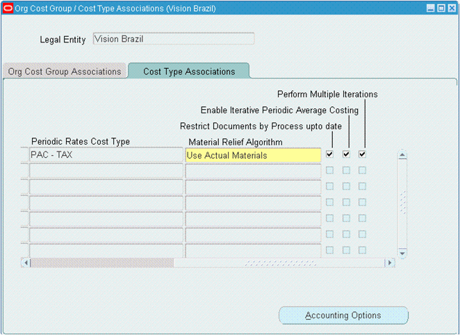

IPAC is set up in the same way as standard PAC. The only additional step is to enable IPAC when defining the legal entity cost type associations.
To enable or disable IPAC
Navigate to the Org Cost Group / Cost Type Associations window.
Select the Cost Type Associations tab.
Select the Enable Iterative Periodic Average Costing check box to use IPAC.
You can also select the Perform Multiple Iterations check box. This attribute determines whether multiple iterations should be performed until the tolerance is achieved when inter-organization transfers across cost groups are processed. If this is not checked, then only one iteration is performed.
Note: You can leave this unchecked to improve the performance if you do not follow stringent standards to comply with the tolerance.
Save your work.

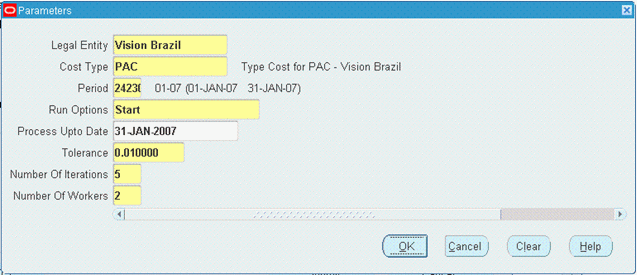

IPAC is calculated by running the Compute Iterative Periodic Average Cost concurrent program.
To run the Compute Iterative Periodic Average Cost concurrent program
Navigate to the Compute Iterative Periodic Average Cost concurrent window. The Parameters window displays.
Note: Run this process for all cost groups under a legal entity and cost type.
Enter Run Options. Run Options include Start, Resume From Error, Resume for Non Tolerance, and Final Iteration.
Start - Start the processor from the beginning. The application will re-run the process for all items and transactions, regardless whether the tolerance is achieved for any of them in earlier runs.
Resume from Error - Resume from error can be used when the program ends abruptly due to some unexpected errors or due to deadlock scenario.
Resume for Non Tolerance - Resume from non-tolerance can be used when the program ends but the tolerance is not achieved. This option resumes the processor from the Rollup Iteration Process, only for those items that have not met the tolerance required, in earlier run.
Final Iteration - Finish the iteration process regardless of the tolerance achieved for the items. The option Final Iteration can be used when the earlier run ends in non-tolerance but you would like to finalize the periodic costs with whatever values are arrived at after one more final iteration. This option is applicable if you are not too particular of achieving the tolerance.
Enter Process Upto Date. This value defaults to the end date of the current period. You can specify the date for selecting the transactions that should be processed by the program. This date must be within the period specified above.
Enter Tolerance. Specify the tolerance that the variance should be within.
Enter Number Of Iterations. This is the maximum number of iterations that should be performed. The iteration process ends after the tolerance specified is achieved or the number of iterations is completed, whichever occurs first.
Specify the Number Of Workers. You can specify the number of workers that can be processed simultaneously to enable parallel processing and to improve performance. This number should be less than or equal to the number of cost groups.
Click OK.
The report output of the process displays the detailed iteration calculation for all items and cost groups. You can review the report for details. Any errors or exception scenarios are included in the report. A typical report output would look like the following:

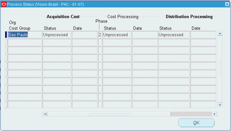

There is not a separate phase for tracking the IPAC process. The cost processing phase is used for tracking and viewing the process status for a period.
To view IPAC process status for a period
Navigate to the Process Status window.
Note: If the program ends in non-tolerance, then the status is shown as Resume for Non-tolerance.
