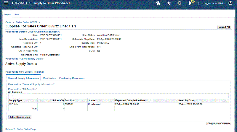

The Active Supply Details page can only be accessed from the Supply Type link on the Supply to Order Lines page for a given sales order line. The page displays context information from the line at the top of the page, then lists all the open supplies (WIP Jobs, Flow Schedules, Requisitions or Purchase Orders) for the sales order line.
Note: Inventory reservations are not created for the lower-level components. The reservation details are shown only for the top-level assembly in the header of this page.
This page has three tabs: General Supply Information, Orders, and Purchasing Documents. The General Supply tab contains information relevant to all types of supply, such as the Supply Type, Linked quantity, Document Number, Status, Expected Completion Date, and Need by Date.
The Work Orders tab contains details specific to work order jobs (Job Start Date, Start Quantity, Scrap Quantity, and WIP Job Lot Number) and flow schedules (Job Start Date, Start Quantity, Scrap Quantity). The Purchasing Documents tab contains details specific to purchasing documents (Requisitions, POs, and ASNs). This tab has two tables:
