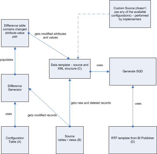

You can customize the System Generated Description (SGD) to meet your agency's specific requirements. The following diagram outlines how SGD is generated in CLM:
Generating SGD
In order to create simple customizations, you can change one or more entries in the Configuration Table (A) that serves as a registry.
In order to perform complex customizations, you can add/modify Source Tables / Views (B), add/modify entries in Configuration Table (A) , modify the Data Template (C) to get the values to XML, or customize the layout in RTF Template (D).
To create your own customized entries for generating SGD, you may not use any of the above steps and obtain the required differences directly on the data template from custom source (E).
The following steps outline the process by which you can perform the customization:
Review the SGD output from the predefined template.
Run the Generate XML for CLM Documents concurrent program to get the XML generated for SGD. Review the XML output to identify what to customize, that is, source to difference generator, data template or printing layout.
Create/Edit appropriate supporting views (this becomes the data sources for the difference generator). You should create customized sources if any change is required in predefined sources.
Configure the table that feeds the difference generator to pick the new attribute/source or to control predefined attribute/source.
Edit the appropriate data template to pick the new source/attribute. If it is a predefined source, and an attribute has been enabled in the configuration table, the difference generator will automatically report this difference.
Edit the RTF template to print the differences of the attribute added, if required.
