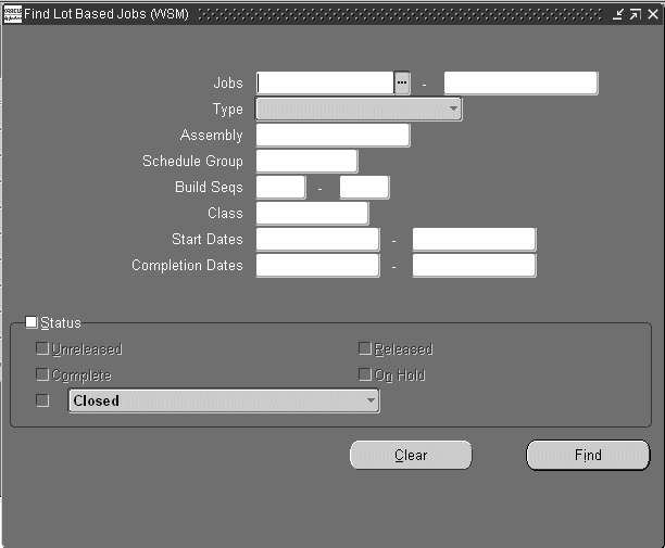

Navigate to the Close Lot Based Jobs window.
The Find Lot Based Jobs window displays.
Enter your criteria and choose Find.

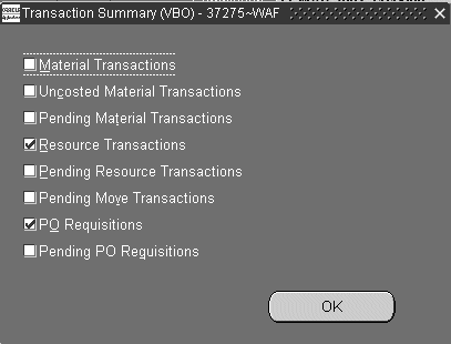

Select Transaction Summary from the Tools menu to view all pending transactions.
Only jobs without pending transactions can be closed.

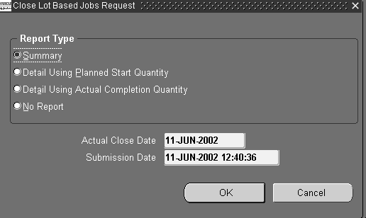

Select Close from the Tools menu to display the Close Lot Based Jobs Request window. This window is used to select close options.
Select a report type.
Reports are printed, per the Report Type specified, after the close process computes job close variances. The Discrete Job Value Report – Standard Costing is printed when standard lot based jobs and non-standard asset jobs are closed. The Expense Job Value Report is printed when expense non-standard jobs are closed. Report Type options and formats are as follows:
Summary: Lists each job and includes job header, period–to–date summary, and cumulative–to–date summary information.
Detail Using Planned Start Quantity: Lists each job using the planned start quantity of the job to calculate the material usage variance.
Detail Using Actual Completion Quantity: Lists each job using the actual completion quantity of the job to calculate the material usage variance.
No Report: Does not print a report.
Select an Actual Close Date, the system date is the default.
Select a Submission Date and time, the system date and time is the default.
Choose OK to submit this request.

Navigate to the Unclose Lot Based Jobs window.

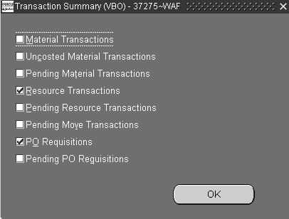

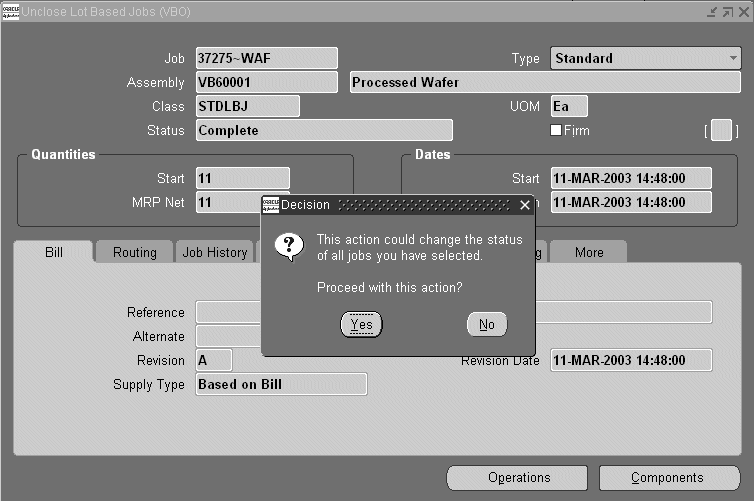

Select Unclose from the Tools menu.
A Decision window displays prompting you about proceeding with this action.
Choose Yes to unclose your job.

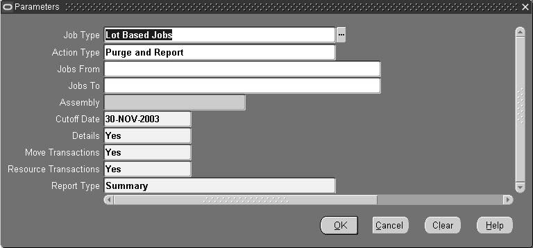

You can purge data related to move transactions of historical jobs based on specific parameters from a closed accounting period using the Purge Lot Based Jobs concurrent program. Genealogy links are preserved by retaining all header information for each job and WIP lot transactions such as split and merge.
Days Before Cutoff Date is a new parameter introduced for the OSFM purge request. This is used to limit Jobs selection. If specified it will consider jobs where 'Date Closed' is between (Cutoff Date-Days Before Cutoff Date) - Cutoff Date. If value for this parameter is not specified (null) then system will consider all jobs where Date Closed is less than or equal to Cutoff Date.
To purge lot based job transactions
Navigate to the Purge Lot Based Jobs Parameters window.
Job type defaults to Lot Based Jobs.
Enter the Action Type.
Enter the Jobs From and Jobs To fields to define a range of lot based jobs to purge.
Enter the Assembly.
Enter the Cutoff date for the closed inventory accounting period.
Purge Selection Criteria: Details, Move Transactions, Resource transactions default to Yes for purging.
Note: You cannot purge Lot based jobs header data (as header information is required for Lot Genealogy).
Enter the Report Type.
Choose OK. The Purge Lot Based Jobs window displays request details.
Choose Submit to run this request.
