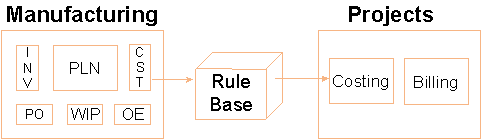

Task Auto Assignment - Schematic diagram

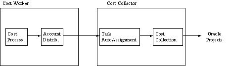

The following process diagram shows the Cost Collection flow of a transaction through the Cost Worker and Cost Collector.

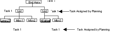

Consider a simple bill of material that is intended to be manufactured as a project.
Bill of Material for a Project Item

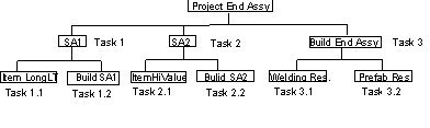

In order to achieve better cost control, it is identified that costs of items LongLT (a long lead time item) and item HiValue (expensive item) need to closely monitored. It is also necessary to track the costs of critical welding and prefabrication resources used in building the end assembly. In order to meet these objectives, a project work breakdown structure is prepared that tracks these costs under separate tasks. The work breakdown structure is shown in the figure above.
Proposed Project Work Breakdown Structure
Without the Task Auto Assignment feature, it would not be possible to support such a project work breakdown structure. This is because the task number for manufacturing activities (requisitions/purchase orders and WIP jobs) would have been either:
Suggested by the planning system
Manually entered
In either case, the procurement and assembly activities of all the component items would have the same task as their parent. As a consequence, all the material and resource costs would be bundled up under one task and it would not be possible to monitor the costs of critical items and resources used in the project.
Task Assignment Without Task Auto Assignment
For example, if Task 1 is assigned to the end assembly on a MDS (or MPS or Forecast), the same task would appear on all the transactions for items HiValue and LongLT and also on all the resource transactions required in building the end item.

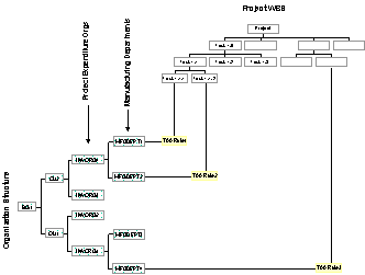

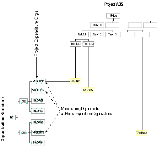

The following figures show two different approaches in which you could setup Project Work Breakdown Structure in relation to the Organization Breakdown Structure. Without Task Auto Assignment, such a link between Project Work Breakdown Structure and Organization Structure would not be possible for manufacturing departments.
Inventory Organizations as Project Expenditure Organizations
The figure above shows an example where Inventory Organizations (INVORG1, INVORG2, etc.) have been modeled as Project Expenditure Organizations.
These Expenditure Organizations have been referenced on the Manufacturing departments. For example, MFGDEPT1 and MFGDEPT2 have been assigned the same Project Expenditure Organization INVORG1. Task Auto Assignment rules (TAA Rule1, TAA Rule2, etc.) have been setup such that resource costs incurred in each of the manufacturing departments are collected under a separate task. The disadvantage of this approach is you loose visibility of manufacturing department level costs in a Project Expenditure Organization. i.e. Costs in Project Expenditure Organization INVORG1 commingles the resource costs for MFGDEPT1, and MFGDEPT2 along with other expenditures (including material costs) for INVORG1.
Another approach shown in the figure models manufacturing departments as individual Project Expenditure Organizations. Here each Manufacturing Department represents one Project Expenditure Organization and there is no commingling of costs.
Manufacturing departments as Project Expenditure Organizations

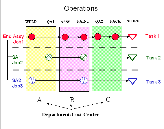

Collect resource costs for a particular job or assembly.
Another application of the Task Auto Assignment feature is seen in a case where you intend to monitor the resource usage for a particular assembly or a particular WIP job. You can assign a task assignment rule for this assembly or WIP job and can monitor the resource usage for that assembly or WIP job. If there is a need to control a specific resource for a job or an assembly, it can also be accomplished using Task Auto Assignment. You can associate only unreleased jobs with a resource task assignment rule.
