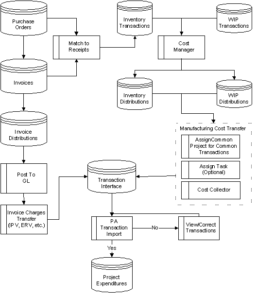

One of the primary capabilities of Oracle Project Manufacturing is the ability to accumulate manufacturing costs within manufacturing applications and transfer those costs to Oracle Projects.
This chapter discusses various topics related to project costing and billing in a manufacturing environment. The purpose of this chapter is to describe costing and billing issues as they relate to the combination of Oracle Project Manufacturing and Oracle Projects functionality.

You can recognize actual paid invoice cost for your purchased inventory items in Oracle Projects. You can transfer any difference between the AP invoice amount and the PO amount for project and common project inventory items to Oracle Projects.
Please see the Transfer Invoice Charges to Projects section of this chapter for more information.

Inventory, WIP, and invoice charges are processed by several programs before they are visible in Oracle Projects. Figure 6-1 shows the flow of transaction costing and cost collection. Each program is explained in detail in the next section.
Transaction Costing and Cost Collection Flow
This section discusses concurrent program like the cost manager and the cost collector.
The Cost Manager is a concurrent program you launch from the Inventory transaction Interface Manager window. It in turn launches the Cost Worker to cost inventory and WIP transactions.
The task for the Cost Worker is to create accounting distributions for the transactions.
You can transfer costs for project and common (no specific project) transactions to Oracle Projects. See the Set up chapter for a discussion on setting up a common project. A process picks up the Common Project value defined on the PJM Parameters window and assigns it to all transactions that have not been assigned a specific project number (common material related).
Oracle Project Manufacturing transfers inventory and WIP costs to Oracle Projects by using the Project Cost Transfers program. You specify the number of days to leave costs uncollected. When the batch job is submitted, both the inventory and WIP costs are transferred to Oracle Projects.
The Cost Collector collects the costs of project and common project transactions and passes these costs by project, task, expenditure type, expenditure organization, and expenditure date to the Transaction Import Interface table in Oracle Projects. These transactions can then be imported into Oracle Projects. The Cost Collector does not pick up transactions having the same project and task on both sides of the transaction, such as:
Issue of components from project inventory to a WIP job which has the same project and task as the inventory locator
WIP scrap transactions
WIP assembly completions
Shipment of items through Order Management
The Cost Collector processes (collects) transactions using Cost Collection Workers. Transactions that need to be collected and costed are grouped and a separate worker is assigned the job of collecting and costing transactions within a single group. A log file of all the validation and any SQL errors encountered while processing the transactions is maintained for each worker request. All program validation errors are updated in the transactions table.
Note: For more information on Cost Collector, see Oracle Cost Management User's Guide.

The following figure illustrates the types of transactions included in each transaction source. Note that the Inventory Misc transaction source is used for Inventory Integration with Projects (in a non-manufacturing installation). Miscellaneous Receipts and Miscellaneous Issues into or out of project inventory in Project Manufacturing are included in the Inventory transaction source.
Transaction Types Included with Each Transaction Source
Use the Run Requests window or choose Expenditures, Import from the Navigator window to submit the PRC: Transaction Import process. You must specify a transaction source when you submit this process.
Transaction Import has two output reports. The first allows you to review the number of successfully imported transactions, the second enables you to review transactions that were rejected by Transaction Import.
Note: For more information on Transaction Import, see Oracle Projects User's Guide.
