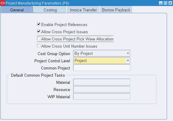

You must also set up the project manufacturing parameters. The following parameters govern the way transactions work and details out the implications it has in the project manufacturing-warehouse management enabled Organization.
Allow Cross Project Issues - This field governs the way allocation works in a project manufacturing organization. If the box is not checked, the system only allocates material from the same project and task as that on the sales order or WIP job/schedule. If the sales order or WIP job is common, only common material is allocated. This restriction exists regardless of the picking rules used. If the box is checked, material can be sourced from any project and task regardless of the project on the sales order or WIP job/schedule. However, this can be further restricted by warehouse management picking rules.
Allow Cross Unit Issues - This parameter is used when allocating serial numbers for an item that is under unit effectivity control. If the box is unchecked, the system only allocates serials with the same end item unit number as that specified on the sales order or WIP job/schedule. This restriction exists regardless of the picking rules that are used. Also, if the box is checked, the system allocates any serial number for the order based on the rules provided regardless of the end item unit number on the sales order.
Allow Cross Project Pickwave Allocation - This field governs the way Sales Order Pickwave Allocation works in a project manufacturing organization. If the box is not checked, the system only allocates material from the same project and task as that on the sales order. If the sales order is common, only common material is allocated. This restriction exists regardless of the picking rules used. If the box is checked, material can be sourced from any project and task regardless of the project on the sales order. However, this can be further restricted by warehouse management picking rules. The WMS Rule Engine will take precedence but the Allow Cross Project Pickwave Allocation check box has to be enabled for this kind of cross- project allocation.
Project Manufacturing Parameters
Project Manufacturing Parameters, Oracle Project Manufacturing User's Guide

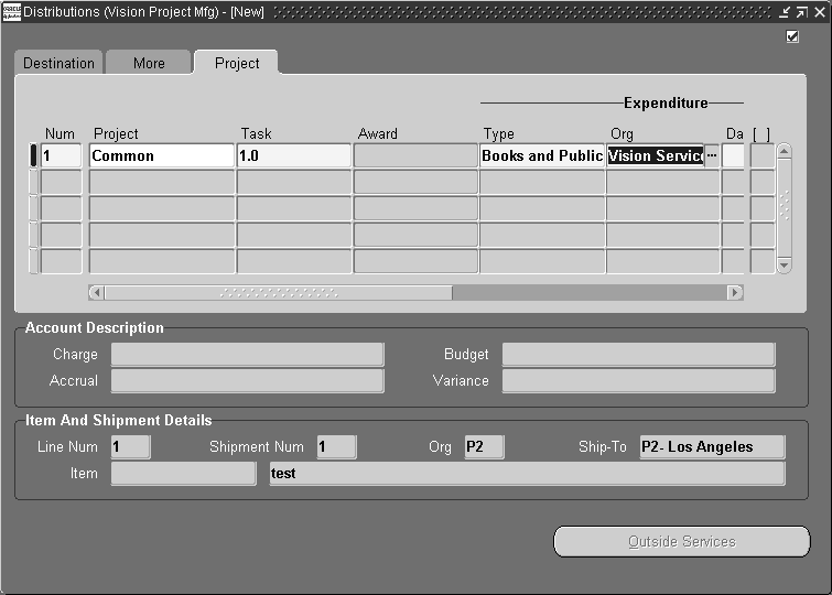

You enter purchase orders and returns on the desktop. Projects setup on the project manufacturing parameters in the receiving organization can be entered on the PO distribution lines. Distribution lines for project and non-project (common) material can be entered on the same PO.
When you perform the purchase order delivery transaction for a project purchase order, the system defaults the project and task from the distribution line of the purchase order to the receiving transaction. The project and task are displayed as separate fields in the mobile user interface.
If you combine shipment lines with Project and task references in the Purchase Order distributions with other Distributions without Project and task references for the various shipments, in the single purchase Order. In this case, if you want to receive material in a common locator, then you must select “No Project” in the project list of values on the mobile receiving page. In this way you can do an explicit receipt of material in a common locator and not in a project locator.
If the project/task is entered, then, receiving happens against the shipment/distribution with that specific project/task only.
During receiving the capacity utilization is always recognized against the physical Locator.
When you perform a Purchase Order Return/Correction transaction, the system defaults the project and task from the purchase order distribution line to from locator. If the you update the project and task segments of from locator on a purchase order return, they must match the project and task exactly on the purchase order Distribution line.
Note: You cannot use a project locator for all the above transactions if the purchase order distribution does not have project and task. If the Project and task references are not entered on the Purchase Order then you receive the material in a common locator.

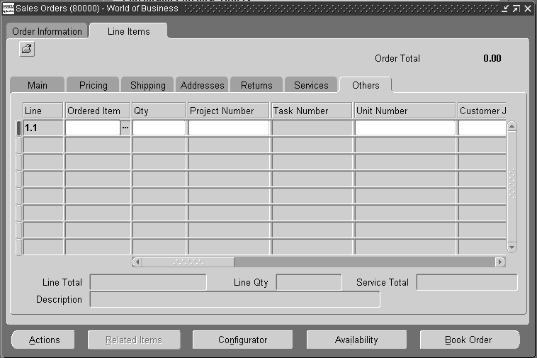

Sales Orders, RMAs, and Pick Release are entered on the Desktop. You can enable sales orders and RMAs for project and task by referencing the project and task information in the Sales Order Lines Others tabbed regions.

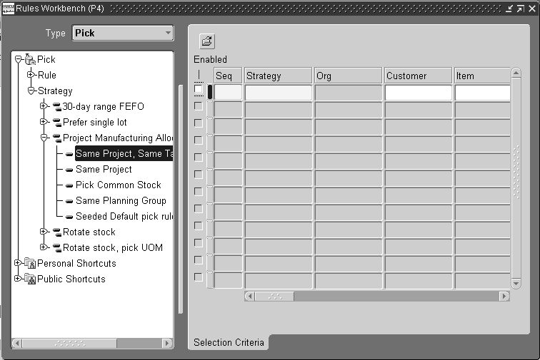

In a project manufacturing warehouse management enabled organization, there is a pre-seeded pick strategy defined/enabled for picking. You can define pick rules or modify and use the changed pre-seeded rules to suit their business needs Enable this pre-seeded strategy or setup their own business strategy in the Rules Workbench as part of the implementation. In the absence of a strategy, the system allocates any material for project and non-project sales orders. When you perform pick release for a project sales order, and the pre-seeded pick strategy is enabled, the system ensures that the user can only pick release from the project locators that have the same project and task as the sales order line. The project and /or task are non-editable fields on the pick load page.
Note: If you select the project manufacturing organization parameter Allow Cross Project Issue, and enable the pre-seeded strategy, the system allocates material based on the rules within the strategy
This strategy uses five seeded picking rules to model common requirements of a project manufacturing-warehouse management enabled organization. The strategy is automatically assigned to the organization when an organization is enabled for both warehouse management and project manufacturing. The strategy attempts to allocate first the most specific material for a particular project and task, gradually loosening the restrictions, finally allocating any material if necessary. It behaves as follows:

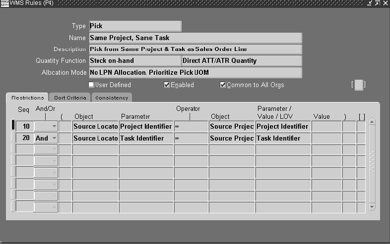

Allocate material from the same project and task

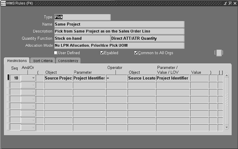

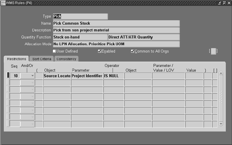

Allocate material that is not stocked for any particular project (Pick from the “Common” stock)
Allocate material from the same planning group
Allocate any material.
The last rules may be too generic for some organizations, but a copy of the strategy can be made, and then that copy modified by removing or modifying the last rule. The rules are defined as follows.
Strategy Project Manufacturing Allocation Preferences- Prefer same task, then project, then common, then planning group, and then anything.
This ensures that material that is for the same project and /or task as entered in the Sales Order are allocated.
| Object 1 | Parameter 1 | Operator | Object 2 | Parameter Value / LOV |
| Source Locator | Project Identifier | = | Source Project | Project Identifier |
| Source Locator | Task Identifier | = | Source Project | Task Identifier |
This ensures that material that is for the same project as entered in the Sales Order are allocated.
This ensures that the materials from the Common Locator are allocated. This is regardless of the project and task references on the Sales Order.
| Source Locator | Project Identifier | IS NULL | - | - |
This rule allocates material to the same planning group.
| Source Project | Planning Group | = | Project Stock on-hand | Planning Group |
This rule allocates any material.

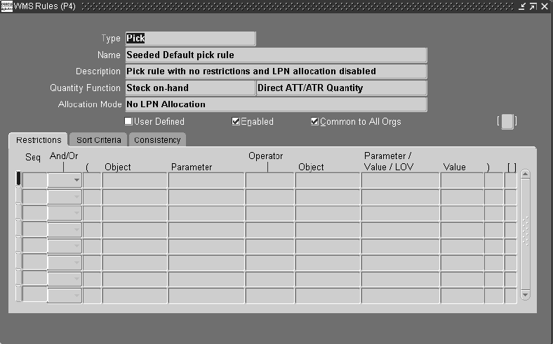

Moreover, you can setup pick rules using the rules engine containing source project, source project task and project stock on hand as objects to enforce business restrictions, for picking of material based upon of the project and task components and also onhand stock. If you set up rules disable the pre-seeded rules from the rules workbench.

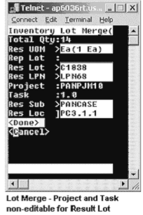

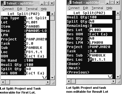

Lot Split functionality allows you to split a lot using a Mobile Device. For a project manufacturing organization, Project and Task fields are displayed on the start Lot and resultant lot windows. The resultant lot from lot split have same project and task as original lot and are not editable. project and task are editable for the first start lot only.
In the result page, the Project, Task, Sub-inventory and Locator fields are defaulted from the start lot page. The defaulted values can be changed for all except for the Project and Task fields.
In the start lot page, if LPN is entered, the project, task, sub-inventory, locator, on hand and available quantity be defaults from the LPN, but project and task fields are non-editable
If Start Project and Task fields are not entered, Result Project and Result Task fields do not display.
If there are any lot attributes for the item, Lot Attribute page is displayed after entering the Result Lot.
Lot Merge functionality allows you to merge lots using a mobile device. The Resultant Lot from Lot Merge have same project and task as Merged Lots and are not editable. Project and task are editable for the first start Lot only. With the project manufacturing integration, Project and Task field are displayed on the start and result windows. At least two or more lots can be merged into one resultant lot.
Lots can be merged only from the same project and task.
If for Start lot, Project and Task fields are not entered, Result Project and Result Task fields do not be display (Non-Project Lot Material)
If LPN is entered, the project, task, sub-inventory, locator, on hand and available quantity are defaulted from the LPN but, the result project and task are non-editable.
Project and Task fields are only editable for the start lot. The following lots defaults the values of Project and Task fields, from the start lot and Project and Task are non-editable.
If there are any lot attributes for the item, the Lot Attribute page displays after entering the Result Lot.
