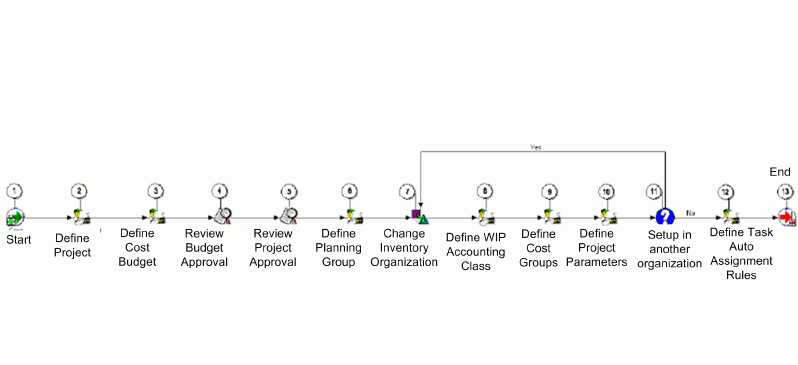

This step refers you back to Node 11 if additional organizations are desired for the project.
Message - Continue Setup in Another Inventory Org?
This step opens the Oracle Project Manufacturing form required to define the task Auto-Assignment rules.
Message - Define Task Auto-Assignment Rules
Respond Message Attributes -Form PJMFTAAR

Project Manufacturing Indirect Type Project Definition Process

The process contains 13 activities, each represented by a node on Figure B-2. The workflow begins at node 1.
The following is a description of each activity listed by the activity's display name.
This is a Standard function activity that marks the start of the process.
Function - WF_STANDARD.NOOP
Result Type - None
Required - Yes
Prerequisite activities - None
Item Attributes Set by Function - None
Item Attributes Retrieved by Function - None
This step opens the Oracle Project forms required to define a project.
Message - Define Project
Respond Message Attributes - Form PA_PAXPREPR_PROJECT
Send Message Attributes
This step opens the Oracle Project forms required to define the cost budget.
Message - Define Cost Budget
Respond Message Attributes -Form PA_PAXIBUEBU
This step opens the Oracle Project forms required to review budget status for a project.
Message - Review Budget Status
Respond Message Attributes - Form PA_PAXBUEBU
This step opens the Oracle Project forms required to review project approval.
Message - Review Project Status
Respond Message Attributes -Form PA_PAXPREPR_PROJECT
This step opens the Oracle Master Scheduling/MRP forms required to define a planning group.
Message - Define Planning Group
Respond Message Attributes -Form MRP_FNDLVMUL_PLANNING_GROUP
This step opens the Oracle Master Scheduling/MRP forms required to change the Inventory organization.
Message - Change Organization
Respond Message Attributes - Form MRPCHORG
This step opens the Oracle Work in Process forms required to define the WIP accounting class.
Message - Define WIP Accounting Class
Respond Message Attributes - Form WIP_WIPSUMCL
This step opens the Oracle Cost Management forms required to define the cost group.
Message - Define Cost Group
Respond Message Attributes - Form CST_CSTFDCGA
This step opens the Oracle Project Manufacturing form required to define the project parameters.
Message - Define Project Parameters
Respond Message Attributes - Form PJMFDPJP

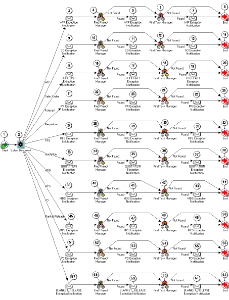

When you submit a Project Schedule Exception Notification request, Oracle Project Manufacturing uses Oracle Workflow technology in the background to handle the notification process. Oracle Workflow defines the approval notification options hierarchy available in the request parameters. You can use the Workflow Builder interface to modify your notification process.
The project manufacturing project schedule exception notification workflow consists of a single process, which is viewable in the Workflow Builder as a diagram. You can modify the objects and properties.
Processes can be customized using the Oracle Workflow Builder. When you customize the Project Manufacturing Project Schedule Exception Notification workflow, only those schedule exception notification requests that are submitted after you have customized it are affected. You can add or remove document types or alter the responsibilities to be notified for a given document type.
Choose Open from the File menu, and connect to the database.
Select Project Manufacturing Project Schedule Exception Notification to open it.
Expand the data source, then expand the item type project manufacturing Project Schedule Exception Notification.
Expand the Processes branch within the item type.
Double-click on the project manufacturing Integration Exception Process to the display the diagram in a process window.
Project Manufacturing Integration Exception Process Diagram
There are no required modifications for this workflow process.
You can customize the project manufacturing Integration Exception process by adding or deleting steps to the process, by changing process names and descriptions, and by changing step icons.
You might choose to customize this process by adding planners or buyers to the notification cycle.
Each type of customization is supported for the project manufacturing Integration Exception Process. However, the order of steps must take prerequisites for each form opened into account for the process to operate smoothly.
You can use the project manufacturing Integration Exception Process as a basis for developing your own project definition processes.
The Project Manufacturing Integration Exception process is associated with an item type called Project Manufacturing Project Schedule Notifications. All the available processes associated with the item type are listed under that item type in the Workflow Builder. Currently, the only available process for this item type is the Project Manufacturing Integration Exception process.

To view the properties of the Project Manufacturing Integration Exception Process, select the process in the navigation tree and choose Properties from the Edit menu. This process has a result type of None, indicating that when the process completes, it does not end with any particular result, such as End (Approved) or End (Rejected). Instead, its subprocesses end with specific results.
This process can be initiated as a top level process to run by making calls to the Workflow Engine CreateProcess and StartProcess APIs.
The process contains 62 activities, each represented by a node on Figure B-3. The workflow begins at node 1.
At node 2, this workflow branches depending on whether the document is a WIP, SO, Forecast, PR, RFQ, quotation, MDS, MPS, purchase order, or blanket release exception notification. If a choice is not made, the process is initiated for all options.
At nodes 3, 9, 15, 21, 27, 33, 39, 45, 51, and 57 the workflow notifies the requestor. locates the appropriate project manager for notification.
At nodes 4, 10, 16, 22, 28, 34, 40, 46, 52, and 58 the workflow locates the appropriate project manager for notification.
At nodes 5, 11, 17, 23, 29, 35, 41, 47, 53, and 59 the workflow sends notification to the appropriate project manager.
At nodes 6, 12, 17, 24, 30, 36, 42, 48, 54, and 60 the workflow locates the appropriate task manager for notification.
At nodes 7, 13, 18, 25, 31, 37, 43, 49, 55, and 61 the workflow sends notification to the appropriate task manager.
The following is a description of each activity listed by the activity's display name. You can create all the components for an activity in the graphical Workflow Builder except for the PL/SQL stored procedures that the function activities call. All function activities execute PL/SQL stored procedures which you must create and store in the Oracle RDBMS. The naming convention for the PL/SQL stored procedures is:
<PACKAGE>.<PROCEDURE>
<PACKAGE> is the name of the package that groups all of the procedures. <PROCEDURE> represents the name of the procedure.
To view the package and procedure names used by the Project Manufacturing Integration Exception process, view the Properties page for each function activity. For example, the function activity Find Project Manager uses the <PACKAGE>.<PROCEDURE> name pjm_integration_proj_mfg.PJM_WF_SEEK_PROJECT_MGR.
This is a Standard function activity that simply marks the start of the process.
This function activity determines the document type: WIP, SO, Forecast, PR, RFQ, quotation, MDS, MPS, purchase order, or blanket release exception notification.
This activity sends schedule exception notification to the requestor.
This activity locates the appropriate project manager(s) for notification.
This activity sends schedule exception notification to the project manager(s).
This activity locates the appropriate task manager(s) for notification.
This activity sends schedule exception notification to the task manager(s).
