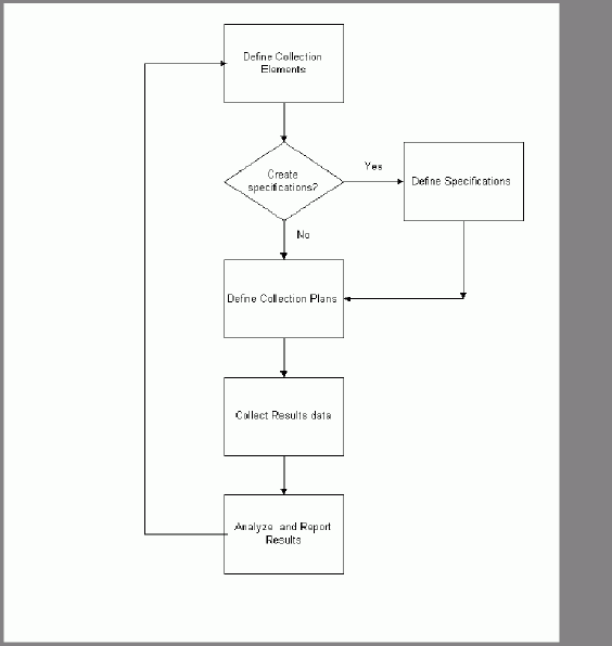

The following diagram illustrates the quality process flow.
The following paragraphs describe each of the above steps in using Oracle Quality. The following example illustrates each step in the process.
