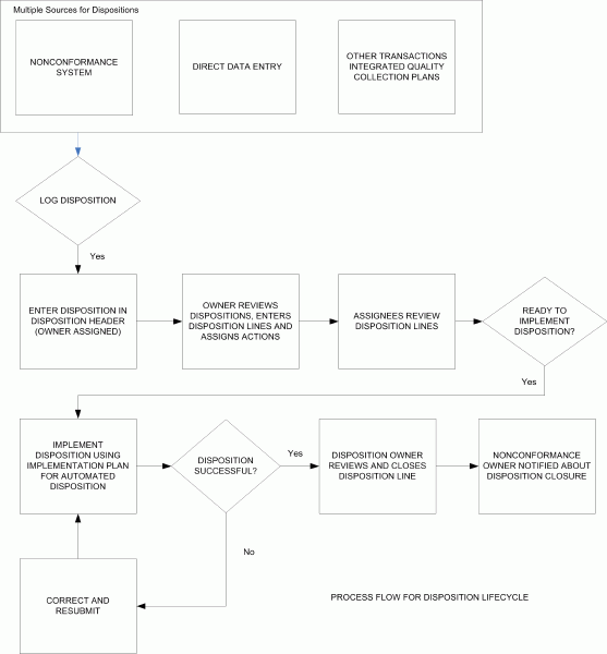

The following process flow illustrates the various steps in the disposition lifecycle including initiating a disposition, assigning it to specific individuals for action, and its final resolution.
Process Flow for Disposition Lifecycle
Depending on the configuration chosen, the disposition tracking and execution system can exist independently or linked to the nonconformance tracking system. The disposition set of collection plans can be initiated via direct data entry or transaction association. See: Setup Steps for information on linking collection plans and associating them with transactions.
When the decision has been made to log a disposition, the disposition header plan is invoked; you are required to enter the disposition source. If you navigated to the disposition header from the nonconformance system, the nonconformance number and associated information is copied to the disposition header.
Rules can be set up to assign an owner to the disposition, based on the disposition source. If you set Default Values to YES, some elements are defaulted from the nonconformance master. Set Default Values to YES only when a nonconformance set of plans are associated with the disposition system.
The details on the disposition header include the disposition source, source reference identifier, item, disposition owner, the source owner, and respective e-mail addresses. Background actions automatically update Date Opened, Date Closed, and Days to Close.
When the disposition is logged, an e-mail or workflow notification is sent to the disposition owner and the source (nonconformance) owner.
After the disposition owner is notified about the disposition, the disposition uses the View Disposition and Update Disposition menu options within Oracle Quality to view and/or update the disposition.
The disposition owner reviews the disposition and other associated information such as nonconformance information, to understand the material disposition history. The owner makes the determination of what disposition and disposition actions need to be executed.

Because each disposition can be executed by different people with different job functions, the owner assigns the disposition execution, using the Action Assigned to or Implementation By collection elements.
When the disposition action assignees and implementors receive an e-mail or workflow notification, they review the disposition actions to implement within the disposition details collection plan. The implementor may update the information on the disposition line to make any corrections to the current location or the condition of material to be dispositioned.
The implementation collection plans are primarily used to execute the automated disposition actions. If the disposition involves no automated execution, the implementor can update the disposition detail line with the disposition implementation.
When the implementor is ready to implement the automated disposition action, the disposition action value determines the WIP or Inventory disposition collection plan.
After navigating to the implementation plan, the implementor can use Default Values to default information from the nonconformance master, as discussed earlier. When ready to execute the disposition action, the implementor will update the Launch Action collection element to YES, after entering the necessary collection elements for disposition execution. See: Appendix E -Collection Plans for information on the collection elements that need to be entered for each of the disposition actions.

The automated disposition actions are processed when initiated from the disposition implementation collection plans. If the disposition implementation action initiated from the collection plan fails, manual intervention is required. The implementor would need to manually correct the transaction in the respective destination module, then resubmit the transaction. After the submitted transaction succeeds, the implementor should manually update the disposition status to SUCCESS, and notify the appropriate personnel.

The disposition owner reviews the disposition lines and, if they have successfully been implemented, closes the disposition lines. The disposition is closed when all lines are closed. The nonconformance owner and other personnel are notified via e-mail or workflow notification.
