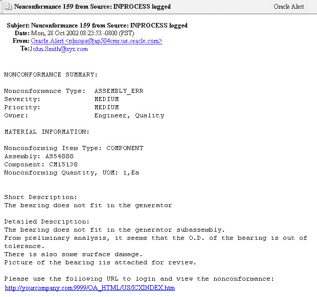

You can modify all e-mail notification message text, according to your business conventions. For example, you can include the Personal Home Page URL of Oracle Applications. Recipients of the e-mail are then easily directed to Oracle Applications, enabling ease in Nonconformance and Disposition response.
To tailor e-mail notifications:
(N) Quality: Setup > Collection Plan
Perform a query on the collection plan associated with the notification needing modification.
Select the Send Email element.
Choose Action.
Select the Send an electronic email notification action, then choose Action Details.
The Text area contains the notification's message text.
E-mail Alert with Oracle Applications' URL

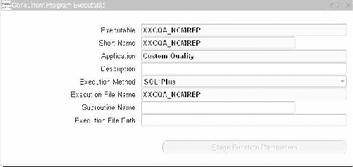

Navigate to the Concurrent Program Executable window (N) System Administrator: Concurrent > Program > Executable. Define an executable with SQL *Plus program style.
Define Concurrent Program Executable
(N) System Administrator: Concurrent > Program > Define. Define a program, Material Review Report. For example, use the above executable.

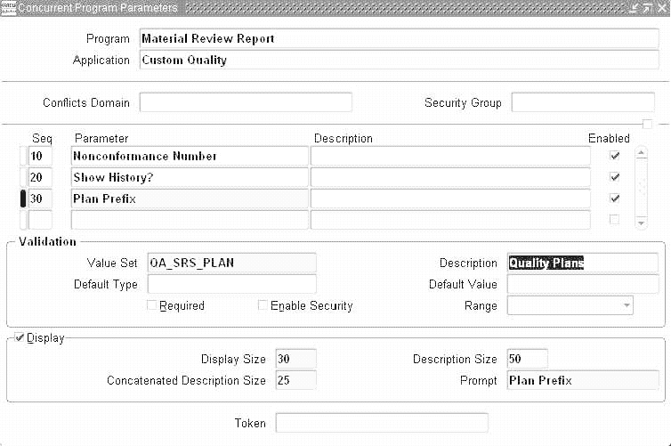

Choose Parameters. Enter three parameters in the following order:
| Parameter | Value Set | Corresponding Parameter in Sample SQL |
| Nonconformance Number | QA_SRS_PLAN | &1 |
| Show History? | QA_SRS_YES_NO_ID | &2 |
| Plan Prefix | QA_SRS_PLAN | &3 |
The value sets are predefined and used for validation of parameter values.
Concurrent Program Definition
Concurrent Program Parameters Definition

Within the Manufacturing and Distribution Superuser responsibility, navigate to the Submit Request window (N) Quality: Reports > Submit Request.
Select Material Review Report from the Name list of values (or any name that you created while setting up), and submit the process.
