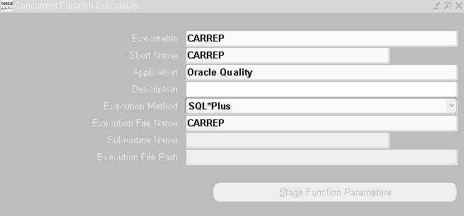

  2. Navigate to the Concurrent Program Executable window (N) System Administrator: Concurrent > Program > Executable. Define an executable with SQL *Plus program style.
    Define Concurrent Program Executable
    the picture is described in the document text

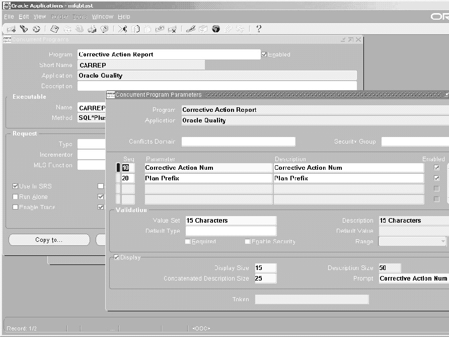

  3. (N) System Administrator: Concurrent > Program > Define. Define a process, Corrective Action Report. For example, use the above executable.
  4. Choose Parameters. Enter three parameters in the following order:
    Parameter Value Set Corresponding Parameter in QACAR.sql
    Corrective Action Num QA_SRS_PLAN &1
    Plan Prefix QA_SRS_PLAN &2
    The value sets are predefined and used for validation of parameter values.
    Concurrent Program Definition
