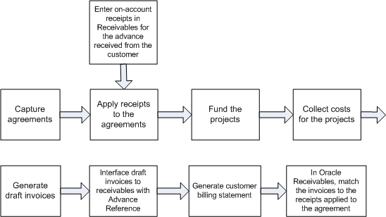

The following illustration shows a typical process flow for a project that requires an agreement with advance payments.
In the process flow shown above, the following activities take place:
The agency receives appropriations or a reimbursable order.
The project manager does the following:
Enters an agreement with advance payments required
In Oracle Receivables, enters receipts for the advance received from the customer
Defines the corresponding project (or projects) and work breakdown structure
Funds the project, applies receipt to the agreement, and defines cost budget for the project
Defines a revenue budget in order to generate revenue and invoices for the project
Project team members do the following:
As expenditures are made on the project, enter expenditure items.
Distributes costs and interface the cost transactions to General Ledger
Generate draft invoices and interface invoice transactions to Receivables
Generate customer billing statements
In Oracle Receivables, match the invoices to the receipts that were applied to the agreement
