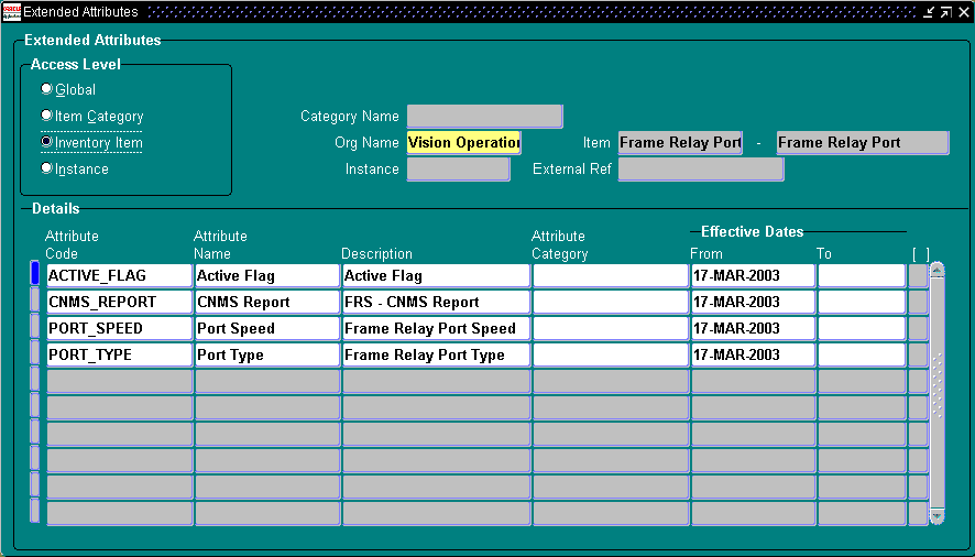

In this procedure, log in to Oracle Forms with Oracle Installed Base Admin responsibility and navigate to Setups, Extended Attribute Template. Map extended attributes or other attributes (lookups) available in the CSI_EXTEND_ATTRIB_POOL to the Service Fulfillment Items. As a prerequisite, you must have defined the item and extended attributes.
The following figure shows the extended attribute and its details of an inventory item.
Extended Attribute and Details of an Inventory Item
