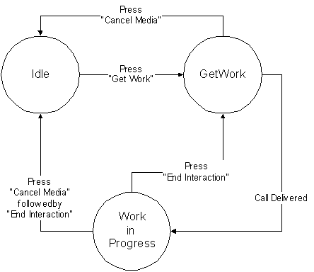

When an agent logs in to Oracle Universal Work Queue, the agent is put into an Idle state in which the agent receives only unsolicited calls, such as directly transferred calls. The agent can change from the Idle state to the Get Work state by selecting Get Work. In the Get Work state, the agent is available for the next work item, and remains in this state until receiving a work item, such as an inbound call. When the agent receives the call, the state is changed to Work in Progress. The Work in Progress state is similar to Idle in that the agent receives only unsolicited work. From the Work in Progress state, the agent can either change to Idle by first using Cancel Media and then End Interaction, or change to the Get Work state by using End Interaction. While in the Get Work state, if the agent completes the state change before receiving a work item, then the agent can change to Idle by using Cancel Media.
the picture is described in the document text
