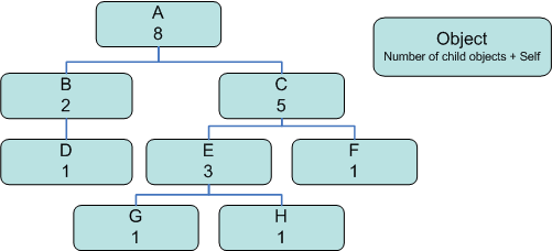

OIC Analytics for ODI uses column flattening to flatten out data copied from OIC source tables into the target hierarchical datamart tables. The resource and product entities in the datamart tables are column flattened. In this technique, one record exists per chain of hierarchy.
The following is an example of source hierarchical relationship.
The hierarchical structure represented above depicts the entities in the source.
The following table lists the data structured in a manner that reflects datamart, in a column flattened hierarchy:
| Level 1 | Level 2 | Level 3 | Level 4 | Leaf |
| A | A | |||
| A | B | B | ||
| A | B | D | D | |
| A | C | C | ||
| A | C | E | E | |
| A | A | F | F | |
| A | C | E | G | G |
| A | C | E | H | H |
