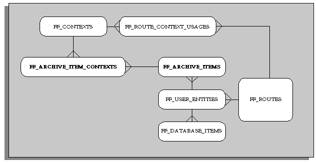

The entity relationship diagram below shows the relationship of the PAR tables to other tables in generic HRMS:
The FF_ARCHIVE_ITEMS table records a snapshot of what particular database items evaluate to on a run of PAR.
The creation of archive database items includes the creation of archive routes. You define these in FF_ROUTES, with definition texts that are simple select statements from the two tables FF_ARCHIVE_ITEM_CONTEXTS and FF_ARCHIVE_ITEMS. Notice however that you must define these based on the number of contexts being passed into the routes, and the data type of the contexts. There are however, seeded Archive Routes, which you may be able to make use of rather than defining your own; these are detailed in the next section.
You define the route context usages in the table FF_ROUTE_CONTEXT_USAGES. The recommended way to do this is to retrieve from FF_CONTEXTS the context IDs that the live and archive routes require, and then define new route context usages based on the new archive routes. The route parameter is always defined based on the new archive route and a parameter name of User Entity ID.
Here is an example of a more complex archive route:
