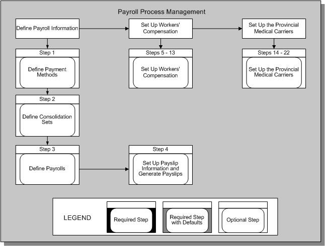

 < Payroll Process Management (Optional)
Includes payrolls, payment methods, and payslip information. For Canada, also includes Workers' Compensation, and provincial medical.

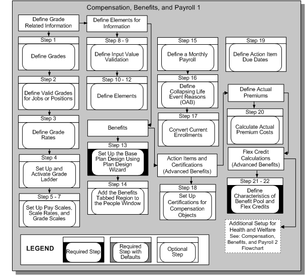

 < Compensation, Benefits, and Payroll (Optional)
Includes grades, grade related pay, benefits eligibility, life events, compensation objects, enrollment requirements, activity rates, elements, salary administration, leave and absence management, element sets, rate by criteria, and additional setup for payroll processing and health and welfare.

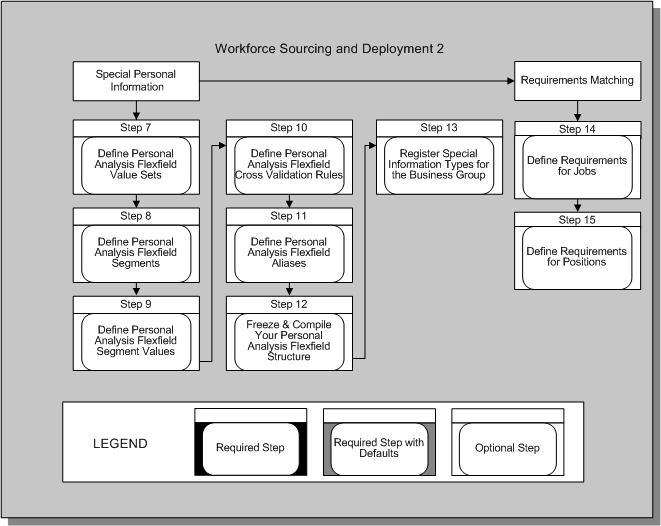

 < Workforce Sourcing and Deployment (Required)
Includes recruitment, assignment statuses, contract statuses, assignment rate types for contingent workers, special personal information, global deployments, and requirements matching.

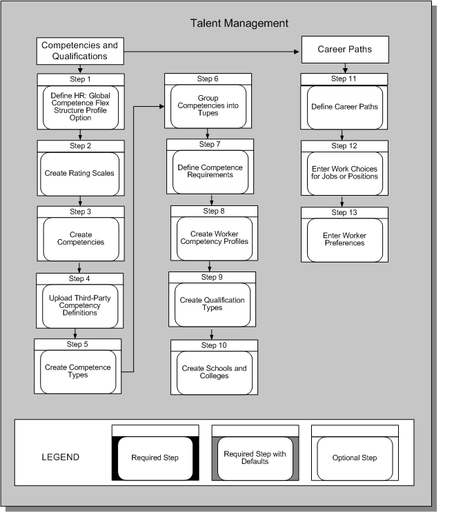

 < Talent Management (Optional)
Includes competencies, objectives (Workforce Performance Management), qualifications, and appraisals.

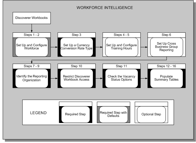

 < Workforce Intelligence (Optional)
Includes predefined Discoverer workbooks and a predefined Discoverer End User Layer based on HRMS transactional tables.

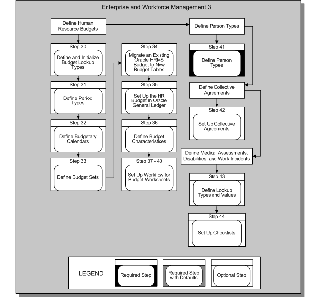

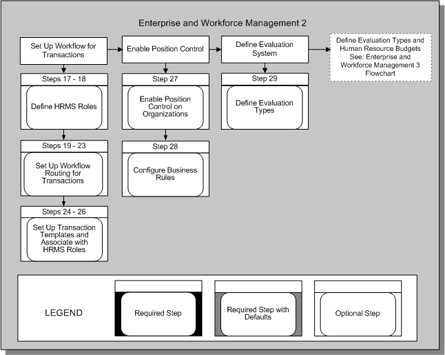

Enterprise and Workforce Management 1
Enterprise and Workforce Management 2
Enterprise and Workforce Management 3
Compensation, Benefits, and Payroll 1
Compensation, Benefits, and Payroll 2
Compensation, Benefits, and Payroll 3

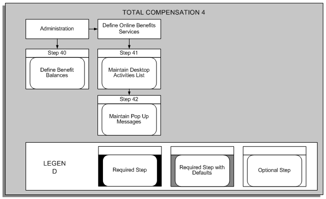

Total Compensation 1
Total Compensation 2
Total Compensation 3
Total Compensation 4
Workforce Sourcing and Deployment 1
Workforce Sourcing and Deployment 2
Talent Management

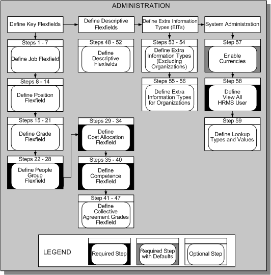

Job
Position
Grade
People Group
Cost Allocation
Competence

Before you begin your implementation of these key flexfields you must clearly specify your requirements. This specification must include the following details for each key flexfield:
The Structure Name and the number of Segments
The Flexfield Segment Names, Order, Validation Options, and Qualifiers
The Flexfield Value Sets and any lists of values
After you have completed the definition of a key flexfield, you need to run the Create Key Flexfield Database Items process concurrent process to generate Database Items for the individual segments of the Flexfield. This applies to your Job, Position, Grade, Competence, and People Group Key Flexfields only.
Important: If you used the Configuration Workbench, you have already defined the structures for your Job, Position, and Grade key flexfields. You may want to add more validation, such as cross-validation. The Workbench created default structures for the other flexfields associated with a business group (People Group, Cost Allocation, and Competence). If you plan to use these flexfields in your implementation, you must update the default structures to display the segments you require.

The Collective Agreement Grades Key Flexfield records information about how an employee is graded or ranked in a collective agreement. The Collective Agreement Grades Key Flexfield enables you to specify any number of structures. Each grade structure is defined as a separate structure of the flexfield. You then link a specific structure to a collective agreement in the Agreement Grades window.
It is not mandatory to define your collective agreement grades key flexfield now. You can do it after you have defined your business groups.
Warning: If you are using the Italian legislation, do not create new structures for the Collective Agreement Grades Key Flexfield. You must use the predefined structure, IT_ CAGR and must not make changes to it.
After you have specified your requirements for recording and reporting agreement grade information, follow this implementation sequence:
You need to design a Collective Agreement Grades Flexfield Structure for each Grade Structure you want the application to hold. For each structure you must include the following:
The Structure Title (the Grade Structure) and the number of Segments.
The Flexfield Segment Names (the Grade Factors), Order, and Validation Options.
The Flexfield Value Sets and any lists of values.
Note: Your system administrator performs this step.
To validate the values that a user can enter for any segment, you must define a specific Value Set.
The attributes of the Value Set control the type of values that can be entered, and how many characters each segment can hold. The attributes of the Value Set also control how the values are to be validated.
Value Sets can be shared by different segments of the same flexfield, or by segments of any other flexfield.
Use the Value Set window.
See: Defining Value Sets, Oracle E-Business Suite Flexfields Guide
Define a structure for your Collective Agreement Grades Flexfield that contains the segments you want to use. You use this structure to create your Reference Grades in the Define Agreement Grades window.
You must enter Yes in the Allow Dynamic Inserts field. If you enter No, you cannot enter new details in the Define Agreement Grades window.
When you access the grades in the Assignment window they display in the numerical order defined in the Number column of the Segments Summary window.
Note: You do not need to use a Value Set to validate a segment. If you do not specify a Value Set then a user can enter any alphanumeric value up to a limit of 150 characters.
Use the Key Flexfield Segments window.
See: Defining Key Flexfield Structures, Oracle E-Business Suite Flexfields Guide
If you have chosen Independent or Dependent validation for a Value Set used by a Collective Agreement Grades Flexfield Segment, you must define your list of valid values for the Value Set.
Use the Segment Values window.
See: Defining Segment Values, Oracle E-Business Suite Flexfields Guide
Define any Cross-Validation Rules you want to use to control the combinations of segment values a user can enter.
You define Rules to Include or Exclude combinations of segment values. For each segment, you can define a Low to High range of values.
Use the Cross-Validation Rule window.
See: Defining Cross-Validation Rules, Oracle E-Business Suite Flexfields Guide
Define Aliases for common combinations of segment values if you want to provide these as default options.
Use the Define Shorthand Aliases window.
See: Defining Shorthand Aliases, Oracle E-Business Suite Flexfields Guide
You are now ready to freeze your Collective Agreement Grades Flexfield definition. Navigate to the Define Key Flexfield Segments window. Enter Yes in the Freeze Flexfield Definition field and save your changes. The application now freezes and compiles your Collective Agreement Grades Flexfield definition. Compiling the flexfield definition enables the flexfield window with the defaults, values, and rules that you have defined.
Use descriptive flexfields in Oracle HRMS to define your own additional fields to the standard windows. For example, if you want to record Driver's License Number for any person you can define a segment of the Additional Personal Details flexfield to record this additional information.
After this, you can enter a Driver's License Number in the Person window after the standard Personal details.
Note: Because the descriptive flexfield is defined at the level of the base-table, any window using the base-table displays the same descriptive flexfield segments. In this example, the Driver's License Number appears in the Contact window as well as the Person window.
Before you begin to implement any descriptive flexfield you must clearly specify your requirements. You must include the following details:
The Context and the number of Segments for each Context
The Flexfield Segment Names, Order and Validation Options
You can define two types of descriptive flexfield Segments:
Global Segments
Segments always appear in the flexfield window.
Context-Sensitive Segments
Segments appear only when a defined context exists. You can prompt a user to enter the context, or you can provide the context automatically from a reference field in the same region.
Note: Often you can choose between using a code, a "base-table" field, and a field that contains a meaning or description. You should always use base-table fields as reference fields for Context-Sensitive segments. These fields usually have the same name as the column in the base table.
Some of the Standard Reports supplied with the system include descriptive segment values. If you follow this suggestion, these reports will be able to use the prompts you define - otherwise they will apply a generic prompt to the data.
Note: If you want to include descriptive flexfield Segment Values in the Lookups list for DateTrack History, you need to modify the DateTrack History Views supplied in the application.
You must use the Application Developer Responsibility to update the definition of the descriptive flexfield. From the Descriptive Flexfields window, navigate to the Reference Fields block and enter the name of the Reference Field you want to use.
Warning: Some descriptive flexfields are predefined and protected. These are used to deal with specific legislative and reporting needs of individual countries or industries.
Do not attempt to alter the definitions of these protected flexfields. These definitions are a fundamental part of Oracle HRMS. Any change to them may lead to errors in the operating of the application.
Oracle HRMS may use other segments of these flexfields in the future. Therefore, do not add segments to any protected flexfield. This can impair your ability to upgrade your system.
Use the Descriptive Flexfields window.
If you want to validate the values a user can enter for any segment you must define a specific Value Set.
Note: Value Sets can be shared by different segments of the same flexfield, or by segments of any other flexfield.
Define the segments of your descriptive flexfield for each Context.
Use Global Context to define any segments always appear in the flexfield window.
Enter your own Context Name to define segments which will appear only for that context.
Freeze and compile your descriptive flexfield definitions.
Warning: Any segment you define as "Required" is required for every record on the system. You can encounter two common problems:
If you define a "Required" segment after you have entered records: Existing records lack a value in this segment, causing the application to error when you query an existing record.
Some descriptive flexfields are used in more than one block. For example, any "Required" segments for Additional Personal Details must be entered for every Employee, Contingent Worker, Applicant, or Contact.
Use the Descriptive Flexfield Segments window.
See: Defining Descriptive Flexfield Structures, Oracle E-Business Suite Flexfields Guide
If you have chosen Independent validation for a Value Set used by a descriptive flexfield Segment, you must define a list of valid values for the Value Set.
Use the Define Segment Values window.
When you have defined your descriptive flexfields you should run the Create Descriptive Flexfields Database Items process to create database items for your non-context-sensitive descriptive flexfield segments.
You should rerun this process whenever you create additional non-context-sensitive descriptive flexfield segments.
Note: If you require Database Items for Context Sensitive flexfield segments you should consult your Oracle Support Representative for full details of how to add other Database Items.
Use the Submit a New Request window
See: Running Reports and Programs, Oracle E-Business Suite User's Guide
Extra Information Types are a type of descriptive flexfield that let you add an unlimited number of information types to six of the most important entities in Oracle HRMS.
For example, you might want to use the EIT on Assignment to hold information about project work within an assignment.
Note: With Organizations you can group the EITs by classification so that when a user selects a classification they see the EITs associated with the classification. You must undertake some additional steps to implement EITs for an Organization.
Once you have decided which extra information types you require, you need to select the descriptive flexfield by title. Create a new record in the Context Field Values region and enter the name of your new Information Type in the Code field. Enter the segment values and compile the descriptive flexfield.
See: Setting up Extra Information Types (Excluding Organization EITs), Oracle HRMS Configuring, Reporting, and System Administration Guide
EITs do not appear automatically in any responsibility. You must set up responsibility-level access for EITs. Alternatively, use CustomForm security to add individual EITs to a specific taskflow window. This level of security is usually defined later in the implementation when you need to restrict user access.
Note: This security does not apply to EITs on organizations.
Use the Information Types Security window.
See: Setting Up Extra Information Types against a Responsibility, Oracle HRMS Configuring, Reporting, and System Administration Guide.
EITs for organization classifications are set up differently from other EITs. When you define them you must also associate them with the classification of the organization. When a user selects the classification then the application displays the correct set of EITs.
Define a new organization classification if you want to group your EITs in this way. You do not need to do so if you intend to use an existing classification.
Tip: When you install Oracle HRMS you will find a predefined list of Organization Classifications. These values are defined for the Lookup Type ORG_CLASS, and provide options for all users of the Organization window.
You can disable the Lookup values you will not use in your implementation in the Application Utilities Lookups window.
Use the Application Utilities Lookups window.
See: Adding Lookup Types and Values, Oracle HRMS Configuring, Reporting, and System Administration Guide
Define a new EIT and then enter a row into the HR_ORG_INFORMATION TYPES table. Then specify for which organization classifications this EIT is available.
See: Setting Up Extra Information Types for an Organization Classification, Oracle HRMS Configuring, Reporting, and System Administration Guide

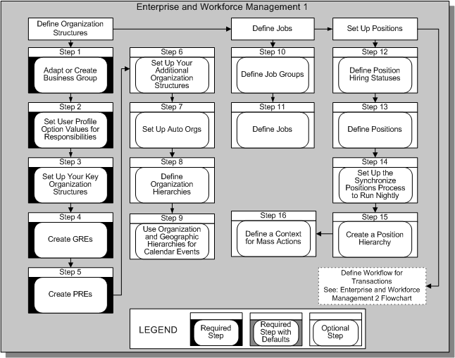

To begin modelling your enterprise, you set up the business groups, legal entities, and operating companies that comprise your organizational framework. You can define these organizations and locations yourself, or complete a configuration interview in the Configuration Workbench. The workbench creates the organizations and locations and places them in a hierarchy for you. The workbench creates a "View All" responsibility for each business group, and sets the required user profile options.
When the organizational framework is in place, you can extend it by creating additional internal and external organizations, and their locations, and by building the organizations into hierarchies.
If you use the Configuration Workbench, then you can skip steps 1, 2, and 3, although you can optionally perform step 2 to add user profile options to the responsibilities that the workbench creates. If you do not use the Configuration Workbench, then follow the steps below to configure your enterprise framework.
To find out what organization structures the workbench sets up see: Key Concepts for Representing Enterprises, Oracle HRMS Enterprise and Workforce Management Guide
You can use the Startup business group with all of its default definitions, which you can use with the default responsibility (Option 1), or you can define other business groups to meet your own needs (Option 2).
To find out how many business groups you require, see: Key Concepts for Representing Enterprises
Option 1: Adapt the Startup Business Group
Select the default Oracle Human Resources responsibility with the security group 'Standard'. This enables you to see all the records for the startup Business Group.
Adapt the startup Business Group to your own Business Group requirements.
Warning: The Setup business group has a default legislation code of US and a default base currency of USD.
If you intend to process payrolls in your business group, or you intend to implement legislation for another territory, you must create a new business group with a valid legislation code and base currency. The system uses these values to copy in the predefined data it needs to comply with local legislative and processing requirements.
You cannot change these definitions after they have been saved.
See: Creating an Organization, Oracle HRMS Enterprise and Workforce Management Guide
Option 2: Create New Business Groups and Responsibilities
Create a new Business Group.
Set up a responsibility for the business group in the Responsibilities window.
Note: Use Standard HRMS security, rather than the Security Groups Enabled model during implementation. You can change to the Security Groups Enabled model later in your implementation. See: Security Models, Oracle HRMS Configuring, Reporting, and System Administration Guide
Set the HR User Profile Options for any new responsibilities you create. You must set up the HR: User Type, HR: Security Profile and the HR: Business Group options, at responsibility level.
You can set also set up other User Profile Options for new responsibilities you created or the workbench generated.
See: System Profile Values Window, Oracle Applications System Administrator's Guide
See: User Profiles, Oracle HRMS Configuring, Reporting, and System Administration Guide
Create the legal entities and operating companies you require to represent your enterprise. The operating companies and legal entities are key organization structures that form your basic enterprise framework, to find out what they represent, see: Key Concepts for Representing Enterprises, Oracle HRMS Enterprise and Workforce Management Guide
To find out how many operating companies and legal entities you require, see: Configuration Models for Your Enterprise Framework
See: Setting up Organizations, Oracle HRMS Enterprise and Workforce Management Guide
Create the necessary GREs, including setup for:
Entering Employer Identification Information for a GRE, Oracle HRMS Enterprise and Workforce Management Guide
Entering North American Industrial Classification (NAIC) codes for a GRE, Oracle HRMS Enterprise and Workforce Management Guide
Entering Federal Magnetic Reporting Information for a GRE, Oracle HRMS Enterprise and Workforce Management Guide (for use with employers that submit year end information electronically)
Entering Provincial Reporting Information for a GRE, Oracle HRMS Enterprise and Workforce Management Guide (for use with Oracle Payroll)
For organizations operating in Quebec, you need to create the appropriate PREs. This includes the following setup steps:
Entering Information for a PRE, Oracle HRMS Enterprise and Workforce Management Guide
You can extend your basic enterprise structure by creating additional organizations and locations to represent internal divisions or departments, and external organizations for reporting or third-party payments.
See: Extending the Enterprise Framework, Oracle HRMS Enterprise and Workforce Management Guide
See: Setting Up Organizations, Oracle HRMS Enterprise and Workforce Management Guide
The Configuration Workbench creates legal entities for HR purposes only. If you want to integrate Oracle Payroll with Oracle Cash Management, see: Oracle Cash Management User Guide
You can enable the automatic creation of HR organizations using the Auto Orgs functionality. If your enterprise has a close relationship between its financial structure and line management hierarchy, then this means you only have to maintain your financial structure in GL and the corresponding line manager hierarchy is automatically synchronized.
See: Implementing Automatic Company Cost Center Creation, Oracle HRMS Enterprise and Workforce Management Guide
For further information on setting up multiple organizations, see: Oracle Applications Multiple Organizations Implementation Guide
You can represent your management or other reporting structures by arranging organizations into reporting hierarchies. An organization can belong to any number of hierarchies, but it can only appear once in any hierarchy.
Organization reporting lines change often and you can generate a new version of a hierarchy at any time with start and end dates. In this way, you can keep the history of your organizational changes, and you can also use this feature to help you plan future changes.
When you use DateTrack you see the "current" hierarchy for your effective date.
Important: Your primary reporting hierarchy will usually show your current management reporting structure. You can define other hierarchies for other reporting needs.
You can create organization hierarchies using the:
Organization Hierarchy Window
See: Creating Organization Hierarchies, Oracle HRMS Enterprise and Workforce Management Guide
Organization Hierarchy Diagrammers (they enable you to create your hierarchies graphically, and to make intuitive drag-and-drop changes)
See: Adding Organizations or Positions to a Hierarchy, Oracle HRMS Enterprise and Workforce Management Guide
You use geographical and organizational hierarchies to identify the group of people you want a calendar event to apply. Calendar events represent important dates that affect the working time of your workforce such as a public holiday.
See: Setting Up Calendar Events, Oracle HRMS Workforce Sourcing, Deployment, and Talent Management Guide
You can use organizational hierarchies when you define calendar events in your enterprise. If the calendar event applies to people in your organizations, you can select an organization hierarchy as the type of coverage for the event. For example, if you have a planned factory closure, you can define it as an organizational holiday and apply it to the factory organization in your hierarchy. The calendar event becomes applicable to the people in the factory organization who are scheduled to work at the time of the event.
You use the geographical hierarchy as the type of coverage for calendar events that apply to a geographic entity, such as, a country, state, or region. For example, if you are an enterprise operating in multiple countries, you can define calendar events for the public holidays in those countries. The calendar event becomes applicable to people if they work in the country you include in the event.
See: Generic Hierarchies Overview, Oracle HRMS Enterprise and Workforce Management Guide
If you used the Configuration Workbench, you may already have loaded jobs from a spreadsheet in the Workbench. You can skip the Define Jobs step.
As part of a working relationship, a person can simultaneously perform a number of roles in addition to being an employee or contingent worker. These can range from initiatives defined by the enterprise, such as fire warden, to legislative defined roles such as Health and Safety Representative. In Oracle HRMS, these are know as supplementary roles. Supplementary roles are set up as jobs in the Job window.
Each job is held in a Job Group. The Job Group is used to store jobs of a similar type together in one group. All standard jobs created in Oracle HRMS, that is, those jobs that define the role the person is employed to fulfil, must be stored in the default HR Job Group. This Job Group is automatically created for your business group.
If you want to set up supplementary roles you must set up additional job groups to store these roles.
Use the Job Groups window.
See: Creating a Job Group, Oracle HRMS Enterprise and Workforce Management Guide
Jobs can be generic or specific roles within your enterprise. By definition they are independent of organization structures and are generally used where there is flexibility in working roles.
A "Job Name" is a unique combination of values in the segments of the job flexfield structure that you have linked to your business group.
As you define jobs add any additional information that is appropriate.
Note: If you are a German public sector type organization then you use jobs to enter functional descriptions for your work places.
See: Additional Implementation Steps for Germany, Oracle HRMS Configuring, Reporting, and System Administration Guide
Use the Job window.
See: Defining a Job, Oracle HRMS Enterprise and Workforce Management Guide
See: Entering Additional Information about Jobs and Positions, Oracle HRMS Enterprise and Workforce Management Guide
If you used the Configuration Workbench, you may already have loaded positions from a spreadsheet in the Workbench. You can skip the Define Positions step.
Each position must have a hiring status: Proposed, Active, Frozen, Eliminated or Deleted. You can create user names for these system hiring statuses, and define more than one user name for each system name, if required.
Use the User Types and Statuses window.
See: Defining Hiring Statuses, Oracle HRMS Enterprise and Workforce Management Guide
In Oracle HRMS a position is a job within an organization. Positions are generally used where roles are fixed within a single organization. If you decide to use positions you may want to use jobs to identify the common job groups of individual positions.
A "Position Name" is a unique combination of values in the segments of the position flexfield structure that you have linked to your business group.
As you define positions add any additional information that is appropriate. To prevent position users from attaching a position to an existing control budget and entering budget data, set the form function parameter DISABLE_BUDGETS="Y" for the Position window (HRWSPSF).
HRMS provides Position Copy and Mass Position Update windows that enable you to automate the reorganization of your workforce. If you want to restrict the positions that appear in these windows to those falling within the user's security profile, you must attach secure versions of the forms to the menu. The secure versions of the function names are PQHWSCET1 (Position Copy) and PQHWSCET2 (Mass Position Update).
Use the Position window to define positions.
See: Defining a Position, Oracle HRMS Enterprise and Workforce Management Guide
Oracle HRMS uses the Synchronize Positions process to update the non-datetracked Positions table (PER_ALL_POSITIONS) with changes made to the datetracked table (HR_ALL_POSITIONS_F). When you run the process, any datetracked changes with an effective date on or before today are applied to the non-datetracked table. Hence, future dated changes are not applied until they become effective.
Running the Synchronize Positions process every night ensures that the system automatically updates the table with the position changes that become effective each day. If a power or computer failure disrupts this process, you can start it manually from the Submit a New Request window.
Warning: Ensure that the resubmission interval is set to run every night.
Use the Submit a New Request window.

Define the HRMS roles that you are going to use in your enterprise for routing transactions and budget worksheets.
Use the Roles window.
See: Defining HRMS Roles for Transactions, Oracle HRMS Enterprise and Workforce Management Guide
When you set up workflow, you have a choice of how to route each transaction category (position transaction, budget worksheet, budget reallocation transaction). The routing types include:
routing list
position hierarchy
supervisory hierarchy
Choose one routing type for each transaction category.
Use the Transaction Type Wizard.
See: Transaction Type Wizard, Oracle HRMS Enterprise and Workforce Management Guide .
Define the Post and Future update methods. Define the notification timeout.
You associate roles to users, positions, or role templates, based on the routing type you selected for each transaction category.
Routing List
Assign role(s) to users, specifying the user's default role.
Use the Maintain Roles window.
See: Associating HRMS Roles with Users, Oracle HRMS Enterprise and Workforce Management Guide
Position hierarchy
Assign a role to each position in the position hierarchy.
Note: Before you can assign roles to the positions, you must define the positions and create a position hierarchy.
See: Associating HRMS Roles with Positions, Oracle HRMS Enterprise and Workforce Management Guide
Supervisory hierarchy
Assign roles to users who initiate transactions or have transactions routed to them as supervisors.
If you route transactions using:
Routing lists, create routing list(s) specifying the destinations on the list (roles and roles/users).
Use the Routing Lists window.
See: Defining Routing Lists for Transactions, Oracle HRMS Enterprise and Workforce Management Guide
Position hierarchies, include in the position hierarchy the users' primary assignment positions.
Use the Position Hierarchy window.
See: Creating Position Hierarchies, Oracle HRMS Enterprise and Workforce Management Guide
Supervisory hierarchy, verify that supervisors are entered in the Assignment window for those users who will initiate transactions or have transactions routed to them.
You don't define a supervisory hierarchy. When a user routes a transaction, the system automatically determines the user's supervisor (the one entered in the user's primary assignment) and routes to that person.
Use the Assignments window.
See: Entering an Assignment, Oracle HRMS Enterprise and Workforce Management Guide
You can define routing and approval rules that determine the routing sequence and identify valid approvers based on the values entered in the transaction.
Select attributes to use as the basis for defining the routing and approval rules, and then define the rules.
See: Transaction Type Wizard, Oracle HRMS Enterprise and Workforce Management Guide.
Each role must have an associated role template which sets the maximum permissions for that role. The product includes a Basic Role template that you can assign to the roles you define in your organization. You have the option of defining new role templates and establishing permissions appropriate for each role.
Define role templates, specifying attributes as View or Edit.
See: Setting Up Transaction Templates, Oracle HRMS Enterprise and Workforce Management Guide
The product comes with two predefined task templates, a Create and Update template. You can define your own templates for those routine tasks where you wish to simplify or restrict data entry.
Define task templates, defining attributes as View, Edit, or Required.
Use the Templates window.
Each role must have an associated template. You can assign each role the supplied Basic Role template or choose a role template that you have defined.
See: Associating HRMS Roles with Transaction Templates, Oracle HRMS Enterprise and Workforce Management Guide
Designate an organization hierarchy as the primary position control hierarchy. Designate the starting point (top node or subordinate level), and include/exclude subordinates (optional).
You can designate only one hierarchy for position control. Any versions you create of this hierarchy are also position controlled.
Note: Refer to Defining Budget Characteristics, Oracle HRMS Enterprise and Workforce Management Guide for enabling position control on budgets for these organizations.
Use the Organization Hierarchy window.
Review and where necessary configure the business rules (also called process rules) that validate assignment modifications, budgets, and budget reallocations. The predefined business rules are configured as warnings. You can change them to allow an action to proceed (ignore) or to prevent an action (error).
Use the Configurable Business Rules function.
See: Business Rules, Oracle HRMS Enterprise and Workforce Management Guide
With Oracle HRMS you can record summary evaluation information for Jobs, or Positions in the Evaluation window.
Define the name of your evaluation system as a value for the Lookup Type EVAL_SYSTEM.
To record detailed evaluation scores for the Hay System or any other system you can enable the Additional Evaluation Details descriptive flexfield to hold and validate this information.
You can also hold comment or review information for each evaluation you undertake.
Note: If you use more than one evaluation system you may want to define the segments as context sensitive to the System Name.
Oracle HRMS delivers the following seeded budget measurement units: Money, Hours, Headcount, Full Time Equivalent (FTE), and Percent Full Time Equivalent. You cannot extend the delivered budget measurement units, but you can copy and rename an existing measurement unit.
Define values for BUDGET_MEASUREMENT_TYPE.
You can configure the application to recalculate and update Assignment Budget Values (ABV) for FTE automatically when determining factors (such as working hours or frequency) change. A related concurrent process (Calculate Assignment Budget Values) helps you initialize assignment records with budget values.
See: Recalculating Assignment Budget Values, Oracle HRMS Enterprise and Workforce Management Guide
See: Running the Calculate Assignment Budget Values Process, Oracle HRMS Enterprise and Workforce Management Guide
The most common period types are already predefined in Oracle HRMS. You can change the names of these predefined types but you cannot add any new types.
Use the Period Types window.
See: Renaming Period Types, Oracle HRMS Enterprise and Workforce Management Guide
You use calendars to define the budget years for your staffing budgets.
Use the Budgetary Calendar window.
See: Defining Budgetary Calendars, Oracle HRMS Enterprise and Workforce Management Guide
A budget set is comprised of one or more elements. You define a budget set to record the money or hours or other budget measurement units in your budget. Oracle HRMS uses budget sets to track actual expenditures and commitments.
Use the Budget Set window.
See: Defining Budget Sets, Oracle HRMS Enterprise and Workforce Management Guide
If you created a budget in Oracle HRMS prior to Release 11i, you can use an existing budget as the basis for a new budget worksheet.
Run the Migrate Budget Data process from the Submit Requests window to migrate an existing budget to the new database tables for Budgets.
See: Migrating a Budget to Oracle HRMS, Oracle HRMS Enterprise and Workforce Management Guide
If you are transferring a budget from Oracle HRMS to Oracle General Ledger, you must first define the budget in Oracle General Ledger.
Use the Define Budget window in Oracle General Ledger to define the budget.
See: Setting Up an Oracle HRMS Budget for Transfer to Oracle General Ledger, Oracle HRMS Enterprise and Workforce Management Guide
You set up budget characteristics to define the Oracle HRMS work structure for which you are establishing a budget. The primary entities against which you can create a budget are job, position, grade, and organization. You can also create a budget for a combination of these entities.
Defining the characteristics of a budget also requires you to define the budget measurement units (Money or Headcount, for example). Optionally, you can select the elements that are used to process budget funding commitments during a budgetary period. For budgets that are transferred to Oracle General Ledger, you can map Oracle HRMS Costing Segments to GL Chart of Account Segments.
Use the Budget Characteristics window.
See: Defining Budget Characteristics, Oracle HRMS Enterprise and Workforce Management Guide
If you use Oracle Workflow to delegate a budget worksheet through an organization hierarchy or to route a worksheet for approval, you must set up HRMS roles and routing for your budgeting personnel. A manager responsible for a budget can only delegate a budget worksheet to another manager in the organization hierarchy who has a valid HRMS role, and is a member of the applicable routing list or hierarchy.
Create an organization hierarchy if needed. Organization hierarchies enable you to restrict the number of budget line items that appear in your budget, and delegate to other managers.
Use the Organization Hierarchy or the Global Organization Hierarchy window.
Specify the organization hierarchy and the organization within the hierarchy where the budget is effective. This action enables the budget in subordinate organizations as well.
Define the roles that you are going to use in your enterprise for routing budget worksheets.
When you set up workflow, you have a choice of how to route each transaction type (position transaction, budget worksheet, budget reallocation transaction). The routing styles include:
routing list
position hierarchy
Choose one routing style for each transaction type.
You can define your own names to identify the "types" of people in your system.
Note: Person Type is a common option for Form Customization.
Use the Person Types window.
See: Defining Person Types, Oracle HRMS Enterprise and Workforce Management Guide
A collective agreement is an agreement that defines the terms and conditions of employment for all employees that are covered by its terms. Agreements are typically negotiated and agreed by external bodies such as Trade Unions and Representatives of Employers.
If your enterprise uses collective agreements, follow the steps in the referenced topic to enter a collective agreement, set up the eligibility criteria for the agreement, and to apply the values defined in the agreement to the eligible employees.
See: Setting Up a Collective Agreement, Oracle HRMS Enterprise and Workforce Management Guide
If you want to record medical assessments, disabilities, or work incidents for the people in your enterprise, you must define Lookup Values for the Lookup Types that are used in those windows.
See: User and Extensible Lookups, Oracle HRMS Configuring, Reporting, and System Administration Guide
If you want to use the Checklist functionality to automatically allocate checklists and tasks to people and assignments, you must first set up the checklist templates and tasks.
See: Checklists Overview, Oracle HRMS Enterprise and Workforce Management Guide
If you use Oracle Payroll, you must define payrolls and payment methods. You can also define these items for information and reporting in Oracle Human Resources.
You must include a payroll in the employee assignment before you can make nonrecurring entries to an element for an employee. Nonrecurring entries are only processed for one payroll period.
Standard categories of payment methods such as Direct Deposit are predefined with your system. You can define your own names for each of these methods, and if you have installed Oracle Payroll you can also use these methods to control payments to your employees.
Important: If you are defining payment methods for a European country that has adopted the Euro, we strongly recommend that you select the Euro payment methods provided.
Note: Canada has many specific bank formats from which you can choose. If the bank you need is not listed below, then you must create a custom design:
Bank of Montreal
Bank of Nova Scotia
CPA Standard 005
Canadian Imperial Bank of Commerce
National Bank of Canada
Royal Bank of Canada
TD Bank Financial Group
Use the Organizational Payment Method window.
See: Defining a Payment Method, Oracle HRMS Payroll Processing Management Guide
When you define your business group the system automatically generates a default Consolidation Set. If you have not installed Oracle Payroll you can skip this step.
Oracle Payroll uses consolidation sets to gather the results from different payroll runs into a single set for reporting or transfer to other systems. You can define any number of additional consolidation sets.
Use the Consolidation Sets window.
See: Defining Consolidation Sets, Oracle HRMS Payroll Processing Management Guide
You define your own payroll groups to meet your business needs for processing and payment. For example, you may have a monthly and a weekly payroll but you might want to manage and process your weekly payroll by plant location. In this case you could define one monthly payroll and two weekly payrolls, one for each plant.
Note: The payroll calendar is different from the budgetary calendar in Oracle HR. You define your budgetary calendar for headcount or staffing budgets.
Use the Payroll window.
See: Defining a Payroll, Oracle HRMS Payroll Processing Management Guide
When setting up your payroll, you must set up your ROE information in the Further Payroll Information window.
See: Further Payroll Information Window, Oracle HRMS Payroll Processing Management Guide
You can set up information to appear on your payslips, and generate a printed or online version for your employees.
See :Setting Up Payslip Information and Generating Payslips, Oracle HRMS Payroll Processing Management Guide

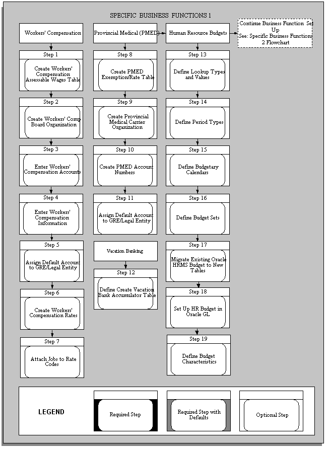

Use the Table Values window.
See: Entering Table Values, Oracle HRMS Configuring, Reporting, and System Administration Guide
Define the location of the WCB agencies.
See: Setting Up Locations, Oracle HRMS Enterprise and Workforce Management Guide
Create the Workers Compensation organizations for each province and territory as an external organization.
Enter and enable the Workers Compensation Board classification.
Use the Organization window.
See: Creating an Organization, Oracle HRMS Enterprise and Workforce Management Guide and Entering Organization Classifications, Oracle HRMS Enterprise and Workforce Management Guide
Specify the province of your WCB board.
See: Entering Workers' Compensation Information, Oracle HRMS Enterprise and Workforce Management Guide
Specify your WCB account name and number.
See: Entering Workers' Compensation Account Information, Oracle HRMS Enterprise and Workforce Management Guide
Define tax withholding rules for categories to include in the WCB wages.
See: Changing Taxability Rules for a Pre-Tax Deduction, Oracle HRMS Payroll Processing Management Guide
Enter the applicable province associated with the account.
In the Provincial Reporting Info for the GRE/Legal Entity Organization, enter the province abbreviation and the appropriate WCB account number for each province.
See: Entering Provincial Reporting Information for a GRE, Oracle HRMS Enterprise and Workforce Management Guide
Enter the codes and associated rates that apply to each account.
Attach jobs to rate codes (if applicable).
See: Configuring WCB Accounts, Oracle HRMS Payroll Processing Management Guide
Enter rate and rate code information for each WCB account.
Use the WCB Accounts window.
Associate the WCB Element with the appropriate employee assignments.
If you are not installing Oracle Payroll, you should skip the section on Provincial Medical.
Employer paid provincial medical plans are legislated in some provinces. The following steps cover all aspects of setting up Provincial Medical in Oracle Payroll.
Note: Some of these steps overlap with the setup of Work Structures and Compensation and Benefits.
For reference on how to set up Provincial Medical, see Rules for Provincial Medical Plans in the Oracle HRMS Payroll Processing Management Guide (Canada).
Define the provincial medical rates for the appropriate provinces in the Table Values window. The exemption amounts are predefined, however you must enter the rates for each threshold in the list of values.
There are four predefined tables for provincial medical:
Manitoba HAPSET
Newfoundland/Labrador HAPSET
Ontario EHT
Quebec Health Services Fund
Define the location of the PMED agencies.
Create the provincial medical organizations for Manitoba, Newfoundland/Labrador, Ontario, and Quebec as external organizations. Select the "Provincial Medical Carrier" classification.
See: Entering Organization Classifications, Oracle HRMS Enterprise and Workforce Management Guide
Specify the province for this PMED.
See: Entering Provincial Medical Carrier Information, Oracle HRMS Enterprise and Workforce Management Guide
Enter the Provincial Medical Account Numbers for each Provincial Medical Carrier.
See: Creating the Provincial Medical Account Numbers, Oracle HRMS Enterprise and Workforce Management Guide
Assign the PMED account to the GRE.
Specify the exemption rates in the PMED table.
Define tax withholding rules for categories to include in the PMED wages.
Associate the Provincial Medical element with the appropriate employee assignments.

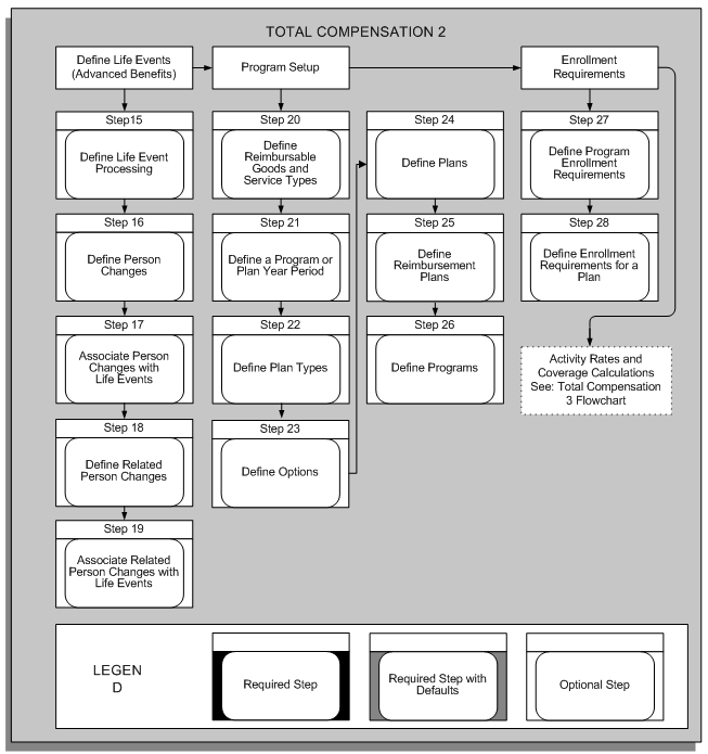

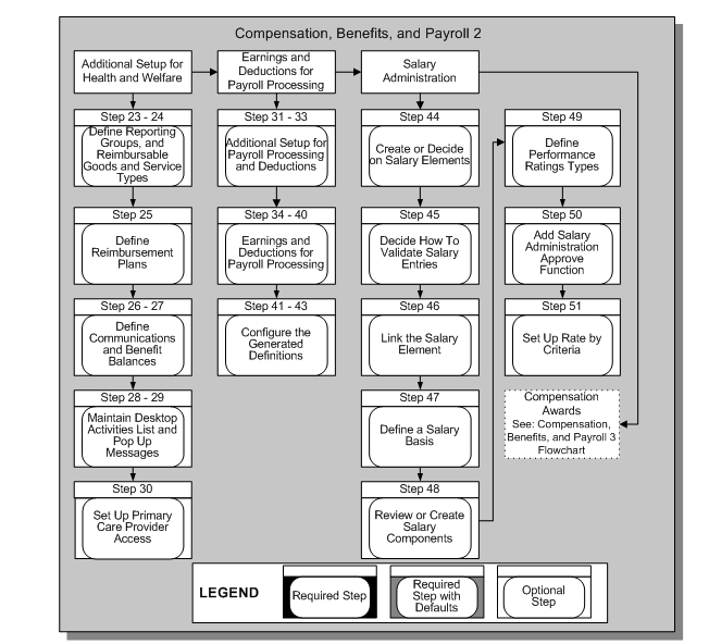

Follow the implementation steps in this section to set up your compensation and benefits plans, including grade/step progression schemes and absence plans. This section includes the following implementation areas:
Grade Related Information: Set up grades to record the relative status of employee assignments
Elements for Information: Define elements to represent a variety of earnings and deductions, as well as other employer liabilities
Benefits: Set up health and welfare offerings
Earnings and Deductions for Payroll Processing: If you use Oracle Payroll, you can set up user defined balances and write Payroll Formulas for elements that you process in payroll runs

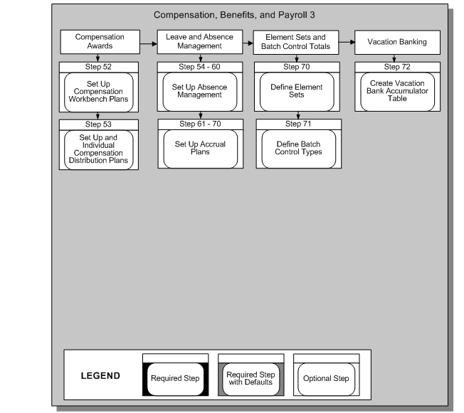

Salary Administration: Manage the basic remuneration that employees receive
Compensation Awards: Distribute one-time and recurring awards, such as stock options and bonuses, or set up voluntary employee contribution plans
Leave and Absence Management: Set up paid time off schemes to administer the vacation or sick leave rules of your enterprise
Element Sets and Batch Control Totals: Group elements together to restrict processing; set up batch controls to calculate numerical input values with Batch Element Entry
Vacation Banking (Canada Only): Calculate and maintain vacation liability
Basic Benefits (US Only): Administer employee benefits based solely on elements, for use with simple benefit plans
If you plan to load details of employee entry history you should consider using a fixed date, such as 01-JAN-1951, as a default for your initial setup definitions. This will simplify your data-entry.
Grades show the relative status of employees within an enterprise. Many enterprises use grades as the basis for eligibility to compensation and benefits.
The Grade Name is a unique combination of values in the segments of the grade flexfield structure that you have linked to your business group.
Use the Grades window.
See: Defining a Grade, Oracle HRMS Compensation and Benefits Management Guide
You can define Valid Grades for jobs or positions. Oracle HRMS checks that you assign employees to valid grades for their jobs or positions.
Use the Valid Grades window.
See: Entering Valid Grades for Jobs or Positions, Oracle HRMS Enterprise and Workforce Management Guide
You can use grade rates to show valid rates of pay for each grade. You can express the rate of pay as a fixed value, or as a range of values.
When you define a grade rate you are setting up a table of values. You can use these values with an employee's grade to control, or compare, the salary of the employee.
You can use grade rate values in Element Input Validation formulas to validate the element entry values given to employees.
Oracle HRMS uses grade rates to calculate comparatio values in the View Employee Grade Comparator window and in the Salary page for salary validation.
Use the Grade Rate window.
See: Defining a Grade Rate, Oracle HRMS Compensation and Benefits Management Guide
If you want to relate pay to grades indirectly through a pay scale, you have a choice:
Use Grade/Step Progression if you want to progress large numbers of employees automatically from one grade, or grade step, to the next on a grade ladder. You can define progression rules for each grade ladder. You can also use criteria salary rates to vary employee pay depending on other details of their assignment, such as job, location, or bargaining unit. This approach is common in public sector enterprises and in highly-regulated organizations such as retail or those subject to collective bargaining.
Use Pay Scales and Scale Rates if you want to progress employees manually or using a process that supports a limited range of criteria for selecting the assignments to progress. Unlike Grade/Step Progression, this approach cannot automatically maintain salary values using element entries. To use this approach, skip this section and go to: Set Up Pay Scales, Scale Rates, and Grade Scales.
Set up the grade ladder, adding grades and steps to it and defining rules for progression and salary update.
Use the Total Compensation Setup Wizard.
See: Setting Up a Grade Ladder, Oracle HRMS Compensation and Benefits Management Guide
Follow these steps if you are not using Grade/Step Progression and you want to relate pay to grades indirectly using a pay scale.
Pay scales are used commonly in government and regulated or unionized enterprises where actual values of pay are defined as a 'pay scale', a 'schedule', or a 'spine'.
In this environment it is common to find an automatic incrementing of employee pay based on length of service or on a fixed date. When you define the Pay Scale you define the points in the incrementing sequence you want to use.
A predefined incrementing process is supplied with Oracle HRMS. This will automatically increment step and point values for employees using a fixed date. You can specify the number of steps that you want a person to be incremented, on a specified pay scale.
Note: You can modify the process to meet your specific business rules for incrementing.
Use the Pay Scale window.
See: Defining a Pay Scale, Oracle HRMS Compensation and Benefits Management Guide
You define a scale rate for each type of pay, such as salary, shift allowance, and overtime. You enter a value for each point on the pay scale. These values are datetracked.
Use the Scale Rate window.
See: Defining Scale Rates, Oracle HRMS Compensation and Benefits Management Guide
Define the points from the pay scale that are valid for each grade as a numeric sequence of steps.
The auto-incrementing process uses these steps to increment an employee's grade point up to a ceiling that you can define for the grade.
Use the Grade Scale window.
See: Relating Grades to Progression Points, Oracle HRMS Compensation and Benefits Management Guide
Elements are the basic components of compensation types, benefits and benefit plans, accrual plans and deductions. You can also use elements to represent tangible items distributed to employees, such as tools or safety equipment. When you install Oracle HRMS you will automatically have elements defined for:
Regular Salary
Regular Wages
At sites including Oracle Payroll, other predefined elements are installed to represent the earnings and deductions that process in the payroll run.
At sites without Oracle Payroll, you can define any number of additional elements to hold information about benefits, compensation types, and other items.
Warning: If you have installed Oracle Payroll you must use the Earnings and Deductions windows to initiate all of your earnings and deductions. This will simplify your setup for payroll processing.
You define new Lookup Types to create additional lists of values to validate any element input value with a character datatype.
Note: You can also use Lookup Types to validate a flexfield segment. Use the Table Validation option for the Value Set and use the Lookups table as the source of your list.
You can add new Lookup Values at any time. You can set the Enable Flag for a Value to No, so that it will no longer appear in the list of values, or you can use the Start and End Dates to control when a value will appear in a list.
When you define input values you can use a formula to validate any entry to that input value.
Important: You must define the formula before you define the element input value. The type of formula is Element Input Validation.
Use the Formula window.
See: Writing Formulas for Validation, Oracle HRMS FastFormula User Guide
Before you start defining elements, you should make all of your decisions about the definitions and rules for eligibility.
Use the Element window. If you plan to process the elements using Oracle Payroll, define the elements using the Earnings and Deductions windows, as described in the next section.
See: Defining an Element, Oracle HRMS Compensation and Benefits Management Guide.
You can give an entry to an employee only when they are eligible for that element. Employees are eligible for an element when their assignment details match the link details.
You can link an element to any combination of organization, group, grade, job, position, payroll, location, employment category or salary basis.
Use the Element Link window.
See: Defining Element Links, Oracle HRMS Compensation and Benefits Management Guide
When you install Oracle HRMS a number of predefined elements are installed. These elements represent the legislative deductions that are processed in the payroll run.
If you have installed Oracle Payroll you will also have all of the formulas and balances you need for processing these deductions. If you have not installed Oracle Payroll, you can still use these elements to record information for transfer to your own payroll system.
To activate these predefined elements you need only define links for them.
This sequence of setup steps for Benefits assumes you are using the Total Compensation Setup Wizard, which is the recommended approach. If you prefer to set up your plan design using individual windows, follow the steps in Benefits Implementation Without Total Compensation Setup Wizard then skip to Earnings and Deductions for Payroll Processing.
Total Compensation Setup Wizard is a guided configuration tool that provides a fast and easy way to set up compensation objects and other plan design data. You can rapidly implement flex and non-flex programs that include health and welfare plans, life insurance plans, and plans of other common plan types funded by employee and employer contributions. Advanced Benefit users may also configure default and life event-based enrollments.
You currently cannot use the Wizard to set up flex credits, premiums, communications, and primary care providers; there are separate windows to set these up. Similarly, if you require formulas or flexfields for your benefit plans, you must set these up in other windows. Some implementation steps are only relevant if you use Oracle Advanced Benefits. These implementation steps are indicated.
You can use the Plan Copy feature to copy programs and plans to provide a starting point for similar plans.
The Total Compensation Setup Wizard provides a step-by-step process for creating Health and Welfare programs and the business processing rules you associate with them. The Wizard guides you through the set up process, reducing the likelihood of implementation errors.
Your base plan design includes compensation objects (programs, plan types, plans, and options), enrollment periods, eligibility profiles, life event reasons, default enrollments, and activity rates. You complete the other components of your plan design using the relevant windows as described in the following steps.
See: Total Compensation Setup Wizard, Oracle HRMS Compensation and Benefits Management Guide
A person with a responsibility of system administrator or application developer can use the Menus window to add the benefits alternate region to the People window.
Query the BEN_MANAGER menu in the Menu field.
Add a new line and select HR View Benefits in the Function field.
Save your work
Use the Menus window.
See: Menus Window, Oracle Applications System Admministrator's Guide
You must define a monthly payroll for each business group you maintain. When you process employee terminations, a copy of the person's assignment record is created as a benefits assignment. Benefits assignments are used to maintain eligibility for continuing benefits, and always have a payroll with a monthly period.
Note: If you have already defined payroll information, including monthly payrolls for each Business Group, you can skip this step.
See: Defining a Default Monthly Payroll for a Business Group, Oracle HRMS Enterprise and Workforce Management Guide
You create a collapsing life event definition for those instances when a combination of two or more detected life events results in either a different life event or the voiding of the detected events.
Use the Collapsing Rules window.
See: Defining a Collapsing Life Event (Advanced Benefits), Oracle HRMS Compensation and Benefits Management Guide
You can use Total Compensation Setup Wizard to convert benefits enrollments from third-party and legacy systems.
See: Converting Benefits Enrollments
You can set up any certifications that a benefits participant must provide to satisfy the enrollment requirements for a compensation object. When a participant fails to provide the required certification, the application suspends the election pending the completion of the action item.
Typical certifications include date of birth and proof of good health.
Use the Certifications window.
See: Defining Certifications for Enrollment in a Plan, Oracle HRMS Compensation and Benefits Management Guide
As part of implementation, you define the required completion date of each action item.
Use the Action Types window.
See: Defining an Action Item Due Date, Oracle HRMS Compensation and Benefits Management Guide

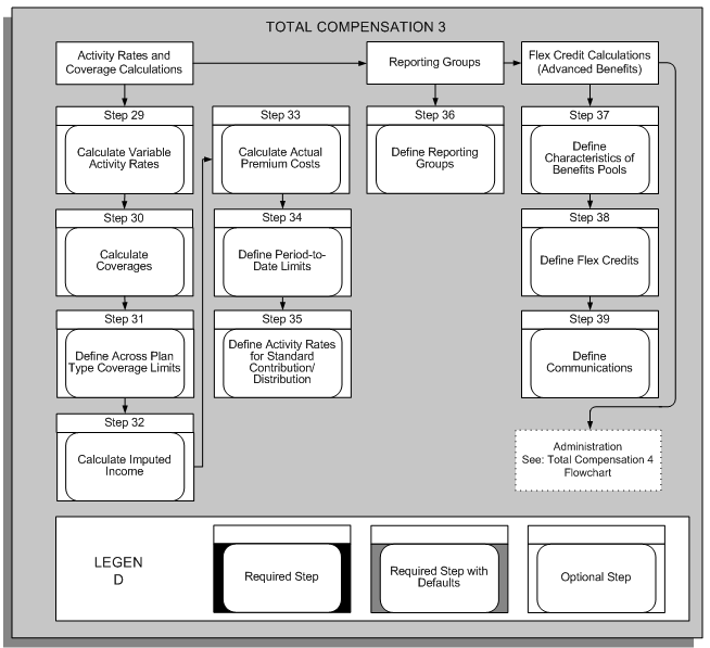

A premium is the amount paid by a plan sponsor to the supplier of the benefit. Typically, you calculate premiums on a per-participant basis, but the application also supports premium calculation based on total enrolled participants and total volume of elected coverage.
You maintain the criteria that the Premium Calculation Process uses to calculate the actual premium cost that a plan sponsor owes to a benefits supplier.
Use the Actual Premiums window.
See: Defining an Actual Premium, Oracle HRMS Compensation and Benefits Management Guide
You define benefit pools to limit how a participant can spend flex credits and how excess flex credits can be rolled over, distributed as cash, or forfeited.
Use the Benefit Pools window.
See: Defining the General Characteristics of a Benefits Pool, Oracle HRMS Compensation and Benefits Management Guide
You define a flex credit calculation and link the calculation with a compensation object. The compensation object to which you link a flex credit calculation must be part of a program regardless of the level at which you define flex credits.
Use the Flex Credit Definitions window.
See: Defining Flex Credits, Oracle HRMS Compensation and Benefits Management Guide
You can define a reporting group that you link to one or more programs and plans. When you run a report for a reporting group, the report results are based on the programs and plans that you include in the reporting group.
You can also define the regulatory bodies and regulations govern a reporting group.
Use the Reporting Groups window.
See: Defining a Reporting Group, Oracle HRMS Compensation and Benefits Management Guide
Define goods and services that you approve for reimbursement. You then associate one or more goods and services types with a reimbursement plan.
Use the Goods and Services window.
See: Defining Reimbursable Goods and Service Types, Oracle HRMS Compensation and Benefits Management Guide
Use reimbursement plans to define goods and services that eligible participants may purchase. The participant can submit a reimbursement claim for the cost of the good or service that was purchased out-of-pocket.
Use the Plan Reimbursement window.
See: Defining a Reimbursement Plan, Oracle HRMS Compensation and Benefits Management Guide
You define the communications you send to employees and other potential participants. You specify the conditions that trigger a communication and the delivery method and medium.
Use the Communication Types window.
See: Defining Communication Types, Oracle HRMS Compensation and Benefits Management Guide
Benefit balances are useful for transitioning legacy system data to Oracle HRMS. You define a benefit balance type and then assign a value to that type for a given person using the Person Benefit Balances window.
Use the Benefit Balances window.
See: Defining a Benefit Balance, Oracle HRMS Compensation and Benefits Management Guide
The Maintain Online Activities window lets you define the functions and windows that are available from the Desktop Activities list of the Online Benefits Services windows.
Use the Maintain Online Activities window.
See: Maintaining Online Activities, Oracle HRMS Compensation and Benefits Management Guide
You can configure messages to display in the Online Benefit Services window based on user events that you define. You create the message text in the Messages window
Use the Maintain Pop Up Messages window.
See: Maintaining Pop Up Messages, Oracle HRMS Compensation and Benefits Management Guide
You can define restrictions on the selection of a primary care provider and set high-level configuration options for web-based PCP database searches through Oracle Self-Service Benefits.
Use the Maintain Plan Primary Care Providers window.
See: Maintaining Primary Care Providers for a Plan, Oracle HRMS Compensation and Benefits Management Guide

A number of predefined earnings types are provided when you install Oracle Payroll. To activate the following predefined earnings you need only define links for them. For the US:
Company Car
GTL Imputed Income
Overtime
Regular Salary
Regular Wages
Shift Pay
For Canada:
Regular Salary
Regular Wages
Vacation Bank Payout
For any other type of earnings, taxable benefits, or non-payroll payments you can initiate the types you require.
When you activate a type of earnings, the system generates all the elements, input values, balance feeds, formulas and result rules you will need to process that type of earnings. You can customize any of these definitions to allow additional data capture or to modify the default calculations.
Use the Earnings window.
See: Identifying the Earnings or Payment, Oracle HRMS Compensation and Benefits Management Guide
All Federal, State and Local Tax Levies (or Federal and Provincial Tax Levies in Canada) are provided when you install Oracle Payroll. Oracle has an agreement with Vertex Inc. to provide and maintain this data. To activate these deductions you need only define links for the following elements. For the US:
VERTEX
US_TAX_VERTEX (if using the Enhanced Tax Interface)
For Canada:
CANADIAN_TAX
CPP EE Retro Exemption
CPP ER Retro Exemption
For Canada, Quebec province:
QPP EE Retro Exemption
QPP ER Retro Exemption
For any other deduction you can initiate the types you require.
Use the Deductions window.
See: Initiating Non-Tax Deductions, Oracle HRMS Compensation and Benefits Management Guide
Before you can enter any of your earnings or deductions for an employee you must define your element links.
Important: You must remember to define links for the predefined elements before you can use them with Oracle HRMS.
For Canada the predefined elements are:
Regular Salary and Regular Salary Special Inputs
Regular Wages and Regular Wages Special Inputs
CANADIAN_TAX
WCB
Provincial Medical
For the US, link the following predefined earnings types using the criteria you require for eligibility and costing:
| Regular Salary and Regular Salary Special Inputs | Regular Wages and Regular Wages Special Inputs |
| Overtime | Shift Pay |
| GTL Imputed Income | Company Car and Company Car Special Inputs |
| Sick Pay | Vacation Pay |
| Time Entry Wages | Labor Recording |
US: Link the following elements using an open link (that is, do not select any eligibility criteria). These links are required for payroll to run and tax correctly:
| Workers Compensation | Workers Compensation2 ER |
| Workers Compensation3 ER | VERTEX |
| US_TAX_VERTEX (if using the Enhanced Tax Interface) |
US: If you need to use the Adjust Tax Balance process, link the following elements using an open link:
| FIT 3rd Party | SIT_SUBJECT_WK |
| City_SUBJECT_WK | County_SUBJECT_WK |
| SUI_SUBJECT_ER | SDI_SUBJECT_ER |
| SUI_SUBJECT_EE | SDI_SUBJECT_EE |
US: You may also need to link the following elements for costing or adjusting balances:
| FUTA CREDIT | FUTA |
| Medicare_ER | MISC1_STATE_TAX_ER* |
| SDI_ER | SS_ER |
| SUI_ER | EIC (Earned Income Credit) |
| City_HT_RS | City_HT_WK and City_HT_WK_ARR |
| City_RS and City_RS_ARR | City_SC_RS and City_SC_RS_ARR |
| City_SC_WK and City_SC_WK_ARR | City_WK and City_WK_ARR |
| County_RS and County_RS_ARR | County_SC_RS and County_SC_RS_ARR |
| County_SC_WK and County_SC_WK_ARR | County_WK and County_WK_ARR |
| FIT and FIT_ARR | FIT_GROSSUP_ADJUSTMENT |
| Medicare_EE and Medicare_EE_ARR | SDI_EE and SDI_EE_ARR |
| MISC1_COUNTY_TAX_WITHHELD_RS* | MISC1_COUNTY_TAX_WITHHELD_WK* |
| SUI_EE and SUI_EE_ARR | POST_VERTEX_SDI_PTD_LIMIT |
| SIT_RS and SIT_RS_ARR | SIT_WK and SIT_WK_ARR |
| SS_EE and SS_EE_ARR | Workers Compensation EE |
| Workers Compensation2 EE |
*The MISC1_COUNTY elements are used to calculate Mental Health Tax in Boone county, Kentucky. Cost MISC1_COUNTY_TAX _WITHHELD_RS like County RS. Cost MISC1_COUNTY _TAX_WITHHELD_WK like County WK. The MISC1_STATE elements are used to calculate State Health Insurance tax for Massachusetts. Cost MISC1_STATE_TAX_ER like SDI_ER.
Oracle Payroll comes with the current rules for the federal and state-level (or provincial-level) taxability already in place for regular earnings and deductions, and taxable benefits in Canada. You can update these rules as necessary.
Note: US: The system does not come with rules in place regarding the inclusion of supplemental and imputed earnings categories in states' payroll exposure.
Use the Taxability Rules window.
See: Changing Taxability Rules for an Earnings Type , Oracle HRMS Payroll Processing Management Guide
For Canada, also see: Changing Taxability Rules for a Taxable Benefit, Oracle HRMS Payroll Processing Management Guide
When you initiate a type of earnings or deduction, Oracle Payroll generates all the elements, input values, balance feeds, formulas and result rules you need to process that type of earnings or deduction in a payroll run. Additionally, it associates a Skip Rule (formula) with the elements generated.
You can configure any of these definitions to meet your specific business needs.
You can edit any of the generated 'Oracle Payroll' formulas to change the default calculations. You can also write your own formulas if you have special calculations that are very different from the defaults.
Canada only: The generated formulas for earnings types include three processing options for handling negative earnings. If you do not want to use the default option, remove the comments from the appropriate section of formula code. See: Negative Earnings, Oracle HRMS Compensation and Benefits Management Guide.
Important: Remember that formula definitions are datetracked. After you have used a formula in a payroll calculation you should always 'Update' any changes to the formula.
This will keep the history of formulas for any re-calculation of retrospective earnings or deductions.
See: Writing Payroll Formulas for Elements, Oracle HRMS FastFormula User Guide
Important: Oracle Payroll has many predefined balances installed with the system. To protect the integrity of the payroll processes you cannot change any of these balances.
You can configure any generated balance to change the feeds. A payroll balance has 'feeds' and 'dimensions'. You can modify the feeds and also add your own dimensions.
You can define other balances. For example, you might want to define a special balance to calculate a 'Stop Rule' on a recurring deduction. You might also need to define a special balance for calculating retroactive payments.
When you define a payroll balance you must specify the feeds and the dimensions.
Use the Balance window.
See: Defining User Balances, Oracle HRMS Compensation and Benefits Management Guide
When you process an element in a payroll run the system will calculate the results using a formula. The results of the formula are the values you include in the Return statement to end the formula. The result rules define what will happen to each of the results produced by the formula.
When you activate any earnings or deduction type the system generates the formula results and the rules for each result. If you customize the formula you may also have to customize the results.
You can calculate any number of different results in a single formula. The different types of result are:
Direct
Indirect
Message
Order Indirect
Stop Recurring
Update Recurring
There is normally at least one Direct result of a payroll calculation, which provides the Pay Value of the entry. You can create additional direct results.
Warning: If you allow users to enter the Pay Value of any earnings or deduction type, this value will override any formula calculation to provide the direct result for payment.
Use the Formula Result Rules window.
See: Defining Formula Processing and Result Rules, Oracle HRMS Compensation and Benefits Management Guide
Use the Salary Administration function to manage basic remuneration for individual employees.
You need at least one salary element for each salary basis in your enterprise.
If predefined elements exist in your localization, you might decide to use these. If your localization does not include predefined elements, or if the predefined elements are insufficient or inappropriate, you must create these elements to store the salary value.
Note: Consider how many different elements you will need to define for the different salary bases you want to manage. Remember that you can administer the salary on an annual basis but store the value as a monthly value.
See: Creating a Salary Element, Oracle HRMS Compensation and Benefits Management Guide
You can validate salary entries in one of two ways:
Warn users when they enter a salary proposal that is outside a valid range defined for an employee's grade. This approach uses grade rate ranges.
Prevent users from approving a salary that is outside a valid range, or that fails validation performed by a formula. Notice that this validation is not performed until you try to approve a salary proposal. This approach uses element input value validation.
See: Validating Salary Entries, Oracle HRMS Compensation and Benefits Management Guide
Link the salary elements to components of employee assignments to establishes employee eligibility for the elements.
See: Linking the Salary Element, Oracle HRMS Compensation and Benefits Management Guide
Define a salary basis for each salary element to be used for salary administration. This establishes the duration for which a salary is quoted, for example, hourly, monthly or annually.
Use the Salary Basis window.
See: Defining a Salary Basis, Oracle HRMS Compensation and Benefits Management Guide
Review the salary components predefined as values for the Lookup Type PROPOSAL_REASON. If necessary, create your own salary components.
If you want your new components to be displayed in the Salary Management folder, you must also change a view.
See: Creating Salary Components, Oracle HRMS Compensation and Benefits Management Guide
If you want to record performance ratings such as Outstanding, Superior and Average, enter them in the Application Utilities Lookups window for the Lookup Type PERFORMANCE_RATING.
Add the function "Salary Administration Approve" to the menu of responsibilities that should be able to approve salary proposals. Without this function, users can enter salary proposals but they cannot approve them.
Note: If this function does not exist for a Responsibility then a user can enter but not approve salary proposals.
See: Defining Menus, Oracle HRMS Configuring, Reporting, and System Administration Guide
To pay employees at varying rates according to a range of eligibility criteria, you must set up Rate By Criteria (RBC), including these three areas:
Create your own eligibility criteria (optional for RBC)
Define criteria rates
Create a rate matrix
See: Setting Up a Rate Matrix, Oracle HRMS Compensation and Benefits Management Guide

You can set up as many plans as you need to permit employees to accrue PTO to use for vacation or sick leave. Each plan has the units of Hours or Days, and can have its own rules regarding accrual frequency, accrual bands, ceilings, carryover, start dates, entitlement of employees with different assignment statuses, and so on.
If you want to associate recurring elements with absence types, you must set up proration and retro notifications. This ensures that absences that end in the middle of a payroll period are detected and processed by the payroll run, and that retrospective changes to absences are recorded in the Retro Notifications report.
See: Setting Up Absence Management, Oracle HRMS Compensation and Benefits Management Guide
For each of your accrual plans, or each type of absence you are tracking, you define a nonrecurring element and input value to hold the actual time taken for vacation or sick leave.
If you use Oracle Payroll, you can use a recurring element instead. This enables you to begin processing a long term absence before you enter an end date, and to apportion time correctly over payroll periods.
See: Defining and Linking an Absence Element, Oracle HRMS Compensation and Benefits Management Guide
Link each absence element to define who is eligible to take this kind of absence.
Define categories of absence types as values for the Lookup Type ABSENCE_CATEGORY, and your absence reasons as values for the Lookup Type ABSENCE_REASON.
If you expect to record absent time using the Absence Detail window, define each absence type, and associate it with an absence element
Use the Absence Attendance Type window.
See: Defining an Absence Type, Oracle HRMS Compensation and Benefits Management Guide
For an absence type with a decreasing balance, use the Element Entries window or the Element Entry API to make initial element entries for employees eligible for the type. You can also initialize a decreasing balance by entering a negative value using BEE. For example, if you enter -16 hours using BEE, a decreasing balance starts at 16 hours. However, be aware that using BEE creates an absence record that will show on employees' absence history.
If you want to make batch entries, see Making Batch Element Entries Using BEE, Oracle HRMS Configuring, Reporting, and System Administration Guide.
If you defined a recurring element, create a payroll formula that handles proration to process the element and calculate the appropriate absence duration in each pay period (taking into account the number of days or hours in a month, working and shift patterns, public holidays, and so on).
See: Sample Payroll Formulas Enabled for Proration, Oracle HRMS FastFormula User Guide
There are three seeded start rules: Hire Date, Beginning of Calendar Year, and Six Months After Hire Date. If you need other rules, define them as values for the Lookup Type US_ACCRUAL_START_TYPE.
Decide which Accrual and Carry Over formulas to use. You can use the seeded formulas, customize them, or write your own.
See: Writing Formulas for Accrual Plans, Oracle HRMS FastFormula User Guide
If your Accrual formula defines a period of ineligibility and you want to use Batch Element Entry (BEE) to enter absences against the accrual plan, define an Ineligibility formula. BEE calls this formula to check whether an employee is eligible to use accrued PTO.
Note: If you use the seeded Accrual formulas, you do not need to define an Ineligibility formula. They use a period of ineligibility entered on the Accrual Plan form, and BEE validation can use the same value.
There are several seeded accrual categories. If you need additional categories, define them as values for the Lookup Type US_PTO_ACCRUAL.
Oracle Payroll users: If you want to use a payroll balance to store gross accruals, decide whether the payroll run should update accruals as of the run's date earned (the date the payroll run uses to determine which element entries to process) or date paid (the date that appears on pay advices). Select your choice for the business group.
See: Business Groups: Selecting a PTO Balance Type, Oracle HRMS Enterprise and Workforce Management Guide
Oracle Payroll users: If you want to use a payroll balance to store gross accruals, consider whether you need to define a new balance dimension. Dimensions are predefined that reset the balance each year on 1 January, 1 June, or hire date anniversary. If you require your balance to accumulate over a different period of time, or reset at a different date, you must create your own balance dimension.
See: Balances in Oracle Payroll
Define the accrual plan, selecting the formulas and absence element it is to use.
Use the Accrual Plan window.
See: Defining a PTO Accrual Plan, Oracle HRMS Compensation and Benefits Management Guide
Optionally, set up length of service bands for the plan.
Use the Accrual Bands window.
See: Setting Up Length of Service Bands, Oracle HRMS Compensation and Benefits Management Guide
Review the net calculation rules for the plan. If necessary, create additional elements and associate them with the plan by selecting them in the Net Calculation Rules window.
See: Changing Net Accrual Calculations, Oracle HRMS Compensation and Benefits Management Guide
In Oracle HRMS you can define a set of elements to:
Restrict access to elements using Form Customization
Distribute costs across a Distribution Set of elements
Process a restricted set in a Payroll Run
Enter values for a restricted set using BEE (Batch Element Entry)
You define an element set as a named list of elements such as Salary, or Salary and Bonus. You can also define an element set using the classification. For example, you can restrict access to all elements in the classification Earnings.
Use the Element and Distribution Set window.
See: Defining an Element or Distribution Set , Oracle HRMS Compensation and Benefits Management Guide
If you use Batch Element Entry, you can set up batch control types to sum the entries in any numerical input value. This enables users to validate a BEE batch against control totals to check for missing lines or miskeying of amounts.
See: Setting Up BEE Validation Using Control Totals, Oracle HRMS Configuring, Reporting, and System Administration Guide
Define the length of service bands and the associated percentage with which to calculate the vacation liability. The accumulation is paid out through the predefined Vacation Bank Payout element. You can use the sample user table called Default Vacation Bank.
Define the user table. The lower and upper bound columns represent the length of service bands. Value represents the vacation percentage.
Link the Vacation Bank Accumulator element.
Specify the User Table name and User Table column in the input values.

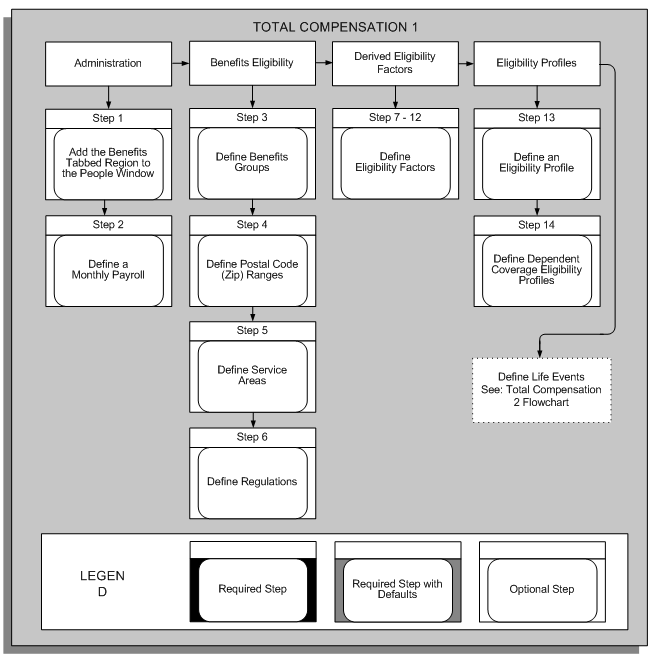

If you are beginning a new setup for benefits administration, we recommend that you implement the Standard Benefits feature set and skip this step. Basic Benefits provides a limited set of features and is provided mainly for compatibility with earlier releases.
To set up basic benefits, you define elements for the benefits plans, use element links to establish eligibility, and create benefit carriers as organizations. You can modify the standard COBRA letters and provide new COBRA termination reasons.
See: Setting Up Basic Benefits, Oracle HRMS Compensation and Benefits Management Guide
The following implementation steps provide the full sequence of steps you follow to set up benefit plans manually. If you are using the Total Compensation Setup Wizard, note that the Wizard handles most of the steps in the following sections:
Benefits Eligibility
Life Events
Compensation Objects
Enrollment Requirements
Activity Rates and Coverage Calculations
See: Compensation, Benefits, and Payroll, Oracle HRMS Compensation and Benefits Management Guide if you implement your benefit plans using the Total Compensation Setup Wizard, which is the recommended approach.
If you plan to load details of employee entry history you should consider using a fixed date, such as 01-JAN-1951, as a default for your initial setup definitions. This simplifies your data-entry.
You define participation eligibility profiles to determine eligibility for compensation and benefits. You can also use eligibility factors to determine variable contribution and distribution rates for a benefit.
You define a benefits group as a category of people who can be either included or excluded from receiving a benefit or a standard activity rate. A benefit group is one optional component of an eligibility profile or a variable rate profile.
Use the Benefits Groups window.
See: Defining Benefits Groups, Oracle HRMS Compensation and Benefits Management Guide
You define postal code (zip) ranges if you limit benefits eligibility based on a person's home address or if an activity rate varies based on a person's address.
Postal code ranges are also a component of service areas.
Use the Postal Zip Ranges window.
See: Defining Postal Zip Ranges, Oracle HRMS Compensation and Benefits Management Guide
You can define a service area to group people who live in a region by their postal codes. A service area is one optional component of an eligibility profile or a variable rate profile.
Use the Service Areas window.
See: Defining Service Areas, Oracle HRMS Compensation and Benefits Management Guide
You define regulations as discrete rules, policies, or requirements that a governmental or policy making body defines regarding the administration of one or more benefits.
Use the Regulations window.
See: Defining Regulations, Oracle HRMS Compensation and Benefits Management Guide
You can create as many eligibility profile criteria as you need, in addition to the existing standard eligibility and derived factor criteria, to meet the particular requirements of your organization. You can use these criteria to determine employee eligibility for compensation, benefits, entitlements in collective agreements, personal actions, and so on.
Use the User Defined Eligibility Criteria window, which you can access from the Participation Eligibility Profiles window, or the Create Eligibility Criteria page.
See: Creating your own Eligibility Criteria., Oracle HRMS Compensation and Benefits Management Guide
A derived factor is a system calculated value that you can use to determine eligibility for a benefit or to determine an activity rate.
Define compensation level factors to determine how the system derives a person's compensation level based on a person's stated salary or a balance type that you specify.
Use the Derived Factors window.
See: Defining Derived Factors: Compensation Level, Oracle HRMS Compensation and Benefits Management Guide
Define percent of full time factors to determine how the system derives a person's percent of full time employment.
See: Defining Derived Factors: Percent of Full Time Employment, Oracle HRMS Compensation and Benefits Management Guide
Define hours worked in period factors to determine how the system derives the number of hours a person worked in a given period.
See: Defining Derived Factors: Hours Worked in Period, Oracle HRMS Compensation and Benefits Management Guide
Define age factors to determine how the system derives a person's age.
See: Defining Derived Factors: Age, Oracle HRMS Compensation and Benefits Management Guide
Define length of service factors to determine how the system calculates a person's length of service.
See: Defining Derived Factors: Length of Service, Oracle HRMS Compensation and Benefits Management Guide
Define combination age and length of service factors to combine an age factor and a length of service factor.
See: Defining Derived Factors: Combination Age and Length of Service, Oracle HRMS Compensation and Benefits Management Guide
Defining an eligibility profile is the primary way in which you implement eligibility requirements for a benefit. You link an eligibility profile with a compensation object (a benefit that you define) so that when eligibility processes run, only the persons meeting the eligibility profile requirements are eligible to receive the benefit.
Use the Participation Eligibility Profiles window.
See: Defining an Eligibility Profile, Oracle HRMS Compensation and Benefits Management Guide
You define dependent coverage eligibility profiles to enforce eligibility requirements for dependents.
Use the Dependent Coverage Eligibility Profiles window.
See: Defining a Dependent Coverage Eligibility Profile, Oracle HRMS Compensation and Benefits Management Guide
You define a life event as a change in a person's record that can potentially trigger an enrollment action. Life events can be external to work, such as a marriage or the birth of a dependent, or they can be internal, such as a job change. The application also handles scheduled enrollments as life events.
Define the life events that you use to control electability, activity rates and coverage levels, coverage dates, communications, and automatic and default enrollment processing.
Use the Life Event Reasons window.
See: Defining General Characteristics of Life Event Reasons, Oracle HRMS Compensation and Benefits Management Guide
You define the changes to a person's record that trigger a life event by specifying the value of the database field that indicates this person change has occurred.
Use the Person Changes window.
See: Defining Person Changes, Oracle HRMS Compensation and Benefits Management Guide
You associate the person change that triggers the life event for each life event that you define.
Use the Person Change Causes Life Event window.
See: Associating a Person Change with a Life Event, Oracle HRMS Compensation and Benefits Management Guide
You define the changes to a person's record that trigger a life event for a related person by specifying the value of the database field that indicates this related person change has occurred.
For example, you could define a termination life event to end benefits coverage for terminated employees. You would define a corresponding related person life event that ends coverage for the dependents of the primary participant when the primary participant is terminated.
Use the Related Person Changes window.
You associate a related person change with each related person life event that you define. A related person change is a change to the primary participant's HR record that may generate a life event for a person related to the primary participant.
Use the Related Person Change Causes Life Event window.
You define compensation objects as the benefits that you offer to your employees and other eligible participants.
Compensation objects are arranged according to the compensation object hierarchy:
Program
Plan Type
Plan
Option
Definitions that you set at the program level cascade to the plan types, plans, and options in that program unless you override the definition at a lower point in the hierarchy.
You define a program or plan year period to set the coverage boundaries for the duration of a benefit program or plan.
Use the Program/Plan Year window.
See: Defining a Program or Plan Year Period, Oracle HRMS Compensation and Benefits Management Guide
You define plan types to categorize common types of benefits, such as medical plans or savings plans.
Use the Plan Types window.
See: Defining Plan Types, Oracle HRMS Compensation and Benefits Management Guide
You define options to indicate the coverage levels available under a plan or to define investment options for a savings plan.
Use the Options window.
See: Defining Options, Oracle HRMS Compensation and Benefits Management Guide
A plan is a benefit in which an eligible participant can enroll. Common plans include medical, group term life insurance, and stock purchase plans.
Use the Plans window.
See: Defining a Benefits Plan, Oracle HRMS Compensation and Benefits Management Guide
You define a program to group together the benefits that you offer as a package. A program typically is comprised of plan types, plans, and options.
Use the Programs window.
See: Defining a Benefits Program, Oracle HRMS Compensation and Benefits Management Guide
You define enrollment requirements to control when an eligible person can enroll in a benefit.
Enrollment requirements determine how an eligible participant enrolls in a program.
In standard benefits, you define enrollment requirements based on the unrestricted enrollment type. Advanced Benefits customers can specify whether default or automatic enrollment rules apply for a program.
Use the Program Enrollment Requirements window.
See: Defining Enrollment Methods for a Program, Oracle HRMS Compensation and Benefits Management Guide
You use the Plan Enrollment Requirements window to define enrollment requirements for a not in program plan or an option in plan. You also use this window to set up requirements for beneficiary designations.
Use the Plan Enrollment Requirements window.
See: Defining an Enrollment Method for a Plan, Oracle HRMS Compensation and Benefits Management Guide
Activity rate calculations determine the contribution rate necessary to purchase a benefit and the distribution rate for benefits that provide distributions.
You define variable activity rate calculations if an activity rate for a compensation object can vary by participant.
Use the Variable Rate Profiles window.
See: Defining General Information for a Variable Rate Profile, Oracle HRMS Compensation and Benefits Management Guide
You define the amount of coverage available under a benefit plan for those plans that offer a range of coverage options. Your coverage calculation can include the minimum and maximum coverage level available regardless of the calculation result. For Advanced Benefits customers, coverage levels can vary based on life events.
Use the Coverages window.
See: Defining a Coverage Calculation, Oracle HRMS Compensation and Benefits Management Guide
You can define the minimum and maximum coverage amount that a participant can elect across plan types in a program.
Use the Coverage Across Plan Types window.
See: Defining a Coverage Limit Across Plan Types, Oracle HRMS Compensation and Benefits Management Guide
You can define activity rates that calculate the amount of plan income that is considered a "fringe benefit" and subject to Section 79 of the US Internal Revenue Service code.
Note: You must have already created the corresponding elements.
Use the Imputed Income window.
See: Defining an Imputed Income Calculation, Oracle HRMS Compensation and Benefits Management Guide
You need to maintain the criteria used to calculate the actual premium cost that a plan sponsor owes to a benefits supplier.
You define period-to-date contribution limits for those plans or options in plan that restrict participant contribution levels in a year period. When you define a standard contribution, you can associate a period-to-date limit for those plans or options in plan that require contribution restrictions.
Use the Period-to-Date Limits window.
See: Defining Period-to-Date Limits, Oracle HRMS Compensation and Benefits Management Guide
You define a standard activity rate calculation to calculate a benefit's contribution or a distribution amount.
Use the Standard Contributions/Distributions window.
See: Defining Activity Rates for a Standard Contribution/Distribution, Oracle HRMS Compensation and Benefits Management Guide
Save your work.
See: Menus Window, Oracle E-Business Suite Security Guide
You use the Online Benefit Services window to access a variety of benefits windows from a central location. You can configure the windows that are accessible from this window and you can define the pop up messages that display based on user events that you define.
For the next step in the implementation sequence, see: Additional Setup for Payroll Processing, Oracle HRMS Compensation and Benefits Management Guide .

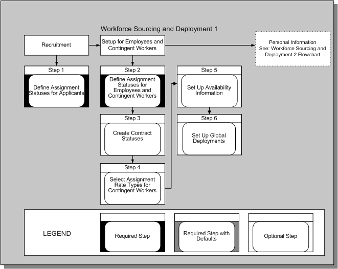

Oracle HRMS enables you to define your own names to identify the "types" of people in your system, and to identify the status of employees and contingent workers in each assignment using your own names.
Assignment Statuses for applicants enable you to define the distinct stages of your own recruitment processes.
With Oracle HRMS you can use your own names to identify these stages. For example, you might want to define a special status to identify applicants who have been invited to a First Interview and applicants who have been Rejected on Application.
These user statuses enable you to track the recruitment circumstances of all your applicants.
Use the Assignment Statuses window.
See: Defining Assignment Statuses, Oracle HRMS Workforce Sourcing, Deployment, and Talent Management Guide
With Oracle HRMS you can identify the status of employees and contingent workers in each assignment using your own names. For example, you might want to define special statuses to identify assignments which have been Suspended while the employee or contingent worker is temporarily assigned to another role.
Be sure to set up your assignments to accommodate the classification of employees for Employment Equity reporting.
See: Employment Equity Interface Employee Details, Oracle HRMS Enterprise and Workforce Mangemement Guide
See: Defining Assignment Statuses, Oracle HRMS Enterprise and Workforce Management Guide
Oracle HRMS enables you to create up to 250 different contract statuses to help track and identify employees.
See: Creating Contract Statuses, Oracle HRMS Enterprise and Workforce Management Guide
This step applies only if you are not using Oracle Services Procurement to provide purchase order information for contingent workers.
Oracle HRMS enables you to record payment rate information for contingent workers. You select an assignment rate type (such as Standard Rate or Weekend Rate) and associate it with a rate basis (such as Hourly Rate or Weekly Rate). You can then associate this combination of rate type and basis with an assignment rate (a monetary value) for specific contingent worker assignments.
See: Defining a Combination of Assignment Rate Type and Basis, Oracle HRMS Enterprise and Workforce Management Guide
You can define additional rate basis values for your assignment rate types by adding to the existing lookup type RATE_BASIS.
Use the integrated features from Oracle HRMS and Common Application Components (CAC) to set up information such as shifts, schedules, and calendar events to help you determine a worker's availability.
See: Setting Up Availability, Oracle HRMS Workforce Sourcing, Deployment, and Talent Management Guide
HR Professionals can use the Global Deployments function to transfer employees automatically between business groups. Some setup tasks are necessary for the Global Deployments function.
See: Setting Up Employee Transfers and Secondments, Oracle HRMS Workforce Sourcing, Deployment, and Talent Management Guide
Use the Personal Analysis Key Flexfield to record special personal information that is not included as standard information. You define each type of information as a separate Structure of the flexfield. For example, you might set up a structure to hold medical information.
This flexfield is used in the following areas:
Special Information details for People
Matching requirements for Jobs and Positions
You need to design a Personal Analysis Flexfield Structure for each Special Information Type you want to hold in Oracle HRMS. For each structure you must include the following:
The Structure Name and the number of Segments.
The Flexfield Segment Names, Order and Validation Options.
The Flexfield Value Sets to be used and any lists of values.
Defining the Flexfield Structure is a task for your System Administrator.
Note: You cannot use the Create Key Flexfield Database Items process to create database items for the segments of your Personal Analysis Flexfield structures.
If you want to validate the values which a user can enter for any segment you must define a specific Value Set.
The attributes of the Value Set will control the type of values that can be entered, and how many characters each segment can hold. The attributes of the Value Set will also control how the values are to be validated.
See: Defining Value Sets, Oracle Applications Flexfields Guide
Define a structure for your Personal Analysis Flexfield which contains the segments you want to use. You will use this structure to enter details in the Special Information Types window.
You must enter Yes in the Allow Dynamic Inserts field. If you enter No, you will not be able to enter new details in the Special Information Types window.
See: Defining Key Flexfield Structures, Oracle Applications Flexfields Guide
If you have chosen Independent or Dependent validation for a Value Set used by a Personal Analysis Flexfield Segment, you must define your list of valid values for the Value Set.
See: Defining Segment Values, Oracle Applications Flexfields Guide
Define any Cross Validation Rules you want to use to control the combinations of segment values which a user can enter.
See: Defining Cross-Validation Rules, Oracle Applications Flexfields Guide
Use the Shorthand Aliases window.
See: Defining Shorthand Aliases, Oracle Applications Flexfields Guide
You are now ready to freeze your flexfield definition. Navigate to the Define Flexfield Segments window. Enter Yes in the Freeze Flexfield Definition field and save your changes. Oracle Human Resource Management Systems now freezes and compiles your Personal Analysis Flexfield definition. Compiling the flexfield definition enables the flexfield window with the defaults, values and rules that you have defined.
After you have defined your Personal Analysis Flexfield Structures you must link them to your business group.
You do this using your view-all responsibility.
Select each Information Type you want to use in this business group.
Select the categories for each type.
Job for Job Requirements
Position for Position Requirements
Skills for use with Oracle Training Administration
Other for use with Person Special Information
ADA for use only in the US, for special information types set up to record information about employees with disabilities
OSHA for use only in the US, for a special information type set up to record information about employees' work-related injuries or illness
Tip: If you do not check the Other category, you cannot use the type to hold information for a person. This means that you could also use the Special Information Types to hold any type of information for a Job or a Position only.
Use the Special Information Types window.
See: Enabling Special Information Types, Oracle HRMS Workforce Sourcing, Deployment, and Talent Management Guide
If you have decided to set up competencies, you can enter these as requirements for jobs and positions and match them against people's competence profiles.
If you have other job and position requirements that you want to record, but not define as competencies, you can set them up using the Personal Analysis key flexfield. You can set up each type of requirement as a Special Information Type, which is one instance of the flexfield.
For each Special Information Type, you can also choose whether to enable entry of information for people so that you can match people against the job or position requirements. A standard report (Skills Matching) has been provided to match the requirements of a job and the Special Information details of people in the system.
You can define the attributes required by any employee who is assigned to a job. These attributes may be Essential or Desirable.
Definitions of requirements can use the same personal analysis flexfield structures and segments you have defined for special personal information.
Use the Job window.
See: Entering Job and Position Requirements, Oracle HRMS Enterprise and Workforce Management Guide
After you define positions in your enterprise, you can define the attributes required by any employee assigned to that position. These attributes may be Essential or Desirable. The requirements are based on the same personal analysis flexfield structures you have defined for special personal information.
Use the Position window.
Talent Management is the management of worker competencies and objectives to meet enterprise goals. Oracle HRMS, Oracle SSHR, and Oracle Learning Management (OLM) each supply key components of the Talent Management functionality. This topic describes the implementation process for the Oracle HRMS competencies, qualifications, and career path functions.
Oracle Performance Management is a separately licensed product. You must purchase a separate Oracle Performance Management license in addition to an Oracle Self-Service HR license to use the Appraisals, Questionnaire Administration, and Objectives Management self-service functions.
See: Oracle Performance Management Overview, Oracle Performance Management Implementation and User Guide
See: Implementing Oracle Performance Management, Oracle Performance Management Implementation and User Guide
Competencies are measurable skills a workforce must acquire or possess to enable the enterprise to achieve its goals.
Each business group has a competence key flexfield structure. For global competencies, you can define an additional competence key flexfield or use an existing, business-group-specific structure. In either case, you identify the structure for creating global competencies on the HR:Global Competence Flex Structure Profile Option. Otherwise, you cannot create global competencies.
Use the System Profile Values window.
You can use generic proficiency rating scales to assess competencies during an appraisal.
Use the Rating Scales window.
See: Creating a Rating Scale, Oracle HRMS Workforce Sourcing, Deployment, and Talent Management Guide
Create definitions of competencies recognized and required by your enterprise to meet business goals.
Use the Competencies window.
See: Creating a Competency, Oracle HRMS Workforce Sourcing, Deployment, and Talent Management Guide
As an alternative or in addition to creating individual competencies, you can upload competencies supplied by third-parties, such as vendors who supply competency definitions for specific lines of business.
See: Uploading Third-Party Competency Information, Oracle HRMS Workforce Sourcing, Deployment, and Talent Management Guide
For ease of management and retrieval, you can group competencies into competency types. You define competency types using the lookup COMPETENCE_TYPE.
Associate individual competencies with one or more defined competency types.
Use the Competence Types window.
See: Grouping Competencies into Types, Oracle HRMS Workforce Sourcing, Deployment, and Talent Management Guide
You can define competency requirements for business groups, jobs, organizations, and positions. You can compare an individual's competencies with those required for a job or position, for example, to assist with promotion, training, or compensation plans.
Use the Competence Requirements window.
Defining Competency Requirements, Oracle HRMS Workforce Sourcing, Deployment, and Talent Management Guide
A competency is a record of a worker's proficiency in competencies of interest to the enterprise. Users can compare worker competency profiles with the competency requirements of jobs or positions when searching for suitable candidates, for example.
See: Creating a Competency Profile, Oracle HRMS Workforce Sourcing, Deployment, and Talent Management
For each worker, you can record qualifications achieved and educational establishments attended.
You can define all qualification types your enterprise recognizes.
Use the Qualification Types window.
See: Creating Qualification Types, Oracle HRMS Workforce Sourcing, Deployment, and Talent Management Guide
You can define all schools and colleges that deliver the qualifications your enterprise recognizes, so that users can select an educational establishment when recording a worker's qualifications. Alternatively, users can enter school and college names manually for each qualification.
Note: School and college definitions are available to all business groups; therefore, define them once only.
Use the Schools and Colleges window.
See: Creating Schools and Colleges, Oracle HRMS Workforce Sourcing, Deployment, and Talent Management Guide
Career Paths show the progression opportunities that are available to workers in your enterprise. You can define career paths based on either jobs or positions.
Define the career-progression routes available to workers in your enterprise.
Important: In the US, for AAP-Workforce Analysis reporting use the career path functionality to build the lines of progression for the jobs included in your AAP plans.
Use the Career Path Names and Map Career Paths windows.
See: Defining Career Paths, Oracle HRMS Workforce Sourcing, Deployment, and Talent Management Guide
You can record requirements, such as work location and work schedule, for jobs and positions.
Use the Work Choices window.
See: Entering Work Choices for a Job or Position, Oracle HRMS Workforce Sourcing, Deployment, and Talent Management Guide
For each worker, you can enter work preferences, such as the preferred work location or working schedule. You can compare this information with job or position requirements when career planning or looking for candidates.
Use the Work Preferences window.
See: Entering Work Preferences, Oracle HRMS Workforce Sourcing, Deployment, and Talent Management Guide
These implementation steps are required to enable you to view data in the HRMS Discoverer business areas and workbooks. They assume that you already have installed Discoverer. For information on Discoverer installation, see: Discoverer Administration Guide.
Additional Information: See also My Oracle Support Knowledge Document 2277369.1, Oracle E-Business Suite Support Implications for Discoverer 11gR1.
Follow the steps below to implement Workforce Intelligence Discoverer workbook reports. If you do not complete these steps, reports will be available to you, but they will not display data correctly. You need to perform some of these steps periodically, so that the reports reflect changes in your enterprise data. See: Programs to Populate Workforce Intelligence Discoverer Reports, Oracle HRMS Configuring, Reporting, and System Administration Guide
Workforce is not necessarily a count of the number of employees within your enterprise. Instead, it is a count based on employee assignments and budget measurement type. Calculations depend either on your budget measurement values for assignments, or they use a FastFormula..
Set budget measurement values for each employee assignment within Oracle Human Resources. Reports and performance measures then calculate workforce using the budget values.
If you do not set a budget measurement value for an assignment, and a Business Group default does not exist, the reports and performance measures either calculate workforce using Oracle FastFormula, or they will not include the workforce for an assignment.
Use the Assignment Budget Values window.
See: Entering Assignment Budget Values, Oracle HRMS Enterprise and Workforce Management Guide
If you want to configure how workforce is counted do not set a budget measurement type and assignment measurement value for an assignment. The reports will then use Oracle FastFormula to calculate workforce.
HRMSi provides two predefined workforce formulas:
TEMPLATE_HEAD
TEMPLATE_FTE
See: Configuring Workforce Calculations using Oracle FastFormula, Oracle HRMS Configuring, Reporting, and System Administration Guide
Workforce Intelligence uses the conversion rates set up in the GL Daily Rate window. You can enter a specific conversion rate type for Workforce Intelligence, such as Corporate or Spot.
Use the Oracle Human Resources Table Values window.
See: Entering a Conversion Rate Type, Oracle HRMS Configuring, Reporting, and System Administration Guide
Within Oracle Training Administration OTA you can record the duration of a training event using a time period of your choice.
For example, rather than recording an event in hours you might record it in weeks or months. To enable the workbooks to display the number of hours of a training event, a predefined Oracle FastFormula, TEMPLATE_BIS_TRAINING_CONVERT_DURATION, converts your time periods into hours.
OTA is installed with four predefined time periods. If you record the duration of events using these predefined time periods the formula automatically converts them into the following hours:
D (Day) = 8 Hours
W (Week) = 40 Hours
M (Month) = 169 Hours
Y (Year) = 2028 Hours
Note: You set up time periods in Oracle Training Administration using the Lookup type FREQUENCY.
Amend the FastFormula TEMPLATE_BIS_TRAINING_CONVERT_DURATION if you have set up different time periods using the Lookup type FREQUENCY.
See: Amending the Default Training Hours, Oracle HRMS Configuring, Reporting, and System Administration Guide
Amend the FastFormula TEMPLATE_BIS_TRAINING_CONVERT_DURATION if the number of hours per time period does not match those of your enterprise.
See: Adding Additional Training Time Periods, Oracle HRMS Configuring, Reporting, and System Administration Guide
If users are using a local security profile they will only be able to see information in a specific business group. The business group is defined in the security profile attached to the responsibility.
For Discoverer reports, you may want to enable users to see data that spans business groups.
If you want to enable cross business reporting, provide users with a global security profile. A global security profile provides cross business group reporting because it does not specify a business group.
Use the Global Security Profile window.
See: Defining a Security Profile, Oracle HRMS Configuring, Reporting, and System Administration Guide
HRMS Discoverer workbooks will not run unless the application can identify an organization to report on. If a workbook cannot identify the reporting organization, it will fail to generate certain report parameter lists and will produce the following error message when displaying the report parameter page:
“No values were found for the parameter Organization whilst attempting to build the list of values. To run this report your system must have the parameter Organization set up. Please contact your system administrator.”
The application identifies an organization through a business group. You must therefore ensure that you assign a business group correctly to report users. How you assign the business group depends on which security model you implement and whether you are using a local or global security profile. See the options below.
If you have implemented the standard HRMS security model, with a local security profile, you must set the profile option HR: Security to the business group you want to report on.
The reports identify the business group through the profile option HR: Business Group. The application automatically sets this profile option to the value in the HR: Security profile option.
Set up the business group in the profile option HR: Security. Use the System Profile Values window.
See: Setting Profile Options, Oracle E-Business Suite Setup Guide
If you have implemented the standard HRMS security model, with a global security profile, the HR: Business Group profile option is not set automatically.
Set the profile option HR: Business Group at responsibility level to the business group that you want to report on.
See: Overview of Setting User Profiles, Oracle E-Business Suite Setup Guide
If you have implemented the Security Groups Enabled security model, the HR: Business Group profile option is not used. You associate a business group with a security profile.
Use the Assign Security Profile window.
See: Assigning Security Profiles, Oracle HRMS Configuring, Reporting, and System Administration Guide
Grant access privileges to the Discoverer business area to determine which workbooks users can create or view.
Use Oracle Discoverer Administration Edition.
See: Grant Business Area Access, Oracle HRMS Configuring, Reporting, and System Administration Guide
To ensure the reports that cover vacancies return accurate results, you need to ensure that users close vacancies by using the status of CLOSED. You may have to obsolete an old vacancy status option that results in the status of C.
See: Check the Vacancy Status Options, Oracle HRMS Configuring, Reporting, and System Administration Guide
To ensure your HRMS Discoverer workbooks run correctly and efficiently, you need to run concurrent programs to populate summary tables with your hierarchy data and workforce measurement values.
For a full discussion of these concurrent programs, and when you need to run them, see: Programs for Populating Workforce Intelligence Discoverer Reports, Oracle HRMS Configuring, Reporting, and System Administration Guide
All reports that use organization hierarchy gather information from the Organization Hierarchy Summary table. Populate this summary table with your organization hierarchy data. The table ensures that you are getting the best possible performance from your reports.
To populate the summary table, run the concurrent program HRI Load All Organization Hierarchy Versions.
Use the Submit Requests window.
See: Populating the Organization Hierarchy Summary Table, Oracle HRMS Configuring, Reporting, and System Administration Guide
All reports that use supervisor hierarchy gather information from the Supervisor Hierarchy Summary table. Populate this summary table with your supervisor hierarchy data. The table ensures that you are getting the best possible performance from your reports.
To populate the summary table, run the concurrent program HRI Load All Supervisor Hierarchies.
See: Populating the Supervisor Hierarchy History Table, Oracle HRMS Configuring, Reporting, and System Administration Guide
Many reports use Workforce Measurement Values (WMVs). WMVs currently include headcount and full-time equivalent (FTE) assignment budget values.
Run the concurrent program HRI Load Workforce Measurement Value History to populate the Workforce Measurement Value History table with the WMVs used by your reports.
See: Populating the Workforce Measurement Value History Table, Oracle HRMS Configuring, Reporting, and System Administration Guide
Some US specific Discoverer workbooks use a 'Vets, EEO, AAP, OSHA, Multi Work Sites' hierarchy. They require information about the current generic hierarchy.
Run the concurrent program HRI Load All Generic Hierarchy Versions to calculate and collect the required data.
See: Populating the Generic Hierarchy Summary Table, Oracle HRMS Configuring, Reporting, and System Administration Guide
The Organization Rollup – Current folder in the Discoverer End User Layer uses organization hierarchies held in the HRI_ORG_PARAMS and HRI_ORG_PARAM_LIST tables. If you build Discoverer reports using the Organization Rollup – Current folder, you must populate these tables with your organization hierarchies.
To populate the tables, run the concurrent program BIS Load Organization Hierarchy Summary Table.
See: Collecting Organization Hierarchy Structures, Oracle HRMS Configuring, Reporting, and System Administration Guide

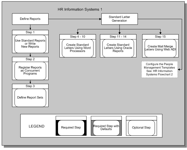

A number of standard reports are supplied with Oracle HRMS. These reports have been written using Oracle Reports V.2 and registered as concurrent programs with the Standard Requests Submission (SRS) feature of Oracle Applications.
You can use these Standard Reports or write your own reports and register these as additional reports which users can request from the Submit a New Request window.
In the UK, P45 and Pay Advice reports supplied with Oracle Payroll are designed for use with preprinted stationery. These reports use two special printer drivers to control the print format.
P45 - paygbp45.prt
Pay Advice -paygbsoe.prt
If your printer does not accept the same control characters as the DEC LN03 printer, you may need to modify the special SRW driver files.
When you install Oracle Payroll the two sample files are stored in the $PAY_TOP/srw directory. You should copy the files to $FND_TOP/$APPLREP and then register them using the Printer Drivers window.
After you have written your new reports and saved them in the correct subdirectory, you must register the report as a concurrent program. You also register the parameters which can be submitted with the report. For example, you may have written a report to display personal details and you want to submit employee name to limit the output to include one person at a time.
Use the Concurrent Programs window.
See: Concurrent Programs Window, Oracle E-Business Suite Setup Guide
You can define sets of Reports:
To restrict user access to specific reports.
A set of reports can be linked to a Responsibility.
To simplify requesting a report
You can run a report set in one request, rather than a request for each report.
Use the Request Set window.

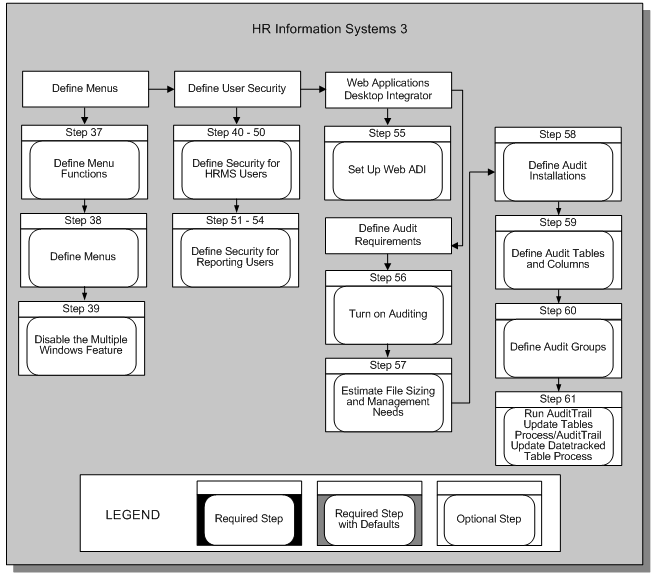

Menus are composed of submenus and functions and all Oracle Applications are supplied with default functions and menus to give you access to all of the available windows.
Warning: You should not modify the default functions and menus supplied with the system. On upgrade, these defaults will be overwritten.
If you want to add window configuration options or task flows you should define your own menus.
Use the Form Functions window.
See: Defining Menu Functions, Oracle HRMS Configuring, Reporting, and System Administration Guide
The supplied menus give you access to all of the available submenus. However, a number of seeded functions are not enabled on these menus. You need to add them for the responsibilities that should have access to these functions:

Important: You must disable this feature on menu structures that access Oracle HRMS windows.
See: Disabling Multiple Windows, Oracle HRMS Configuring, Reporting, and System Administration Guide
Any system that holds human resource and payroll information must be secured against unauthorized access. To reach employee information you need the correct security clearance.
The responsibility for defining and maintaining the internal security of your system is usually given to your system administrator.
Defining the access limits of each user is a multi-stage process which defines which records a user can see and which forms and windows they can see and use.
There are two security models to enable you to set up the right type of security for your enterprise:
Standard HRMS security model
Set up standard security if your enterprise sets up a different responsibility for each business group.
Use Security Groups Enabled security if your enterprise wants to enable many business groups for one responsibility. This type of security is most commonly used by Service Centers.
See: Defining Security for HRMS Users
You can also create reporting users who have read only access to data. This can be useful if you want to permit access to the data from another system.
See: Defining Security for Reporting Users
If you are using Standard HRMS security, ensure that the Enable Security Groups profile option is set to No at site and application level.
If you are using Security Groups Enabled security, ensure that the Enable Security Groups profile option is set to Yes at the application level.
Important: Once you have changed to Security Groups Enabled Security you cannot revert to the Standard Security model.
Use the System Profiles Value window
If you are using the Security Groups Enabled model, you must run the Enable Multiple Security Group process to set up Oracle HRMS to use security groups.
Use the Security Profile window (to give access to a single business group) or the Global Security Profile window (to allow users to access records from more than one business group).
This is required for the responsibility. For menu functions calling configured forms or task flows, you must enter a parameter in the Parameter field of the Form Functions window.
You can define the groups of standard reports and processes that a user can run from the Submit a New Request window. Every responsibility can have access to one request group.
Use the Request Group window.
See: Request Groups Window, Oracle E-Business Suite Setup Guide
You need to define a responsibility.
Use the Responsibilities window.
See: Responsibilities Window, Oracle E-Business Suite Security Guide
Set the HR User Profile Options for the new responsibility.
You must set up the following:
HR: User Type
Use this profile option to limit field access on windows shared between Oracle Human Resources and Oracle Payroll.
HR:Cross Business Group
Set this profile option to Yes if you want users to be able to view some information across all business groups in your enterprise.
For details of the information you can make available to users across business groups, see User Profiles, Oracle HRMS Configuring, Reporting, and System Administration Guide
If you are using the Standard Security model, enter the security profile for the responsibility. This must be set up at responsibility level, otherwise the default view-all security profile is used. Using Standard HRMS security you can only set up one security profile for a responsibility.
If you are using the Security Groups Enabled security model, do not set up or amend the HR: Security Profile option using the System Profile Values window. To set up or change this profile option use the Assign Security Profile window.
You can set also set up other User Profile Options.
Oracle Applications Help for HRMS defaults to Global help, but you can associate a responsibility with a set of help files for a localization, such as Canada, US or UK, or for a verticalization such as Oracle Federal HRMS. You do this by setting the user profile Help_Localization_Code.
In addition to associating a responsibility with a localization or a verticalization you can also specify that a particular responsibility should have access to a configured subset of the localized or verticalized help files.
See: Customizing Oracle E-Business Suite Help, Oracle E-Business Suite Setup Guide
If you are using the Standard Security model, you need to create usernames and passwords and link responsibilities to users.
If you are using the Security Groups Enabled security model, you need to create usernames and passwords. Do not link responsibilities and security groups (business groups) to users in the Users window for HRMS; instead, use the HRMS Assign Security Profile window.
Important: If you do enter a responsibility and security group in this window when using Security Groups Enabled security, you still need to use the Assign Security Profile window, to link your user to a responsibility and security profile. If you do not use the Assign Security Profile window, the default view-all security profile is used and your user will be able to see all records in the business group.
Use the Users window.
See: Users Window, Oracle E-Business Suite Security Guide
If you are using the Security Groups Enabled model, associate a security profile with a user, responsibility and business group.
Important: You cannot use the HRMS Assign Security Profile window to link responsibilities to users if you are setting up Standard Security.
Oracle HRMS uses the Security List Maintenance process to generate the lists of organizations, positions, payrolls, employees, contingent workers, and applicants that each security profile can access.
Important: When you initiate the Security List Maintenance process you must enter the resubmission interval to run the process every night
You must do this so that the system will automatically update the lists with the data changes you make every day.
If a power or computer failure should disrupt this process, you can initiate it manually from the Submit a New Request window.
When this process has completed successfully you can sign on to the system using the new username and responsibility.

To turn on Auditing, set the AuditTrail:Activate profile option to Yes at Site or Application level.
Turning Audit on has no noticeable effect on the performance of the system and users will not be aware of any extra delay in committing their transactions.
Whenever you choose to audit the actions of users of the system you are deciding to keep the details of all the transactions which take place. This will include before and after details as well as the details of who made the change and when.
Warning: In normal use the auditing of data can soon generate large volumes of audit data, which even when stored in a compressed format will continue to grow in size until you reach the limits imposed by your environment. If you reach the limits during active use then users will be unable to use the system until you remedy the problem.
You are strongly advised to consider the scope of your audit activities and how you will use the data you accumulate. Also you should consider how often you will report on the audit data, and when you will archive and purge your audit data.
If you need more advice on this you should contact your Oracle Support representative.
If you have installed more than one Oracle Application you can audit across multiple installations. For Oracle HRMS you should enable auditing for the HR user and the APPLSYS user.
Use the Audit Installations window.
See: Audit Installations Window, Oracle E-Business Suite Security Guide
With Oracle Applications you can define the level of detail you want to audit. You define the individual fields of each record that you want to audit.
Query the Table you want to audit
Enter the columns you want to audit for that table
Use the Audit Tables window.
See:Audit Tables Window, Oracle E-Business Suite Security Guide
You can define one or more Audit Groups for your installation. You might find this useful if you have more than one Oracle Application installed.
Use the Audit Groups window.
See: Audit Groups Window, Oracle E-Business Suite Security Guide
To start the AuditTrail activity you must submit the AuditTrail Update Tables Process for all tables, and the AuditTrail Update Datetracked Tables Process for all datetracked tables.
