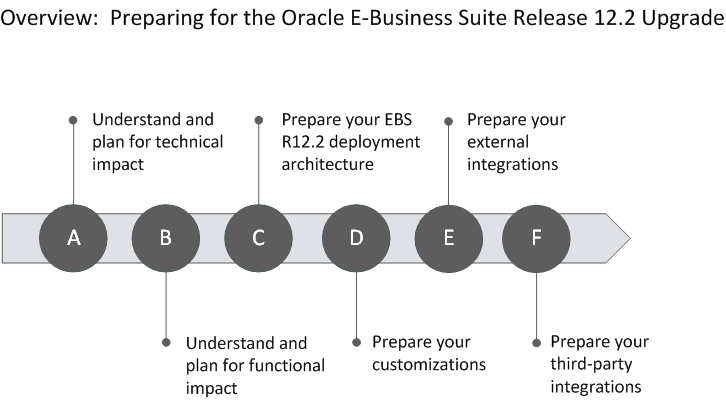

This guide contains information regarding technical and functional impact and changes due to the upgrade. It is very important that your DBA and your functional specialists work together to review this information carefully as a part of upgrade planning. Doing so will help to prevent unexpected delays during and after the upgrade.
There are a number of tasks that must be performed prior to starting the upgrade. Use the following chapters in this guide to help you plan and prepare for upgrade:
Understanding Upgrade Impact and Changes
Planning and Performing Pre-Upgrade Tasks
The following diagram illustrates the high-level overview of the tasks described in this guide:
