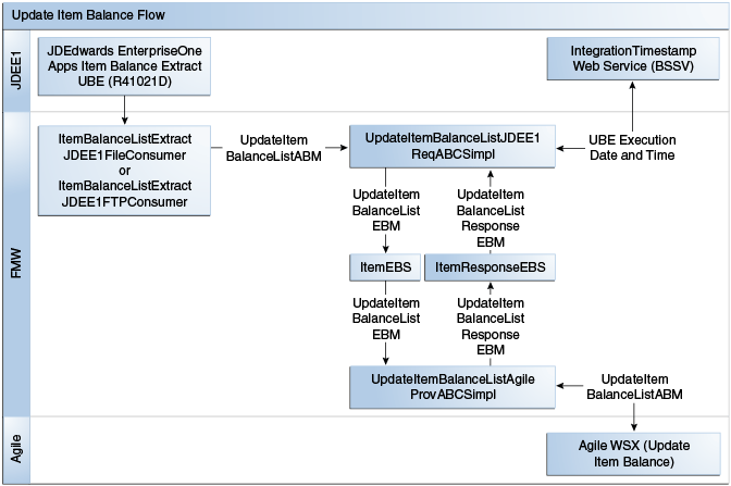

Figure 4-1 illustrates the update item balance flow from JD Edwards EnterpriseOne to Agile PLM:
Figure 4-1 Update item balance integration flow
This image is described in surrounding text
Update item balance process flow includes the following steps:
  1. The requester ABCS, defined as an asynchronous process, receives a list of ABMs from the JD Edwards EnterpriseOne UBE batch extracts.
    The list contains ABMs that have update_date greater than the last_successful_run_date of the batch program.
  2. The requester BPEL process filters the list of ABMs based on the ID to a list of ABMs those IDs are present in the cross-reference tables in the Fusion Middleware (FMW) layer
    This provides a list of items that were from Agile PLM. The original list of ABMs may also contain ABMs from non-Agile PLM sources as well.
  3. The BPEL process then makes a Mediator call out for end-point virtualization.
  4. A transformation converts the ABM to an EBM.
  5. An asynchronous request-delayed response call is made to the ItemBalanceEBS with the UpdateItemBalanceListEBM.
  6. The BPEL instance is invoked when the asynchronous call gets back from the provider and provides the status of the transaction back to the caller.
    Performance is not affected because it is a scheduled call and is invoked by server not by a user.
  7. The concurrent program logs the status of this call.
4.2.1 Item Balance Update Orchestration
Table 4-1 lists the activities involved in item balance update orchestration:
Table 4-1 Activities Related to Item Balance Update Orchestration
Step Activity Remarks
1
Run R41021D to export items
This activity occurs when you update item balance-related information in JD Edwards EnterpriseOne
2
ItemBalanceListExtractJDEE1FTPConsumer or ItemBalanceListExtractJDEE1FileConsumer reads and debatches the file
The system triggers ItemBalanceListExtractJDEE1Consumer
3
The system triggers an Oracle item balance action
An Oracle item balance action invokes UpdateItemBalanceListJDEE1ReqABCSImpl
4
UpdateItemBalanceListJDEE1ReqABCSImpl invokes ItemBalanceEBS
An invoke activity in UpdateItemBalanceListJDEE1ReqABCSImpl invokes the UpdateItemBalanceList operation on ItemBalanceEBS with UpdateItemBalanceListEBM as input
5
ItemBalanceEBS invokes UpdateItemBalanceListAgileProvABCSImpl
ItemBalanceEBS sends UpdateItemBalanceListEBM as input to UpdateItemBalanceListAgileProvABCSImpl
6
UpdateItemBalanceListAgileProvABCSImpl invokes the Agile PLM item balance web service
UpdateItemBalanceListAgileProvABCSImpl transforms the UpdateItemBalanceListEBM to AgileUpdateItemListABM and invokes the UpdateItem service operation on the Agile web service to update item on-hand quantity information from Oracle to Agile PLM.
Note: The UpdateItemBalanceListAgileProvABCSImpl composite uses the oracle/wss_http_token_client_policy client security policy while calling the ItemABS service hosted on the Agile server. The security credentials for this are stored in the csf-key AgileWebServicesKey on Fusion Middleware (FMW). The Agile username and password must be setup correctly so that the Agile service is invoked successfully from the AIA composite in the FMW layer.
The system returns AgileUpdateItemListResponseABM to UpdateItemBalanceListAgileProvABCSImpl.
7
UpdateItemBalanceListAgileProvABCSImpl sends a response back to ItemBalanceResponseEBS
UpdateItemBalanceListAgileProvABCSImpl transforms AgileUpdateItemListResponseABM to UpdateItemBalanceListResponseEBM and returns it to ItemBalanceResponseEBS
8
ItemBalanceResponseEBS sends the UpdateItemBalanceListResponseEBM to UpdateItemBalanceListJDEE1ReqABCSImpl
