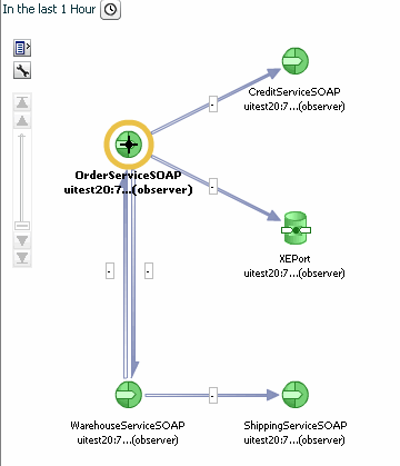

A map is a good way to represent relationships; maps provide a visual representation of how services, endpoints, or operations are related.
To view all services and their dependencies, select Maps > Service Map from the navigator.
To view containers, select Maps > Container Map from the navigator.
To view dependencies between a subset of related services, endpoints, or operations, select the object of interest and click the Dependency tab.
To view dependencies between the operations that make up a transaction, select the transaction and click the Summary tab.
The following figure shows a map that presents endpoint dependencies.
Because map views focus on relationships, Business Transaction Management attempts to present as clean a picture as possible so as not to obscure these relationships. Additional information is usually available if you move the cursor over the links that connect objects or if you hover over the object itself. In this case, hovering over an endpoint icon displays information about the endpoint's container, service, and core instrument values.

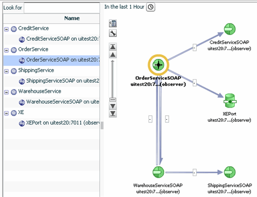

If you click the table icon in any map view, Business Transaction Management displays the corresponding inventory in a table to the left of the map.
The tabular tree view allows you to see one or more layers above or below the objects shown in the graphic. Note the shallow filter at the top of the display; you can use this to further filter the contents of the table.
To close the tabular tree view, click the table icon again.

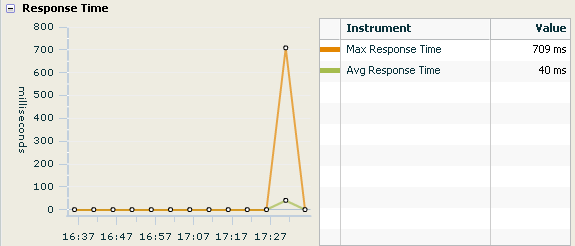

Charts provide a graphic presentation of how instrument values change over time. The following chart displays the response time for a transaction. The chart is accompanied by a table that serves both as a key and as a tabular presentation of the charted data. You can get more information from charts by passing the cursor over the graphed instrument values. As you pass the cursor over the nodes in the chart, Business Transaction Management displays instrument values for the point in time associated with that node.
