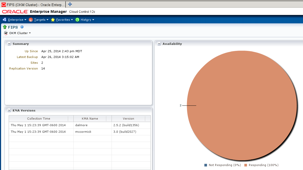

You access the OEM through a web browser. After you deploy the plug-in, the Oracle Enterprise Manager Cloud Control administrator can view information about the OKM cluster within OEM.
Figure 2-1 shows a summary of the OKM Cluster.

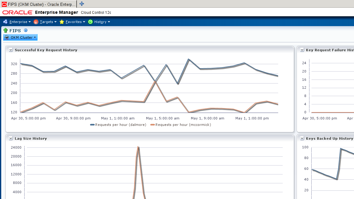

Figure 2-2 shows OKM Agent performance information.

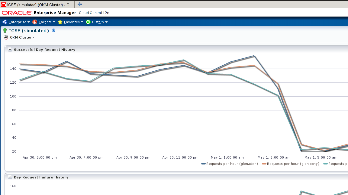

Figure 2-3 shows KMA performance information.

The most common use of the Oracle Enterprise Manager Cloud Control Plug-in (besides simple capacity monitoring and high-level information collection) is analysis of application performance degradation. Using Oracle Enterprise Manager Cloud Control, you can provide information to the OKM administrator related to performance degradation in the OKM cluster.
In the event of a resource contention issue, you can study levels of client access to determine how and when individual clients are accessing a KMA in the OKM cluster, along with the resources they are accessing.
The plug-in shows a history of security violations, which OKM agents (such as tape drives) are accessing which KMAs the most, and availability history (for example, if a KMA goes down frequently). If an Oracle database or a Solaris 11 server is an OKM client and starts getting failures, then this plug-in can report these failures.
