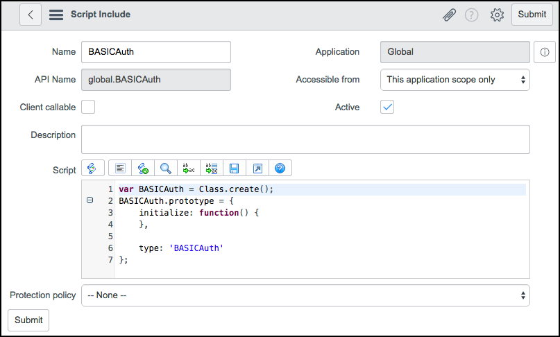

Click the blue New button on the Script Includes menu bar. The following window will appear (Figure 3-2):

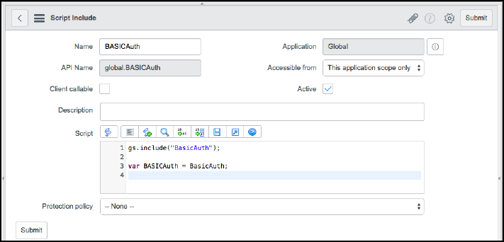

In the Name field, enter BASICAuth as the Name (using exact capitalization as shown in Figure 3-3):
Replace the contents of the Script field with the following as shown in Figure 3-4:
gs.include("BasicAuth"); var BASICAuth = BasicAuth;
Click Submit.

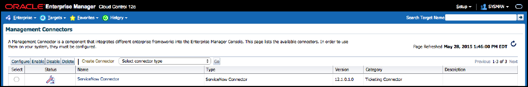

The connector instance appears as unconfigured in the Connector Setup page as shown in Figure 3-5:

As Super Administrator from the Enterprise Manager Setup menu, select Extensibility, and then select Management Connectors. The Management Connectors page appears and lists all created connector instances.

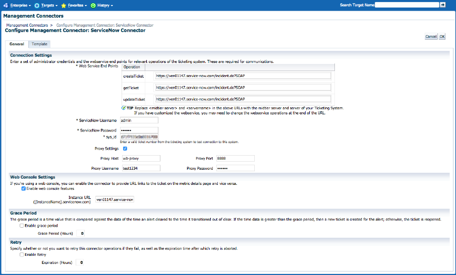

The status column with a green check mark indicates that the connector is already configured. The pink wrench icon indicates that the connector is not yet configured.Click the name of the connector you want to configure. The General tab of the Configure Management Connector page appears as shown in Figure 3-6:
Provide the required settings as described below, then click OK:
Web Service End Points - URL of the web service end-point to call for the createTicket
, updateTicket
, and getTicket
operations. The ServiceNow web service URL is formatted as shown below:
https://[InstanceName].service-now.com
In most cases, you will just need to replace [InstanceName]
with the host name or IP address of the server where the web service is located.
ServiceNow Username - Specify the user name supported by the ServiceNow web services. This user name must have the appropriate privileges/roles in ServiceNow (see Table 5-1 for details) to create, update, and query tickets in ServiceNow. All tickets created through the connector are generated with this user account.
It is recommended to use a service account for the ServiceNow Connector operations.ServiceNow Password - Specify the password associated with the user specified in the ServiceNow Username field.

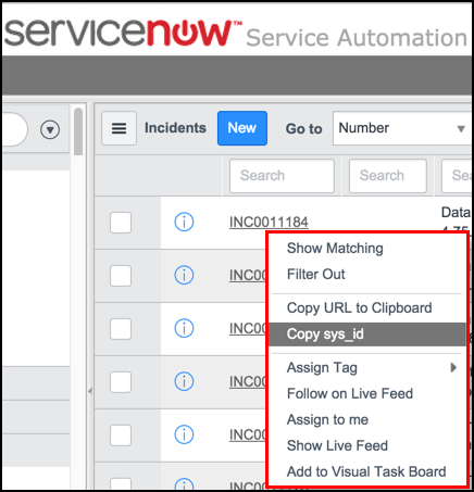

sys_id - Enter a sys_id
number to test the connection when you save the configuration. A valid sys_id
can be obtained by right clicking on any open ServiceNow incident and selecting Copy sys_id, as shown in Figure 3-7:

This section is used to configure the connector to send requests to a proxy server and will only be present if the proxy patch has been applied. See Prerequisites for information on the proxy patch.If your enterprise requires a proxy server for all communication between Enterprise Manager and ServiceNow, check the Proxy Settings check box to enable the proxy fields and specify the following proxy server settings:
Proxy Host - The host name of the proxy server.
Proxy Port - The port number of the proxy server.
Specify the following proxy credential fields if required by your proxy server.
Proxy Name - The user name to specify when calling the proxy server.
Proxy Password - The password to specify when calling the proxy server.
Web Console settings are required if you want the Connector to provide links to ServiceNow tickets created by Enterprise Manager in the context of an incident.To enable this functionality, provide the following Web console settings:
Enable web console - Check this box to enable launching of the ServiceNow ticket page within context from Enterprise Manager.
Instance URL - Specifies Web server information the connector uses to connect to the ServiceNow web service when accessing incidents in ServiceNow. Use the format shown in the example URL in Web Console Settings and replace [InstanceName]
with the name of your instance. If your ServiceNow instance is configured with a web proxy, then enter the proxy URL.
You can enable and disable the grace period and configure its value. By default, the grace period is disabled.
This setting applies to all incidents the ServiceNow processes. The grace period interval accepts the number of hours as any integer value. For example, 1 or 2.
For more information on this setting, see Grace Period Setting.
You can enable and disable the Retry option and configure its interval value. By default, the Retry is disabled.
This setting applies to all incidents the ServiceNow Connector processes. The retry period interval accepts the number of hours as any integer value. For example, 1 or 2.
For more information on this setting, see Retry.
