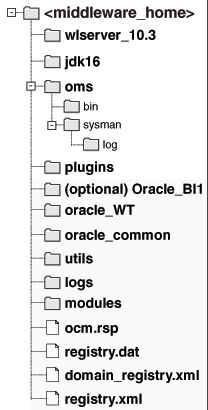

Figure A-1 shows some of the important directories you should be familiar with in a typical Cloud Control installation. You can use this information as you begin to maintain, troubleshoot, and configure the Oracle Management Service installation.
Table A-1 Directories Installed with Enterprise Manager
| Directory | Description |
wlserver_10.3, logs, utils, modules |
These directories contain Fusion Middleware files. |
jdk16 |
This directory contains JDK configuration files. |
oms |
This directory contains OMS configuration files. For more information, see Section 10.2.2. |
plugins |
This directory contains metadata plug-ins configuration files installed on the OMS. |
agent |
This directory contains agent configuration files. |
[optional] Oracle_BI1 |
This directory contains the Oracle Business Intelligence Publisher configuration files. |
oracle_WT |
This directory contains Oracle WebTier configuration files. |
oracle_common |
This directory contains common files used by OMS, Oracle WebTier, and WebLogic Server directories. |

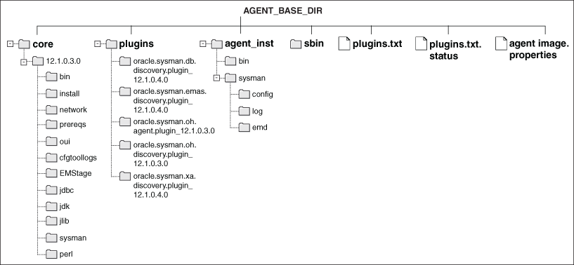

Specifically, the Oracle Management Agent files are installed into the same directory structure shown in the agent directory when you install the Oracle Management Service (Figure A-1).
The agent directory structure, when you install a standalone agent or install the OMS is the same. The AGENT_BASE_DIR is the directory where agent is installed and contains the following main directories:
AGENT_HOME
AGENT_INSTANCE_HOME
SBIN_HOME
PLUGIN_HOME
The directory that contains the files required to run the Oracle Management Agent is referred to as the AGENT_INSTANCE_HOME directory. For example, to start or stop an Oracle Management Agent, you use the emctl command located in the bin directory of the AGENT_INSTANCE_HOME. Similarly, to configure files for the Oracle Management Agent, you modify the configuration files in the sysman/config directory of the AGENT_INSTANCE_HOME. See Figure A-2 for the agent directory structure.
