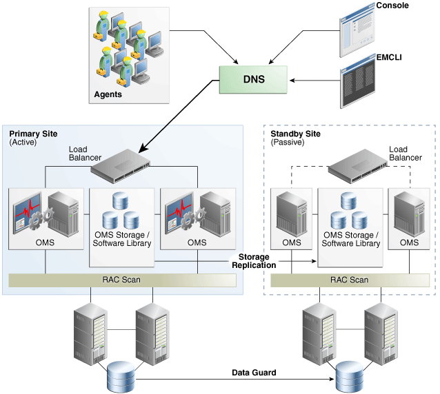

The Disaster Recovery solution for a Cloud Control deployment involves replication of the OMS, Software Library and Repository components at a standby site. This solution can be combined with the high availability solution described in the previous chapter to ensure that failures ranging from component failure to a complete site outage can be recovered from with minimal disruption to the availability of Cloud Control.
A complete implementation of the Enterprise Manager Cloud Control combining the High Availability design from the previous chapter with the Disaster Recovery described in this chapter solution is shown in the following figure.
Key aspects of the DR solution shown in the figure are:
The solution has two sites. The Primary Site is running and active, while the Standby Site is in passive mode.
The traffic from the Enterprise Manager users and Agents is directed to the Primary Site by a Global Load Balancer or a DNS entry that resolves to an IP address hosted at the Primary Site.
The Standby Site is similar to the Primary Site in terms of hardware and network resources which ensures there will be no loss of performance when failover happens.
It is not necessary to perform an OMS installation at the Standby Site. Oracle Inventory, OMS Software, Agent and Software Library and all located on replicated storage. When the Production Site storage is replicated at the Standby Site the equivalent data are written to the Standby Site
The OMS hostnames must resolve to the IP addresses of the Primary OMSs when queried from the Primary Site and to the IP addresses of the corresponding standby hosts when queried from the Standby Site.

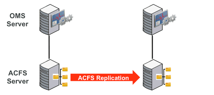

OMS software, Oracle Inventory, Software Library and Agent binaries and configuration files for all OMS(s) are on replicated storage.
OMS hosts on each site access the replicated storage using the same mount points
Replication between the sites takes place should take place at regular scheduled intervals and following configuration changes.
Oracle Data Guard Physical Standby is used to replicate the Repository database at the standby site.
There must be sufficient network bandwidth between the primary and standby sites to handle peak redo data generation.
When there is a failure or planned outage of the Primary Site, you perform the following steps to enable the Standby Site to assume the Primary role in the topology:
Stop OMSs at the primary site
Perform on-demand replication of storage (if primary site is available)
Failover/switchover of the database to the standby site
Reverse storage replication and activate replicated storage read/write at standby site
Start OMSs at standby site
Update DNS or global load balancer to re-route user requests to the standby site. At this point, the standby site has assumed the production role.

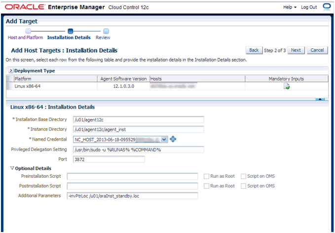

When the starting point is an existing primary site, the OMS installation for the primary site already exist on the file system. Also, the host names, ports, and user accounts are already defined. The following procedure must be used to transform the site and prepare it for Disaster Recovery topology.
Review the Network Considerations and plan your host names
If using option 1, no host name changes are required on the primary site. Prepare your standby site hosts by adding appropriate alias host names.
If using option 2, change the OMS host name to move your existing OMS installation to use alias host names. Prepare your standby site hosts by adding the appropriate alias host names.
Review the Storage Considerations and move your OMS installation to shared storage

The Disaster Recovery solution for a Cloud Control deployment involves installing the Software Library, OMS installation, Agent installation and Oracle inventory on replicated filesystem. This solution can also involve configuring BI Publisher shared storage.
Standby OMSs implemented using Standby WebLogic Domain are still supported but have been deprecated and may be desupported in a future release (see My Oracle Support Note 1563541.1 for details). The recommended method for creating Standby OMSs is to use storage replication as documented in this chapter. Creating standby OMSs using a Standby WebLogic Domain is documented in Appendix I, "Standby OMSs Using Standby WebLogic Domain."
Storage Replication Requirements
Your chosen method of storage replication should support the following:
Snapshots and consistent filesystem copies
Ability to perform an on-demand replication between sites

Configure the storage replication schedule for as frequently as the network infrastructure will allow (minimum every 24 hours).
Refer to your storage/network documentation to determine a replication schedule that maximizes the resource utilization performance of your network infrastructure.Move HTTP Lock files to local filesystem. See the Enterprise Manager Cloud Control Advanced Installation and Configuration Guide for more information.

The Agents deployed to the standby OMS hosts should not use the replicated Oracle Inventory. They should be installed using a local inventory that does not include the replicated OMS and Agent installs.
The Agents deployed to the standby OMS hosts should be deployed on a different port to that used by the replicated Agents. This will avoid port conflicts when the replicated OMS and Agent are started on the standby OMS host.
Regardless of which network topology is used (aliases at both sites or aliases only at the standby site), these Agents should be deployed using the physical hostnames of the standby OMS hosts.
These Agents should be deployed into a separate inventory so that they are kept apart from the inventory used for the OMS installation.
After deploying Agents to the standby OMS hosts, confirm that all OMS Agents (those installed with alias host names on replicated storage and those installed with physical host names on local storage) are configured consistently with the same time zone. See Changing the Management Agent Time Zone in the Enterprise Manager Cloud Control Administrator's Guide for details on changing the agent time zone.
To specify an inventory location for Agent installation, an inventory pointer file can be created and the -invPtrLoc flag can be used during installation.
The following example shows an inventory pointer file that specifies the inventory location as /u01/oraInventory_standby
more /u01/oraInst_standby.loc inventory_loc=/u01/oraInventory_standbyinst_group=dba
The -invPtrLoc flag can then be passed during Agent installation.

Configuring ACFS Replication
Install Grid Infrastructure and create an ACFS Server.
ACFS storage replication requires Grid Infrastructure to be installed for a Cluster, but it can also be installed using a single node (one node cluster).
Create an ACFS file system on the ACFS server (created in step 1) to be used for the OMS installation and Software Library.
Export the ACFS file system using NFS.
Disable root squash for the ACFS mount point, otherwise root.sh will not run after Enterprise Manager is installed on the client.

Create a second ACFS server (one node cluster) with another ACFS file system to be used as a standby.
Establish ACFS replication between the primary and standby ACFS servers:
On the standby server, initiate the replication using the following command:
/sbin/acfsutil repl init standby -p
by the root user.
Verify that the standby file system is initiated using the following command:
/sbin/acfsutil repl info
On the primary server, initiate replication using the following command:
/sbin/acfsutil repl init primary -s
Verify that the primary file system is initiated using the following command:
/sbin/acfsutil repl info -c
