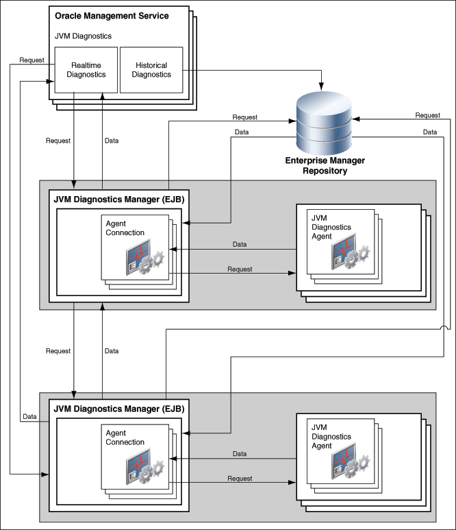

JVM Diagnostics is integrated with Oracle Enterprise Manager Cloud Control. It primarily enables administrators to diagnose performance problems in Java applications in the production environment. By eliminating the need to reproduce problems, it reduces the time required to resolve these problems, thus improving application availability and performance. Using JVMD, administrators can identify the root cause of performance problems in the production environment, without having to reproduce them in the test or development environment.
The following diagram shows the JVMD Architecture:
JVMD Engine is the core analytical engine of the JVMD monitoring system. JVMD Engine collects runtime data from JVMD Agents on request from the OMS, and stores the data in the repository. Multiple JVMD Engines can be configured.
JVMD Agents are the data collectors of the target JVM. JVMD Agents are deployed to managed application servers to collect JVM monitoring data related to JVM threads, stacks, heap and CPU usage, and so on, in real-time, while introducing minimal overhead.
The JVMD Engine runs as an Enterprise JavaBeans (EJB) technology on a WebLogic Server. The JVMD Agent is deployed on the targeted JVM (the one running a production WebLogic Server). It collects real-time data and transmits it to the JVM Diagnostics Engine. This data is stored in the Management Repository, and the collected information is displayed on the Enterprise Manager Cloud Control console for monitoring purposes. The communication between JVMD Engine and JVMD Agent can be secure (SSL), or non-secure.

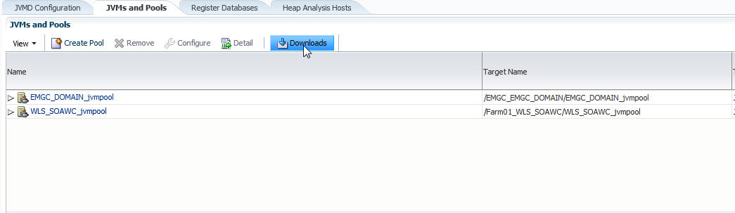

On the JVM Diagnostics Setup page, click JVMs and Pools, then click Download. The Download JVM Diagnostics Component dialog box appears.

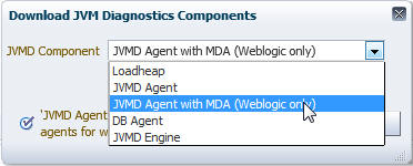

From the JVMD Component menu, to download javadiagnosticagent.ear, select JVMD Agent with MDA (Weblogic only), then click OK. To download jamagent.war, from the JVMD Component menu, select JVMD Agent, then click OK. The JVM Diagnostics Agent web.xml parameters dialog box appears.

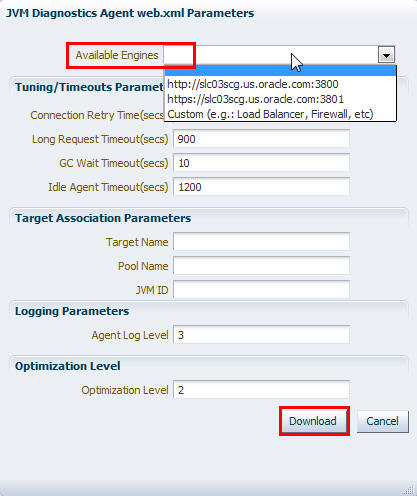

When the JVM Diagnostics Agent web.xml parameters dialog box is displayed, from the Available Engines menu, select Custom. Provide the load balancer host name and port.
Click Download.
