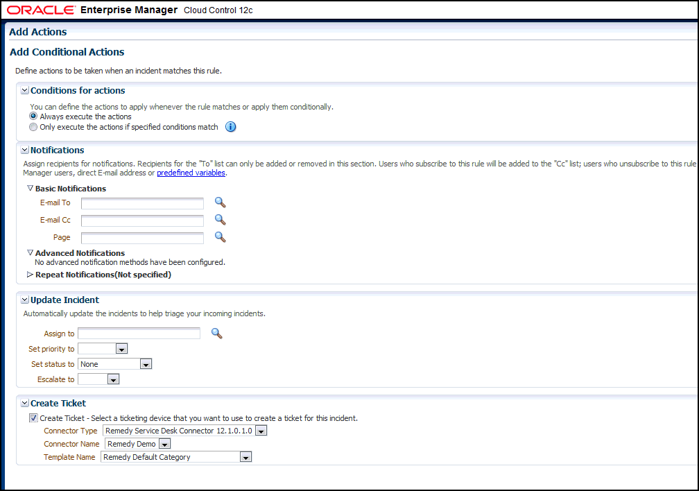

  4. While configuring the above rule under the Add Actions page:
    • For events —
      Select the Create Incident check box. This makes the Create Ticket option visible. Then, select the Create Ticket check box. It will display the combo box to select Connector Type, name, and template.
    • For incidents —
      You can use this option to create tickets based on incident attributes, such as priority 1 incidents or incidents based on fatal or critical severity.
      Select the Create Ticket check box. It will display the combo box to select Connector Type, name, and template.
    Figure 3-1 shows the Add Actions page for events, and Figure 3-2 shows the Add Actions page for incidents.
    Figure 3-1 Add Actions Page for Events
    Shows Remedy Default Category Auto Resolve selected from Template Name list.
    Figure 3-2 Add Actions Page for Incidents
    Shows default settings for page.
  5. After selecting an appropriate connector and template, click Save.

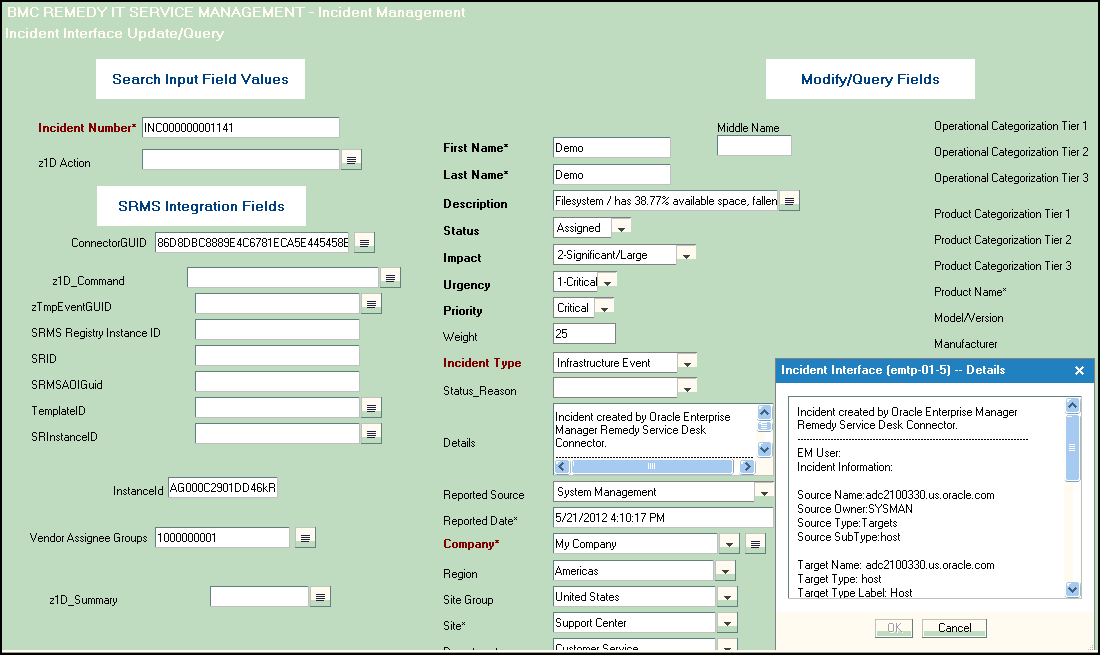

Figure 3-4 Remedy Console Ticket
Shows ticket with sample input.

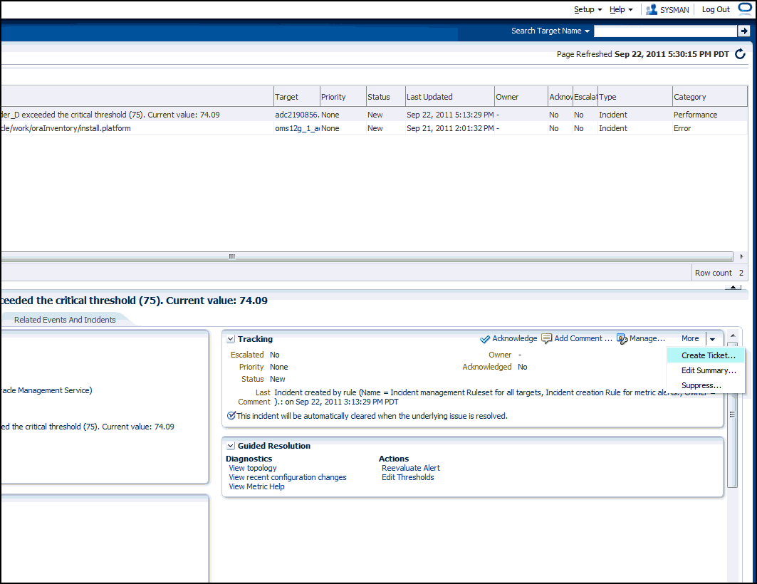

3.2 Manually Creating a Ticket
Perform the following steps to manually create a ticket:
  1. From the Enterprise menu of the Enterprise Manager console, select Monitoring, then Incident Manager.
    The Incident Manager page appears, showing all open incidents.
  2. Select any incident from the list in the table.
  3. In the Tracking section, click More, then Create Ticket, as shown in Figure 3-5.
    Figure 3-5 Tracking Section of Incident Manager
    Shows Create Ticket selected from menu in right lower part of page.

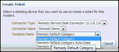

  4. In the Create Ticket pop-up window, select a ticket template from the Template Name drop-down menu as shown in Figure 3-6, then click OK.
    If you do not see the desired template, you can add one using the emctl command. See Section 2.7.1, "Adding Ticket Templates".
    Figure 3-6 Create Ticket Pop-up Window
    Shows Remedy Default Category selected from Template Name list.
If creating ticket is successful, the ticket ID appears in the tracking section for the incident. If the Web console settings are configured and enabled, the ticket ID appears as a link to the ticket page in the Remedy Service Desk.
