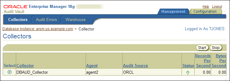

To start the collectors from the Audit Vault Console:
Log in to the Audit Vault Console as a user who has been granted the AV_ADMIN role.
See Section 3.2.3 for login instructions.
Click the Management tab, then Collectors to display the Collectors page.
The Collectors page appears with a table containing the following columns.
Collector: Name of the collector
Agent: The name of the collection agent for this collector
Audit Source: The name of the audit data source
Status: The current running status of the collector: a green up arrow indicates that the collector is running, a red down arrow indicates that the collector is not running, an error indicates that the collector is in an error state
Records Per Second: The number of records per second being collected for the current time period
Bytes Per Second: The number of bytes per second in audit records being collected for the current time period
Select the collector that you want to start.
This page also indicates whether the collector is running. A green up arrow indicates the collector is running; a red down arrow indicates it is not running.
Click Start.
In a moment, a message indicating that the collector has started should appear.
Select the Management tab, and then select the Collectors tab.
In the Collectors page, check the list of collectors.
If the collector is running, its Status is set to an up arrow. If it is not, it is set to a red arrow pointing downward.
This page also lists the names of the agents associated with the collectors.
