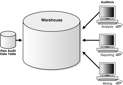

Figure 4-1 illustrates the Oracle Audit Vault audit data warehouse architecture. Audit Vault stores the audit records in the raw audit data table, which is typical of a traditional online transaction processing (OLTP) system that is optimized for insert performance for the records arriving from their audit sources.
Figure 4-1 Architecture of the Oracle Audit Vault Audit Data Warehouse
Audit records, stored in the raw audit data table go through an extraction and transformation process before the data loading process (ETL). The ETL operation takes place in the staging area. Oracle Audit Vault optimizes data in the data warehouse for data analysis, and includes the metadata and summaries that aid in these data analysis.
If you have been granted the AV_AUDITOR role, then you can directly access audit data in the audit data warehouse to analyze data, generate reports, and perform data mining. See Oracle Database Data Warehousing Guide for more information about Oracle data warehouses.

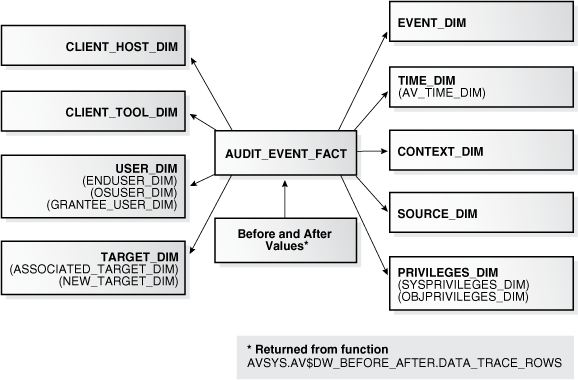

The audit data warehouse uses a logical design to model the logical relationships among the entities (tables) and their attributes (columns) as entity-relationship modeling. The audit record is the most important information, and it contains attributes or columns that describe it. Other information about the audit record is linked by foreign key to other tables that store this related information. This related information includes items such as its source information, its event information, its description of the objects in the source on which users performed actions, the client computer information from which these events originated, and the time when these events occurred. In data warehouse terminology, the audit record forms the fact table and its most important attributes form the dimension tables.

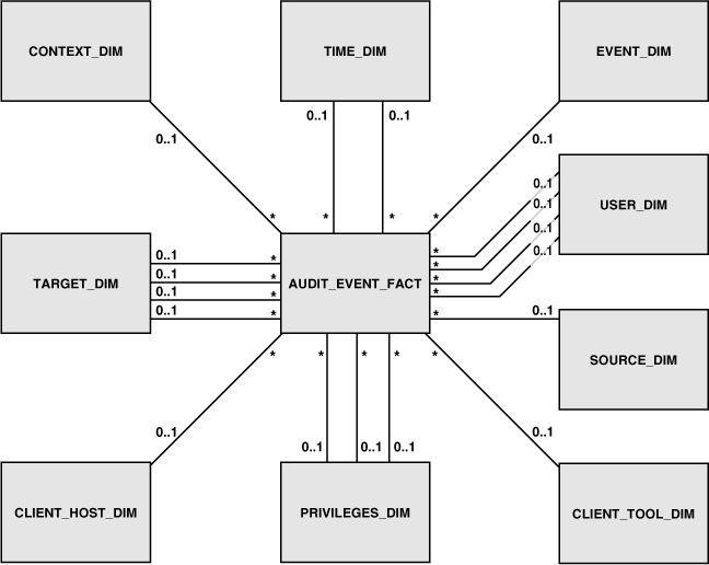

Figure 4-2 shows how Oracle Audit Vault uses a star schema to model the audit data warehouse. A star schema optimizes performance by keeping queries simple and providing fast response time. All the information about each level is stored in one row. For this star schema, the audit record is an entity (the fact table, AUDIT_EVENT_FACT) in the center of the star. The surrounding dimension tables describe the attributes of the AUDIT_EVENT_FACT fact table. If the audit records in the AUDIT_EVENT_FACT table have before and after values, then they can be accessed using the procedure described in "Accessing Data Trace Values".
Figure 4-2 Structure of the Oracle Audit Data Warehouse
The audit data warehouse involves a fact (the entity), which is an action, and dimensions (the attributes), which are details about the action. For example, a login attempt is a fact (an audit record). Who logged on, onto what system, at what time, using what authentication system, using what user name and password, and from what system are all dimensions (the attributes) about this fact. In the audit data warehouse, each fact represents an audit record and each dimension represents unique information about that audit record that further describes the audit record.
The fact table, AUDIT_EVENT_FACT, is linked to each dimension table by its foreign key. The fact table in the audit data warehouse contains the audit record ID, some attributes of the audit record for report generation, and the foreign keys to these dimensions. The main measure of the fact table is the result, whether a particular event was a success or failure.
A dimension is a structure, often composed of one or more hierarchies, that categorizes data to enable proper analysis of the data. Dimensions represent natural 1:n relationships between columns or column groups (the levels of a hierarchy) that cannot be represented with constraint conditions. Going up a level in the hierarchy is called rolling up the data, and going down a level in the hierarchy is called drilling down the data.
Level relationships specify top-to-bottom ordering of levels from most general (the root) to most specific information. They define the parent-child relationship between the levels in a hierarchy. A dimension hierarchy shows these level relationships. For example, the source dimension consists of two levels, source type and source, with the source being the child of its parent source type, as shown in Figure 4-3.
The primary key in the dimension tables is a unique identifier. Primary keys are represented with the characters PK. Foreign keys are represented by the characters FK.

You can include before and after values that have been collected from the Oracle redo logs in your data warehouse queries. To do so, use the AVSYS.AV$DW_BEFORE_AFTER PL/SQL package. Only users who have been granted the AV_AUDITOR role can invoke this package. This package contains one function, DATA_TRACE_ROWS, which is a pipelined table function that can create a virtual table listing before and after values from the redo log.
The syntax for the DATA_TRACE_ROWS function is as follows:
AV$DW_BEFORE_AFTER.DATA_TRACE_ROWS ( rec_id IN NUMBER, src_dim IN NUMBER, rec_time IN TIMESTAMP WITH LOCAL TIME ZONE) RETURN before_after_tab PIPELINED;
In this specification:
rec_id refers to the record ID number from in the RECORD_ID column in the AUDIT_EVENT_FACT table.
src_dim refers to the source dimension table number from the SOURCE_DIM column in the AUDIT_EVENT_FACT table.
rec_time refers to the time that the record was created in the Audit Vault repository, based on the local time zone. It comes from the AV_TIME column in the AUDIT_EVENT_FACT table.
Example 4-1 shows a query that uses the DATA_TRACE_ROWS function to include before and after values in a report similar to the Data Access Report you can access through the user interface."
Example 4-1 Using the DATA_TRACE_ROWS Function to Access Data Trace Values
select t.owner_name||'.'||t.target_name table_name, e.event_name, f.event_time, x.column_name, x.old_value, x.new_value from event_dim e, target_dim t, audit_event_fact f, table(av$dw_before_after.data_trace_rows(f.record_id, f.source_dim, f.av_time)) x where f.event_dim = e.dimension_key and f.target_dim = t.dimension_key and f.data_values_cnt > 0;
See Also:
Section 3.3.2.3 for information about the Data Access Report
