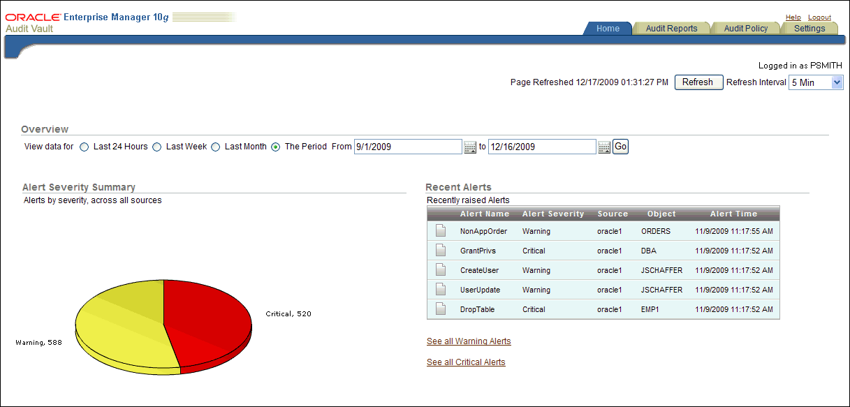

The Dashboard page appears and displays information about configured alerts and audit trail activity.
From the Dashboard page, you can do the following:
View audit data from a range of dates. To view the audit data, which includes data such as the top five objects accessed and failed logins, specify the range you want, and then click the Go button. To automatically refresh the data every 60 seconds, click the Refresh every 60 seconds check box, or manually refresh it by clicking the Refresh button.
Check alerts. The Dashboard page displays recently raised alerts, as well as all warning and critical alerts.
Check attestation actions. The Dashboard page displays a list of reports that you may need to attest.
