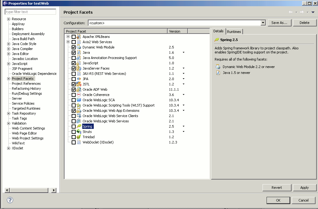

  1. Either add the Spring facet when you create a project, or add the facet to an existing project by right-clicking your project in the Project Explorer and selecting Properties from the drop-down menu. This will open the Properties dialog, as Figure 1 shows.

  2. In the Properties dialog, select Project Facets on the left panel, and then select Spring from the Project Facet list.

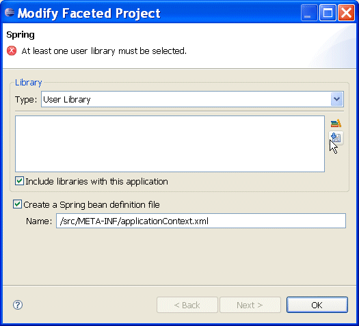

    To configure your project to use Spring Framework 2.5 Runtime library, select the Spring Framework 2.5 facet, and then click Further configuration required... link. This will open the Modify Faceted Project > Spring dialog, as Figure 2 shows. Notice that the example in Figure 2 demonstrates how to create a project using Spring 2.5.6 runtime bundled with Spring IDE.

    If you select either the Spring Framework 2.0 or 2.5 facet on the Properties dialog, and you wish to either use your own Spring runtime installation or download a copy of Spring libraries hosted by Oracle or SpringSource, select User Library in the Library Type field of the Modify Faceted Project > Spring dialog, as Figure 3 shows.
    Figure 3.
    Modify Spring Facet Dialog
    You can also click the Manage User Library icon to select a Java User Library pointing a proper local Spring runtime installation.

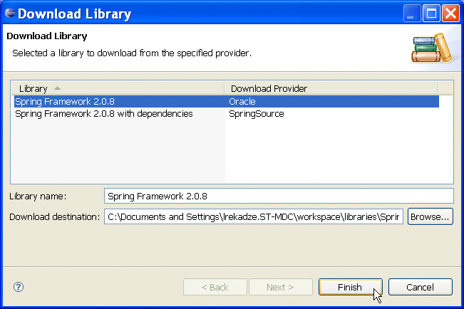

  3. Click Download Library icon to indicate your intention to obtain Spring libraries. This will open the Download Library dialog, as Figure 4 shows.
    Figure 4.
    Download Library Dialog
  4. To use this dialog to download the Spring libraries, make appropriate selections, and then click Finish to trigger the download.

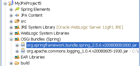

  7. By clicking Apply > OK on the Properties dialog, you will complete the configuration of the Spring Framework library for your project, as Figure 6 shows.
    Figure 6.
    Spring JAR in Project View

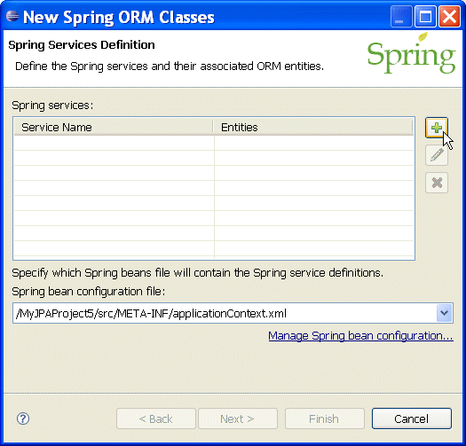

  1. To initiate the Spring artifact generation, right-click on the project name in the Project Explorer, and select New > Generate Spring ORM Classes from the drop-down menu. This will open the New Spring ORM Classes > Spring Services Definition wizard page, as Figure 7 shows.
    Figure 7.
    New Spring ORM Classes Wizard Page
    Notice that the Spring bean configuration file field has been filled in when you added the Spring facet to your project. If you wish to use another file, click Manage Spring bean configuration... link, and then make your selection.

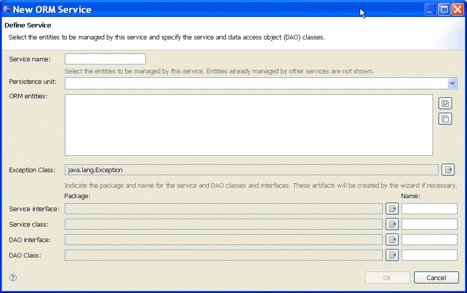

  2. Click Add icon on the New Spring ORM Classes > Spring Services Definition dialog. This will open the New ORM Service dialog, as Figure 8 shows.
    Figure 8.
    New ORM Service Dialog
  3. On the New ORM Service dialog, provide the following information:
    • Enter the service name.
    • Specify your project in the Persistence unit field. Note that you can select the persistence unit only when the service is created for the first time. Once created, you can add or remove entities from the existing persistence unit, but cannot switch to another persistence unit. To access another persistence unit, you create a new Spring Bean configuration and add a new service to it.
    • Select one or more entities from the ORM entities list.
    • Specify the exception that will be thrown by the service methods.
    • Provide the package information for the service and DAO classes and interfaces.
    • Specify the name for the service and DAO classes and interfaces (you may want to accept default values).
    Figure 9 shows the completed New ORM Service dialog.
    Figure 9.
    Completed New ORM Service Dialog
  4. Click OK to continue.
