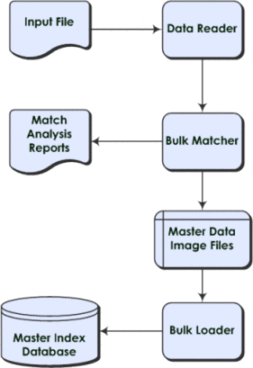

Performing an initial load of data into a master person index database consists of three primary steps. The first step is optional and consists of running the Bulk Matcher in report mode on a representative subset of the data you need to load. This provides you with valuable information about the duplicate and match threshold settings for the master person index application. Analyzing the data in this way is an iterative process. Based on the information from each run, you can modify the Bulk Matcher configuration file by changing the blocker query used for matching, the match string, and the duplicate and match thresholds. After you reconfigure the Bulk Matcher, rerun the analysis reports to verify the results. You can repeat this procedure as often as needed until you are satisfied with the match process settings. Once the configuration is finalized, make sure to modify the master person index application configuration files to match the Bulk Matcher configuration file.
The second step in the process is running the Bulk Matcher in matching mode. The Bulk Matcher processes the data according to the query, matching, and threshold rules defined in the Bulk Matcher configuration file. This step compares and matches records in the input data in order to reduce data duplication and to link records that are possible matches of one another. The output of this step is a master image of the data to be loaded into the master person index database. The final step in the process is loading the data into the master person index database. This can be done using either Oracle SQL*Loader or the command-line Bulk Loader. Both products can read the output of the Bulk Matcher and load the image into the database.
Figure 1-1 Initial Bulk Match and Load Tool Process Flow
Description of Figure 1-1 follows
Description of "Figure 1-1 Initial Bulk Match and Load Tool Process Flow"

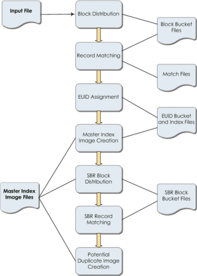

The Bulk Matcher performs the following sequence of tasks:
Figure 1-2 Bulk Matcher Internal Process
Description of Figure 1-2 follows
Description of "Figure 1-2 Bulk Matcher Internal Process"
Block distribution and EUID assignment are both handled by the master Bulk Matcher. Matching and master person index image generation are performed by all matchers. At any given time, all matchers perform the same task. When that task is complete for all matchers, they move on to the next task, obtaining the necessary files and information from the master Bulk Matcher. The cluster synchronizer (see "About the Cluster Synchronizer") determines when a task is complete and coordinates the tasks for all matchers.
Block Distribution
The master Bulk Matcher reads the input file and then writes records to block bucket files to be distributed to each matcher. Before writing the data, the block distributor reads the configuration of the query, match string, and duplicate and match thresholds. It then reads in the input data and writes the data to the block files based on the defined blocking query. The number of files created is dependent on the total number records, record size, and the memory of the processor. Once the data files are created for all blocks, the cluster synchronizer indicates that the matchers can begin the match process.
Record Matching
Once the input data is distributed into individual block buckets, each matcher retrieves a bucket and proceeds to compare each record to every other record in a block and assign a weight that indicates the probability that the records match. The matching logic used here is identical to the matching logic used by the master person index application. Any matches that are found during this process are written to a file. Once a matcher completes matching on a block bucket, the cluster synchronizer copies the match file to the master matcher's working directory.
EUID Assignment
When all blocks are matched, the master Bulk Matcher merges the match files from all the other matchers into one master match file. The master Bulk Matcher then assigns an EUID to the system records, assigning any records that are linked as matches to the same EUID. Once system records are assigned an EUID, they are distributed to EUID files. Any system records with the same EUID are stored in the same file. Once EUID assignment is complete, the cluster synchronizer indicates that the next phase, generating the master data images, can begin.
Master Person Index Image Creation
The master person index image generator reads from the EUID bucket files to create the master data image files to be loaded into the master person index database. These images include complete enterprise records with SBRs, system records, and child objects. The SBR is determined based on the survivor calculator defined for the master person index application. The image files also include assumed matches and transaction information. Each matcher processes one of the EUID buckets at a time until all buckets are processed.
Potential Duplicate Creation
The potential duplicate generator reads from the SBR bucket files created by the master person index generator and generates any potential duplicate linkages. The potential duplicate generator creates block buckets from the SBR records and matches the SBRs of each record. If two records have a matching weight that is above the duplicate threshold but below the match threshold, they are added to the potential duplicate table in the master person index image files. This table is loaded directly into the master person index sbyn_potentialduplicates table. Once the Bulk Matcher completes this phase, match processing is complete.
