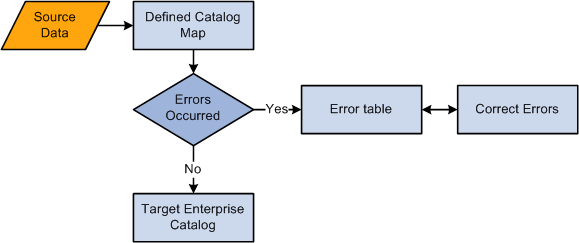

Understanding the Transformation and Loading Process
After a partner's offering data has been successfully imported into Catalog Management, it can be transformed into the enterprise catalog format and then loaded into the enterprise catalog.
The transformation of data is based on the catalog map that you defined for the partner's source file.
You can use three different methods to load offering data into the enterprise catalog:
Incremental update.
The system updates the most recently loaded data. Required changes are made to existing data, such as price changes, and new offering data is added.
Full load.
The system replaces the current data with the new data.
Error recycle only.
If errors occurred during a previous attempt, this is the only option available. The system uses the data in the corrected error table as the source data.
The following diagram illustrates the transformation and loading process of source data to the target enterprise catalog.
Transformation and loading of source data
