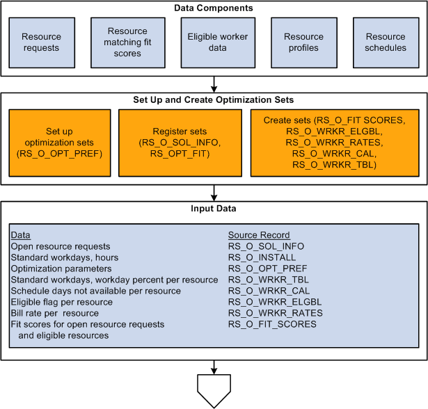

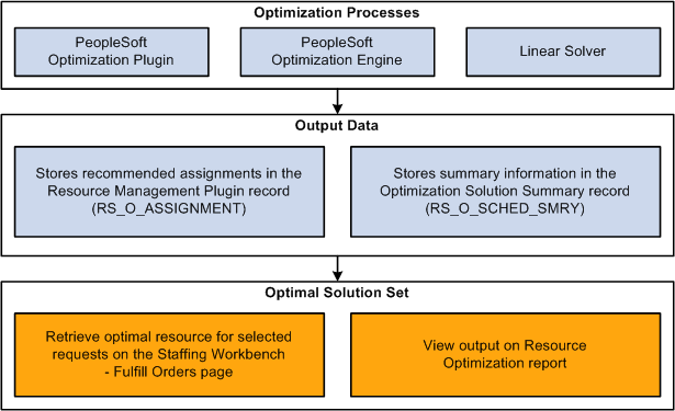

The following diagram shows the data components that fuel the Optimization Engine calculations, optimization setup steps, input data, optimization processes, and output data that create Optimal Solution Sets. Included in parenthesis are the record names that are updated by a process.
Resource Optimization process flow diagram (1 of 2)
Resource Optimization process flow diagram (2 of 2)
