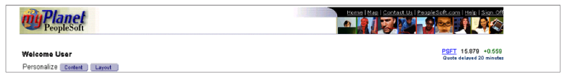

This example demonstrates how to create the following header.
Header created in this example
