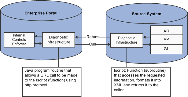

Diagnostic Architecture
The diagnostic architecture is designed to track external source system configuration data that is either low in volume, or is exception information from high volume tables. For example, a diagnostic should not query the entire customer list, rather it should look for specific exceptions to the customer list, such as customers that do not have a defined credit limit. If the queries and functions that are used by diagnostics are not designed using this principal, system performance will severely degrade and the diagnostic could fail; a diagnostic report is limited to 1000 rows and 30 columns.
The following diagram depicts the diagnostic architecture, in which the enterprise portal and the source system communicate using Java routines and Iscript functions.
Diagnostic architecture and communication between the Enterprise Portal

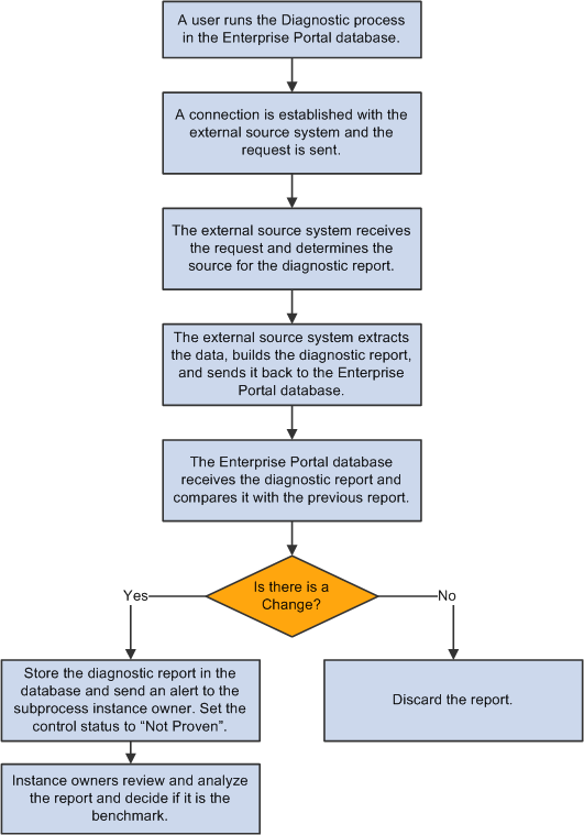

Diagnostics Data Feed Process Flow
This diagram shows the process flow for the Diagnostic Data Feed Application Engine process (EPQ_DIAG_FCH), in which diagnostics data is extracted, the diagnostic report is built, and if the diagnostic data differs from the previous report the control status is set to not proven .
Diagnostic Data Feed process flow of diagnostic data extraction and comparison to previous runs
