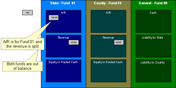

When a $100.00 tax is levied, the following diagram illustrates the initial GL entries for this scenario.
Tax Bill Levied Example
The state fund's A/R is debited, and the state and county funds' revenue accounts are credited.
If left at this, the funds would be out of balance; the state fund would have an overall excess debit and the county fund would have an excess credit.

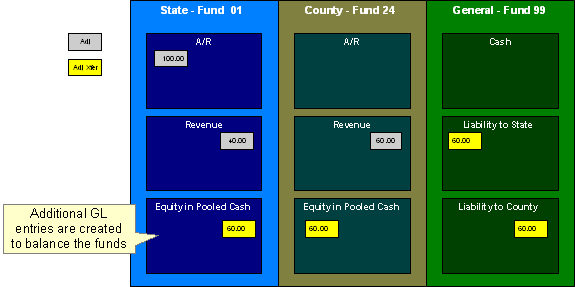

To balance the funds, the state fund accepts the responsibility for collecting the county taxes from the taxpayer but immediately remunerates the charges to the county fund.
Tax Bill Fund Balancing
This transfer is done using the general fund. The state fund's EPC account is credited and the liability to state is debited with the amount of the county sales tax revenue. Also, the county fund's EPC account is debited and the general fund's liability to the county account is credited by the county sales tax revenue. In effect, the state fund owes the county charges to the general fund, and the general fund owes the county charges to the county fund.

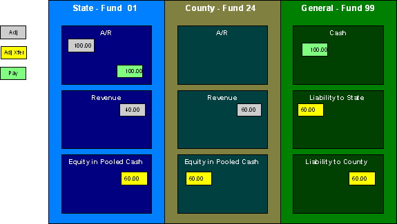

When the payment arrives, the cash is debited to the general fund's cash account, and the state fund's A/R is relieved. Again, the funds would be unbalanced if left in this condition; the state fund would have an excess of credits and the general fund would have an excess of debits.
Payment Received Initial Fund Balancing

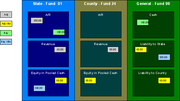

To maintain each fund's balance of debits and credits, the general fund's liability to the state fund is credited by the amount of the fund's share of the cash, and the state fund's EPC is debited. Note that the payment has no effect on county fund's EPC and the general fund's liability to the county fund. The county fund "received" its money from the state department when the adjustment was created.
Payment Received Final Balancing
And so, all funds have matching debits and credits.
