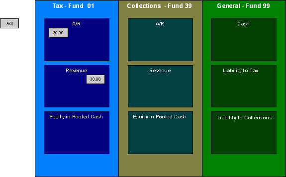

When a tax is levied, the following adjustments are made to the tax fund account producing the following GL entries.
Tax Levy Fund Example
For the tax fund, the GL details of the bill include a debit to the accounts receivable (A/R) account and credits to the revenue account. The taxing authority is owed the entire portion of the adjustment by the taxpayer. The tax fund is balanced.

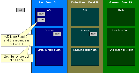

The following diagram illustrates the initial GL accounting that occurs when a collection fee is levied.
Collection Fee Levied Fund Example
Because A/R is added to the tax fund and the revenue is added to the collections fund, the funds are out of balance.

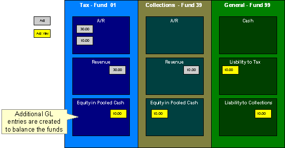

As the tax authority takes on the responsibility to collect the fee, additional entries are created to balance the funds.
Collection Fee Fund Balancing

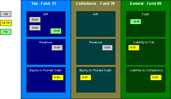

The following diagram illustrates the initial GL accounting that would occur when the payment arrives.
Payment Received Initial GL
The tax authority's general cash account is debited, and the tax fund's A/R account is credited.
If the accounting were left in this state, the fund accounting principal - that each fund represents an independent entity with a self-balancing chart of accounts - would be violated. This violation is caused due to the fact that cash is recorded on the general fund, not the tax fund, causing the general fund to have an excess debit and the tax fund to have an excess credit.

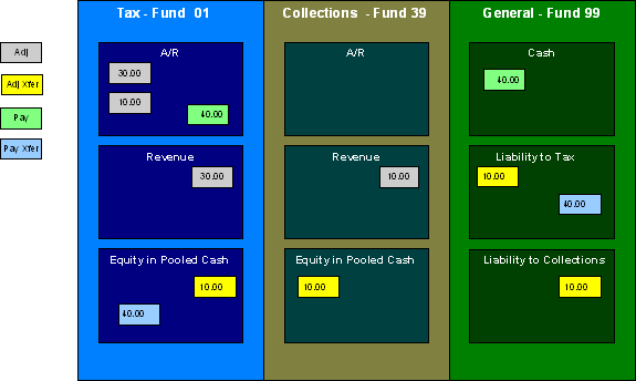

From an organizational viewpoint, to make the tax fund whole, the tax fund needs to note what portion of the cash it owns, and correspondingly, the tax authority needs to note what portion of the cash is owed to each fund. The following diagram illustrates this point.
Payment Received Fund Balancing
To maintain a balance of debits and credits within each fund, the tax and collection funds have an "equity in pooled cash" (EPC) account and the general fund has a liability account for each fund. In addition to debiting the general fund's cash account and crediting the tax fund's A/R accounts, the tax and collection funds' EPC accounts are debited and the general funds liability accounts are credited.
And so, with the additional GL entries, all funds have matching debits and credits.
