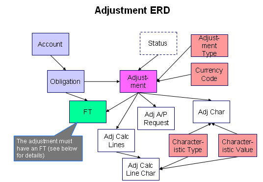

Adjustment - Main
The following data model illustrates the adjustment object.
Adjustment - FT
The following data model illustrates the FT that must be associated with an adjustment segment.

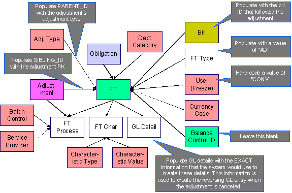

Please populate the columns on the FT that's associated with the adjustment as follows:
CUR_AMT should be set equal to the adjustment amount
PAY_AMT should be set equal to the adjustment amount
CRE_DTTM should be set equal to the adjustment date / time
FREEZE_SW should be "Y"
FREEZE_DTTM should be set equal to the adjustment date / time
ARS_DT should be set equal to the adjustment date
CORRECTION_SW should be "N"
REDUNDANT_SW should be "N"
NEW_DEBIT_SW should be "N"
NOT_IN_ARS_SW should be set to "N"
SHOW_ON_BILL_SW should be set to "N" on all adjustments other than adjustments that have been generated since the last bill. For recent adjustments that you want to show on the next bill, this switch must be "Y"
ACCOUNTING_DT should be set to the current date
SCHED_DISTRIB_DT should be left blank
CURRENCY_CD should be the currency on the installation record
BAL_CTL_GRP_ID should be left blank
XFERRED_OUT_SW should be set to "Y"
PARENT_ID should be set to the adjustment's adjustment type
SIBLING_ID should be set to the adjustment ID
Do NOT create any GL details for the FT. If GL details are converted, ensure they are populated with the EXACT information the system would use to create them. This information is used to create the reversing GL entry when the adjustment is canceled.
FTs for adjustments have an optional foreign key BILL_ID to the Bill (CI_BILL) table. If your implementation is planning to convert financial transactions for adjustments, but does not plan to convert bills, the key generation program for Bill must still be run. Refer to The Big Picture of Key Assignment for more information.
