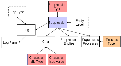

Suppression
Suppression Data Model
The following data model illustrates the Suppression object.
Suppression Table Names
Data Model Name
Table Name
Generated Keys
Object Validation Batch Control
Referential Integrity Validation Batch Control
Key Assignment Batch Control
Insertion Batch Control
Suppression
C1_SUPPRESSION
Yes. C1_SUPPRESSION_K
VAL-SUPP
CIPVSUPV
CIPVSUPK
CIPVSUPI
Suppression Entity
C1_SUPPRESSION_ENTITY
No. The key is Suppression ID, Suppression Entity ID.
CIPVSUEV
CIPVSUEI
Suppression Process
C1_SUPPRESSION_PROCESS
No. The key is Suppression ID, Suppression Process flag.
CIPVSURV
CIPVSURI
Suppression Characteristic
C1_SUPPRESSION_CHAR
No. The key is Suppression ID, Characteristic Type, and Sequence.
CIPVSUCV
CIPVSUCI
Suppression Log
C1_SUPPRESSION_LOG
No. The key is Suppression ID and Sequence.
CIPVSULV
CIPVSULI
Suppression Log Parameter
C1_SUPPRESSION_LOG_PARM
No. The key is Suppression ID, Sequence, and Message Parameter Sequence.
CIPVSUMV
CIPVSUMI
Suppression Suggestions
