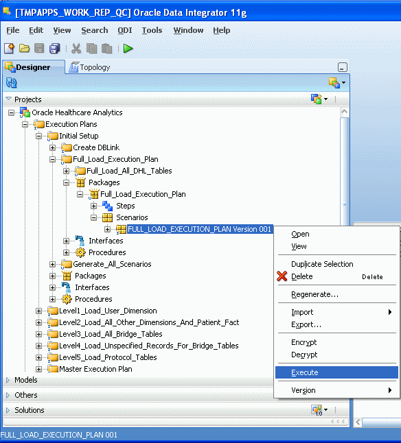

To execute a full load, perform the following steps:
  1. Navigate to Execution Plans > Initial Setup > Full_Load_Execution_Plan > Packages > Full_Load_Execution_Plan > Scenarios.
  2. Right-click FULL_LOAD_EXECUTION_PLAN.
  3. Select Execute.
    Figure 3-1 Executing a Full Load
    Description of Figure 3-1 follows
    Description of "Figure 3-1 Executing a Full Load"

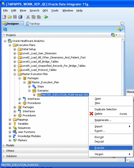

To execute an incremental load, perform the following steps:
  1. Navigate to Execution Plans > Master Execution Plan > Packages > Master_Execution_Plan > Scenarios.
  2. Right-click MASTER_EXECUTION_PLAN.
  3. Select Execute.

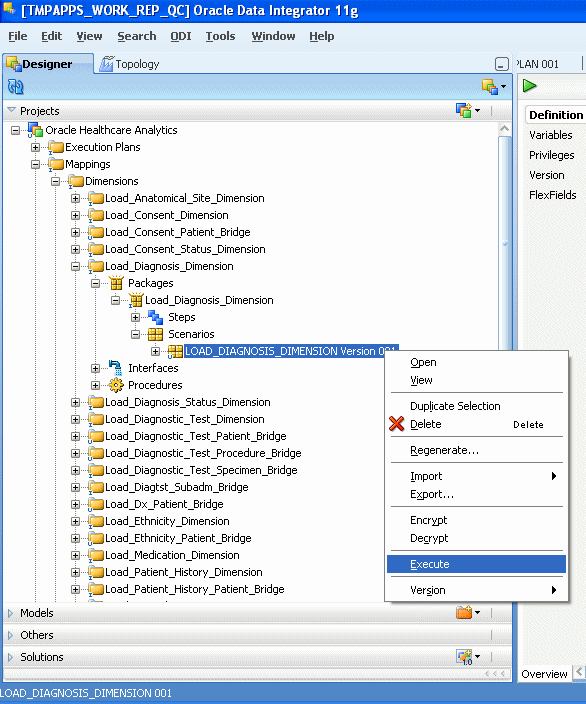

Perform the following steps to execute an individual ETL:
For example, to execute ETL for Diagnosis dimension, perform the following steps:
  1. Navigate to Mappings > Dimensions > Load_Diagnosis_Dimension > Packages > Load_Diagnosis_Dimension > Scenarios.
  2. Right-click LOAD_DIAGNOSIS_DIMENSION.
  3. Select Execute.
    Figure 3-3 Executing an Individual ETL
    Description of Figure 3-3 follows
    Description of "Figure 3-3 Executing an Individual ETL"
