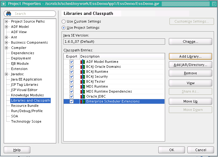

In Oracle JDeveloper, in the Application Navigator select the EssDemo project.
Right-click and from the dropdown list select Project Properties....
In the Project Properties navigator, select Libraries and Classpath.
In the Libraries and Classpath area, click Add Library....
In the Add Library dialog, in the Libraries area select Enterprise Scheduler Extensions.
In the Add Library dialog click OK. This adds the appropriate libraries, as shown in Figure 5-5.
Click OK to dismiss the Project Properties dialog.

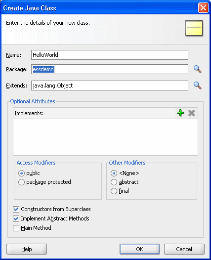

In the Create Java Class dialog, in the Name field, enter HelloWorld
In the Create Java Class window, in the Package field, enter essdemo
In other fields accept the defaults as shown in Figure 5-7.
Click OK.

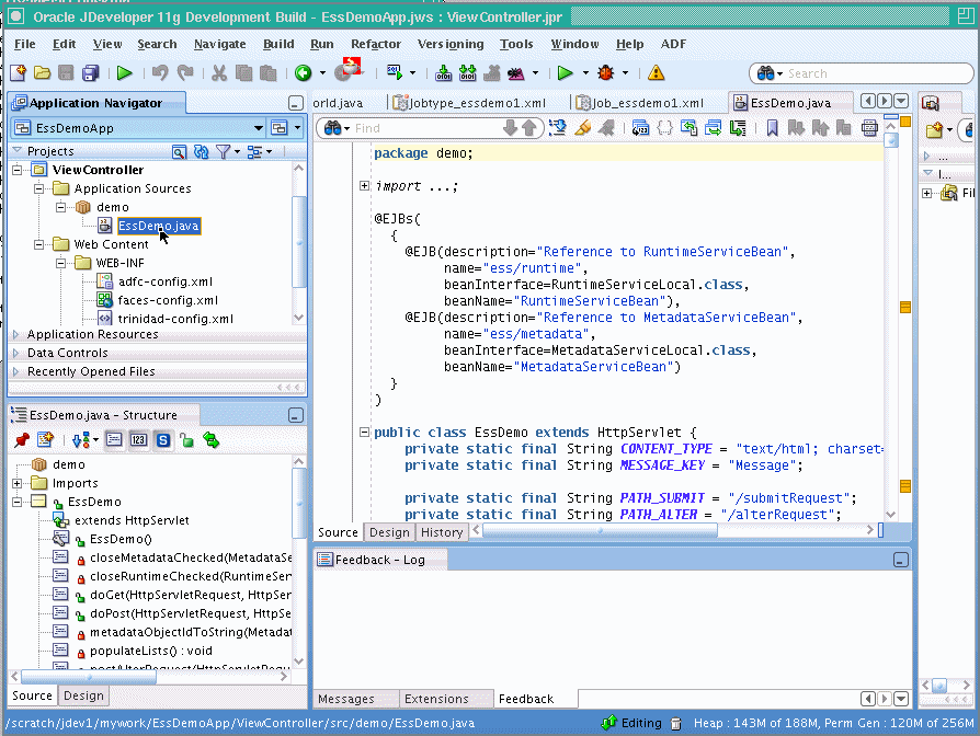

The supplied EssDemo application includes the completed servlet. You need to copy the source code into your project. To do this, in Oracle JDeveloper replace the contents of the servlet with the contents of the file EssDemo.java
supplied with the sample application, as shown in Figure 5-12. The EssDemo.java
sample code includes several hundred lines, so it is not included in this text in an example.

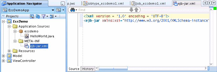

To create the ejb-jar.xml file in the Java implementation project:
In Application Navigator select the EssDemo project.
Click the New... icon.
In the New Gallery, in the navigator expand General and select Deployment Descriptors.
In the New Gallery in the Items area select Java EE Deployment Descriptor.
Click OK.
In the Select Descriptor page select ejb-jar.xml.
Click Next.
In the Select Version page select 3.0.
Click Finish.
This creates ejb-jar.xml
file and the META-INF
directory in the EssDemo project, as shown in Figure 5-18.

In the Application Navigator, right-click the SuperEss project and select Project Properties.
In the Project Properties dialog, expand Project Source Paths and click the Resources navigation tab.
Select Include Content from Subfolders.
Click the Libraries and Classpath navigation tab.
Click Add Library, select Enterprise Scheduler Extensions, and click OK.

In the Application Navigator, expand SuperEss, expand Application Sources, expand META-INF, and double-click ejb-jar.xml.
Replace the contents of the file with the XML shown in Example 5-6
Example 5-6 Contents to Copy to ejb-jar.xml for a back-end Hosting Application
<?xml version = '1.0' encoding = 'UTF-8'?> <ejb-jar xmlns="http://java.sun.com/xml/ns/javaee" xmlns:xsi="http://www.w3.org/2001/XMLSchema-instance" xsi:schemaLocation="http://java.sun.com/xml/ns/javaee http://java.sun.com/xml/ns/javaee/ejb-jar_3_0.xsd" version="3.0"> <display-name>ESS</display-name> <enterprise-beans> <message-driven> <ejb-name>ESSAppEndpoint</ejb-name> <ejb-class>oracle.as.scheduler.ejb.EssAppEndpointBean</ejb-class> <activation-config> <activation-config-property> <!-- The "applicationName" property specifies the logical name used - by Oracle Enterprise Scheduler to identify this application. - This name is independent of the application name used when - deploying the application to the container. This decoupling - allows applications to safely hardcode the logical application - name in source code without having to worry about the more - frequently changed deployment name. - - Note: The name given here must also be specified in the - SYS_effectiveApplication property of each job definition and - job set of this application. --> <activation-config-property-name>applicationName</activation-config-property-name> <activation-config-property-value>EssDemoApp</activation-config-property-value> </activation-config-property> <activation-config-property> <!-- The "applicationStripe" property specifies which JPS security - stripe or "security context" Oracle Enterprise Scheduler should - use to perform security checks. - - The value here must be the same as the "injection-target-name" - value used by the "oracle.security.jps.ee.ejb.JpsInterceptor" - interceptor descriptor below. - - Note: When creating jps-config.xml through JDev, it will create - default security context using the JDev workspace name. In - order to simplify things, we will use the JDev workspace name - as our value. Otherwise, you will have to rename the security - context created by JDev or create your own. --> <activation-config-property-name>applicationStripe </activation-config-property-name> <activation-config-property-value>EssDemoApp </activation-config-property-value> </activation-config-property> </activation-config> </message-driven> <!-- The AsyncBean allows asynchronous Java jobs to notify - Oracle Enterprise Scheduler of its status through Java EE EJB APIs. - It is recommended to use the WebService callback pattern - instead of the EJB callbacks wherever possible. --> <session> <description>Async Request Bean</description> <ejb-name>AsyncRequestBean</ejb-name> <ejb-class>oracle.as.scheduler.ejb.AsyncRequestBean</ejb-class> </session> <!-- The Runtime Service allows users to interact with an Executable. - Operations include submitting, cancelling, querying, etc. --> <session> <description>Runtime Session Bean</description> <ejb-name>RuntimeServiceBean</ejb-name> <ejb-class>oracle.as.scheduler.ejb.RuntimeServiceBean</ejb-class> </session> <!-- The Metadata Service allows user to interact with - Oracle Enterprise Scheduler, metadata including job definitions, - job sets, job types, schedules, and so on. Operations include reading, - writing, querying, copying, deleting, and so on. --> <session> <description>Metadata Session Bean</description> <ejb-name>MetadataServiceBean</ejb-name> <ejb-class>oracle.as.scheduler.ejb.MetadataServiceBean</ejb-class> </session> </enterprise-beans> <!-- - The JPS interceptor is used by JPS (Java Platform Security) in order to - perform security checks. The "stripe name" is usually associated with - the application name but some groups split their security permissions - between Oracle ADF grants and Oracle Enterprise Scheduler grants, creating - two stripes. - For example, the Oracle ADF grants would live in the "MyApp" stripe while - the Oracle Enterprise Scheduler grants would live in the "MyAppEss". - - Note: For this example, we will use only 1 stripe. - - Note: When creating jps-config.xml through JDev, it will create - default security context using the JDev workspace name. In - order to simplify things, we will use the JDev workspace name - as our value. Otherwise, you will have to rename the security - context created by JDev or create your own. --> <interceptors> <interceptor> <interceptor-class>oracle.security.jps.ee.ejb.JpsInterceptor</interceptor-class> <env-entry> <env-entry-name>application.name</env-entry-name> <env-entry-type>java.lang.String</env-entry-type> <env-entry-value>EssDemoApp</env-entry-value> <injection-target> <injection-target-class>oracle.security.jps.ee.ejb.JpsInterceptor</injection-target-class> <injection-target-name>application_name</injection-target-name> </injection-target> </env-entry> </interceptor> </interceptors> </ejb-jar>

To create a Java class that implements the executable Interface:
In the Application Navigator, right-click the SuperEss project and choose New.
In the New Gallery, expand General, select Java and then Java Class, and click OK.
In the Create Java Class dialog, set the name to HelloWorldJob
Set the package to oracle.apps.ess.howto
Click the Add icon, add the oracle.as.scheduler.Executable
interface, and click OK.
In other fields accept the defaults.
Click OK.
Replace the contents of the file with the XML shown in Example 5-10
Example 5-10 Contents to Copy to ejb-jar.xml for a Front-End Submitter Application
<?xml version = '1.0' encoding = 'UTF-8'?> <ejb-jar xmlns="http://java.sun.com/xml/ns/javaee" xmlns:xsi="http://www.w3.org/2001/XMLSchema-instance" xsi:schemaLocation="http://java.sun.com/xml/ns/javaee http://java.sun.com/xml/ns/javaee/ejb-jar_3_0.xsd" version="3.0"> <display-name>ESS</display-name> <enterprise-beans> <!-- Note that the UI application does NOT have a message driven bean. - This is because the UI application does not run any jobs. The UI - application does have the other EJBs. --> <!-- The AsyncBean allows asynchronous Java jobs to notify - Oracle Enterprise Scheduler of its status through Java EE EJB APIs. - It is recommended to instead use the WebService callback pattern - instead of the EJB callbacks wherever possible. --> <session> <description>Async Request Bean</description> <ejb-name>AsyncRequestBean</ejb-name> <ejb-class>oracle.as.scheduler.ejb.AsyncRequestBean</ejb-class> </session> <!-- The Runtime Service allows users to interact with an Executable. - Operations include submitting, cancelling, querying, etc. --> <session> <description>Runtime Session Bean</description> <ejb-name>RuntimeServiceBean</ejb-name> <ejb-class>oracle.as.scheduler.ejb.RuntimeServiceBean</ejb-class> </session> <!-- The Metadata Service allows users to interact with - Oracle Enterprise Scheduler, metadata, including job definitions, - job sets, job types, schedules, and so on. - Operations include reading, writing, querying, copying, deleting, - and so on. --> <session> <description>Metadata Session Bean</description> <ejb-name>MetadataServiceBean</ejb-name> <ejb-class>oracle.as.scheduler.ejb.MetadataServiceBean</ejb-class> </session> </enterprise-beans> <!-- - The JPS interceptor is used by JPS (Java Platform Security) in order to - perform security checks. The "stripe name" is usually associated with - the application name but some groups split their security permissions - between Oracle ADF grants and Oracle Enterprise Scheduler grants, thereby - creating two stripes. For example, the Oracle ADF grants would live - in the "MyApp" stripe while the Oracle Enterprise Scheduler - grants would live in the "MyAppEss". - - Note: For this example, we will use only 1 stripe. - - Note: When creating jps-config.xml through JDev, it will create - default security context using the JDev workspace name. In - order to simplify things, we will use the JDev workspace name - as our value. Otherwise, you will have to rename the security - context created by JDev or create your own. --> <interceptors> <interceptor> <interceptor-class>oracle.security.jps.ee.ejb.JpsInterceptor</interceptor-class> <env-entry> <env-entry-name>application.name</env-entry-name> <env-entry-type>java.lang.String</env-entry-type> <env-entry-value>EssDemoApp</env-entry-value> <injection-target> <injection-target-class>oracle.security.jps.ee.ejb.JpsInterceptor</injection-target-class> <injection-target-name>application_name</injection-target-name> </injection-target> </env-entry> </interceptor> </interceptors> </ejb-jar>
Click Add Library, select ADF Web Runtime and Enterprise Scheduler Extensions, and click OK.

To create the HTTP Servlet for the front-end submitter application:
Right-click the SuperEss project and choose New.
In the New Gallery, expand Web Tier, select Servlets and then HTTP Servlet, and click OK.
In the Web Application page of the Web Application wizard, select Servlet 2.5\JSP 2.1 (Java EE 1.5).
In the Create HTTP Servlet - Step 1 of 3: Servlet Information page, enter EssDemoAppServlet
in the Class field.
Enter oracle.apps.ess.howto
in the Package field and click Next.
Click Finish.
In the source editor, replace the contents of ESSDemoAppServlet.java with the code in Example 5-11.
Example 5-11 HTTP Servlet Code for the Front-End Submitter Application
package oracle.apps.ess.howto; import java.io.IOException; import java.io.PrintWriter; import java.io.StringWriter; import java.util.ArrayList; import java.util.Calendar; import java.util.Enumeration; import java.util.HashSet; import java.util.Iterator; import java.util.List; import java.util.ListIterator; import java.util.Map; import java.util.Set; import java.util.SortedSet; import java.util.TreeSet; import java.util.logging.Level; import java.util.logging.Logger; import java.util.regex.Pattern; import javax.servlet.ServletConfig; import javax.servlet.ServletException; import javax.servlet.http.HttpServlet; import javax.servlet.http.HttpServletRequest; import javax.servlet.http.HttpServletResponse; import javax.servlet.http.HttpSession; import oracle.as.scheduler.MetadataObjectId; import oracle.as.scheduler.MetadataObjectId.MetadataObjectType; import oracle.as.scheduler.MetadataService; import oracle.as.scheduler.MetadataService.QueryField; import oracle.as.scheduler.MetadataServiceHandle; import oracle.as.scheduler.RequestDetail; import oracle.as.scheduler.RequestParameters; import oracle.as.scheduler.RuntimeService; import oracle.as.scheduler.RuntimeServiceHandle; import oracle.as.scheduler.State; import oracle.as.scheduler.core.JndiUtil; public class EssDemoAppServlet extends HttpServlet { @SuppressWarnings("compatibility:4685800289380934682") private static final long serialVersionUID = 1L; private static final String CONTENT_TYPE = "text/html; charset=UTF-8"; private static final String MESSAGE_KEY = "Message"; private static final String PATH_SUBMIT = "/submitRequest"; private static final String PATH_ALTER = "/alterRequest"; private static final String MDO_SEP = ";"; private static final String ACTION_CANCEL = "Cancel"; private static final String ESS_UNAVAIL_MSG = "<p>Enterprise Scheduler Service is currently unavailable. Cause: %s</p>"; private enum PseudoScheduleChoices { Immediately(0), InTenSeconds(10), InTenMinutes(10 * 60); @SuppressWarnings("compatibility:-5637079380819677366") private static final long serialVersionUID = 1L; private int m_seconds; private PseudoScheduleChoices(int seconds) { m_seconds = seconds; } public int getSeconds() { return m_seconds; } } public EssDemoAppServlet() throws ServletException { super(); } @Override public void init(ServletConfig config) throws ServletException { super.init(config); } @Override public void doGet(HttpServletRequest request, HttpServletResponse response) throws ServletException, IOException { response.setContentType(CONTENT_TYPE); HttpSession session = request.getSession(true); String lastMessage = String.valueOf(session.getAttribute(MESSAGE_KEY)); if ("null".equals(lastMessage)) { lastMessage = ""; } try { RuntimeLists runtimeLists = getRuntimeLists(); MetadataLists metadataLists = getMetadataLists(); renderResponse(metadataLists, runtimeLists, request, response, lastMessage); } catch (ServletException se) { throw se; } catch (Exception e) { throw new ServletException(e); } } @Override public void doPost(HttpServletRequest request, HttpServletResponse response) throws ServletException, IOException { response.setContentType(CONTENT_TYPE); request.setCharacterEncoding("UTF-8"); HttpSession session = request.getSession(true); String pathInfo = request.getPathInfo(); // Clear the message on every post request StringBuilder message = new StringBuilder(""); try { // Select each handler based on the form action if ("".equals(pathInfo)) { // No processing } else if (PATH_SUBMIT.equals(pathInfo)) { postSubmitRequest(request, message); } else if (PATH_ALTER.equals(pathInfo)) { postAlterRequest(request, message); } else { message.append(String.format("<p>No handler for pathInfo=%s</p>", pathInfo)); } } catch (ServletException se) { Throwable t = se.getCause(); String cause = (t == null) ? se.toString() : t.toString(); message.append (String.format(ESS_UNAVAIL_MSG, cause)); } // Storing the messages in the session allows them to persist // through the redirect and across refreshes. session.setAttribute(MESSAGE_KEY, message.toString()); // render the page by redirecting to doGet(); this intentionally // strips the actions and post data from the request. response.sendRedirect(request.getContextPath() + request.getServletPath()); } /** * Handle the job submission form. * @param request * @param message * @throws ServletException */ private void postSubmitRequest(HttpServletRequest request, StringBuilder message) throws ServletException { String jobDefName = request.getParameter("job"); String scheduleDefName = request.getParameter("schedule"); // Various required args for submission Calendar start = Calendar.getInstance(); start.add(Calendar.SECOND, 2); // Launch the job based on form contents if (jobDefName == null || scheduleDefName == null) { message.append("Both a job name and a schedule name must be specified\n"); } else { PseudoScheduleChoices pseudoSchedule = null; // See if schedule given is actually a pseudo schedule try { pseudoSchedule = PseudoScheduleChoices.valueOf(scheduleDefName); } catch (IllegalArgumentException e) { // The string is not a valid member of the enum pseudoSchedule = null; } MetadataObjectId scheduleDefId = null; String scheduleDefNamePart = null; MetadataObjectId jobDefId = stringToMetadataObjectId(jobDefName); // Don't look up schedules that aren't real if (pseudoSchedule != null) { scheduleDefNamePart = scheduleDefName; start.add(Calendar.SECOND, pseudoSchedule.getSeconds()); } else { scheduleDefId = stringToMetadataObjectId(scheduleDefName); scheduleDefNamePart = scheduleDefId.getNamePart(); } String jobDefNamePart = jobDefId.getNamePart(); String requestDesc = jobDefNamePart + "@" + scheduleDefNamePart; Logger logger = getLogger(); long requestId = submitRequest(pseudoSchedule, requestDesc, jobDefId, scheduleDefId, start, logger); // Populate the message block based on results message.append(String.format("<p>New request %d launched using %s</p>", requestId, requestDesc)); } } private Long submitRequest(final PseudoScheduleChoices pseudoSchedule, final String requestDesc, final MetadataObjectId jobDefId, final MetadataObjectId scheduleDefId, final Calendar start, final Logger logger) throws ServletException { RuntimeServicePayload<Long> myPayload = new RuntimeServicePayload<Long>() { @Override Long execute(RuntimeService service, RuntimeServiceHandle handle, Logger logger) throws Exception { RequestParameters params = new RequestParameters(); return (null != pseudoSchedule) ? service.submitRequest(handle, requestDesc, jobDefId, start, params) : service.submitRequest(handle, requestDesc, jobDefId, scheduleDefId, null, start, null, params); } }; try { return performOperation(myPayload, logger); } catch (Exception e) { throw new ServletException("Error submitting request using job: " + jobDefId + " and schedule: " + scheduleDefId, e); } } /** * Handle the "Cancel" and "Purge" actions from the form enclosing * the Request Status table. * @param request * @param message * @throws ServletException */ private void postAlterRequest(HttpServletRequest request, StringBuilder message) throws ServletException { String cancelID = null; /* * there are a few assumptions going on here... * the HTTP button being used to transmit the action and * request is backwards from its normal usage (eg. the name * should be invariable, and the value variable). Because we * want to display either "Purge" or "Cancel" on the button, and * transmit the reqId with it, we are reversing the map entry * to get the key (which in this case will be the reqID), and * match it to the value (Purge or Cancel). * Assumptions are that there will be only one entry in the map * per request (one purge or cancel). Also, that the datatypes * for the key and value willl be those documented for * ServletRequest (<K,V> = <String, String[]>). */ Map requestMap = request.getParameterMap(); Iterator mapIter = requestMap.entrySet().iterator(); while (mapIter.hasNext()) { Map.Entry entry = (Map.Entry)mapIter.next(); String key = (String)entry.getKey(); String[] values = (String[])entry.getValue(); if (ACTION_CANCEL.equals(values[0])) { cancelID = key; } } if (cancelID != null) { try { final String cancelId2 = cancelID; RuntimeServicePayload<Void> myPayload = new RuntimeServicePayload<Void>() { @Override Void execute(RuntimeService service, RuntimeServiceHandle handle, Logger logger) throws Exception { service.cancelRequest(handle, Long.valueOf(cancelId2)); return null; } }; Logger logger = getLogger(); performOperation(myPayload, logger); message.append (String.format("<p>Cancelled request %s</p>", cancelID)); } catch (Exception e) { throw new ServletException ("Error canceling or purging request", e); } } else { message.append("<p>No purge or cancel action specified</p>"); } } private String metadataObjectIdToString(MetadataObjectId mdoID) throws ServletException { String mdoString = mdoID.getType().value() + MDO_SEP + mdoID.getPackagePart() + MDO_SEP + mdoID.getNamePart(); return mdoString; } private MetadataObjectId stringToMetadataObjectId(String mdoString) throws ServletException { String[] mdoStringParts = mdoString.split(Pattern.quote(MDO_SEP)); if (mdoStringParts.length != 3) { throw new ServletException(String.format("Unexpected number of components %d found " + "when converting %s to MetadataObjectID", mdoStringParts.length, mdoString)); } MetadataObjectType mdType = MetadataObjectType.getMOType(mdoStringParts[0]); String mdPackage = mdoStringParts[1]; String mdName = mdoStringParts[2]; MetadataObjectId mdoID = MetadataObjectId.createMetadataObjectId(mdType, mdPackage, mdName); return mdoID; } /** * this changes the format used in this class for job definitions to the one * which will be used in the runtime query. * @param strMetadataObject * @return string representing object in runtime store * @throws ServletException */ private String fixMetadataString(String strMetadataObject) throws ServletException { String fslash = "/"; String[] mdoStringParts = strMetadataObject.split(Pattern.quote(MDO_SEP)); if (mdoStringParts.length != 3) { throw new ServletException(String.format("Unexpected number of components %d found " + "when converting %s to MetadataObjectID", mdoStringParts.length, strMetadataObject)); } String[] trimStringParts = new String[mdoStringParts.length]; for (int i = 0; i < mdoStringParts.length; i++) { String mdoStringPart = mdoStringParts[i]; trimStringParts[i] = mdoStringPart.replaceAll(fslash, " ").trim(); } MetadataObjectType mdType = MetadataObjectType.getMOType(trimStringParts[0]); String mdPackage = fslash + trimStringParts[1]; String mdName = trimStringParts[2]; MetadataObjectId metadataObjId = MetadataObjectId.createMetadataObjectId(mdType, mdPackage, mdName); return metadataObjId.toString(); } private Set<String> getSetFromMetadataEnum(Enumeration<MetadataObjectId> enumMetadata) throws ServletException { Set<String> stringSet = new HashSet<String>(); while (enumMetadata.hasMoreElements()) { MetadataObjectId objId = enumMetadata.nextElement(); String strNamePart = objId.getNamePart(); stringSet.add(strNamePart); } return stringSet; } //**************************************************************************** // // HTML Rendering Methods // //**************************************************************************** /** * Rendering code for the page displayed. * In a real application this would be done using JSP, but this approach * keeps everything in one file to make the example easier to follow. * @param response The response object from the main request. * @param message Text that will appear in the message panel, may contain HTML * @throws IOException */ private void renderResponse(MetadataLists ml, RuntimeLists rl, HttpServletRequest request, HttpServletResponse response, String message) throws IOException, ServletException { response.setContentType(CONTENT_TYPE); PrintWriter out = response.getWriter(); String urlBase = request.getContextPath() + request.getServletPath(); // Indents maintained for clarity out.println("<html>"); out.println("<head><title>EssDemo</title></head>"); out.println("<body>"); out.println("<table align=\"center\"><tbody>"); out.println(" <tr><td align=\"center\"><h1>Oracle Enterprise Scheduler Tutorial</h1></td></tr>"); out.println(" <tr><td align=\"center\"><table cellspacing=6><tr>"); // Job launch form out.println(" <td align=\"center\">"); out.println(" <h2>Launch Job</h2>"); renderLaunchJobForm(ml, out, urlBase); out.println(" </td>"); out.println(" <td align=\"center\" bgcolor=\"blue\" width=\"2\"/>"); out.println(" </tr></table></td></tr>"); out.println(" <tr><td bgcolor=\"red\"/></tr>"); // Message panel out.println(" <tr><td align=\"center\"><h3>Messages</h3></td></tr>"); out.println(" <tr><td>"); out.println(message); out.println(" </td></tr>"); out.println(" <tr><td bgcolor=\"red\"/></tr>"); // Request status out.println(" <tr><td align=\"center\">"); out.println(" <form name=\"attrs\" action=\"" + urlBase + PATH_ALTER + "\" method=\"post\">"); out.println(" <h2>Request Status</h2>"); out.println(" <table border=2><tbody>"); out.println(" <th>reqID</th>"); out.println(" <th>Description</th>"); out.println(" <th>Scheduled time</th>"); out.println(" <th>State</th>"); out.println(" <th>Action</th>"); renderStatusTable(out, rl.requestDetails); out.println(" </tbody></table>"); out.println(" </form>"); out.println(" </td></tr>"); out.println("</tbody></table>"); out.println("</body></html>"); out.close(); } private void renderLaunchJobForm(MetadataLists ml, PrintWriter out, String urlBase) throws ServletException { out.println(" <form name=\"attrs\" action=\"" + urlBase + PATH_SUBMIT + "\" method=\"post\">"); out.println(" <table><tbody>"); out.println(" <tr><td align=\"right\">"); out.println(" <b>Job:</b>"); out.println(" <select name=\"job\">"); renderMetadataChoices(out, ml.jobDefList, false); renderMetadataChoices(out, ml.jobSetList, false); out.println(" </select>"); out.println(" </td></tr>"); out.println(" <tr><td align=\"right\">"); out.println(" <b>Schedule:</b>"); out.println(" <select name=\"schedule\">"); renderPseudoScheduleChoices(out); renderMetadataChoices(out, ml.scheduleList, false); out.println(" </select>"); out.println(" </td></tr>"); out.println(" <tr><td align=\"center\">"); out.println(" <input name=\"submit\" value=\"Submit\" type=\"submit\">"); out.println(" </td></tr>"); out.println(" </tbody></table>"); out.println(" </form>"); } /** * * @param out - printwriter * @param jobChoices -- metadata to be displayed * @param bBlankFirst -- blank first (so that this param is not required) * @throws ServletException */ private void renderMetadataChoices(PrintWriter out, Enumeration<MetadataObjectId> jobChoices, boolean bBlankFirst) throws ServletException { if (jobChoices == null) return; boolean bFirst = true; while (jobChoices.hasMoreElements()) { MetadataObjectId job = jobChoices.nextElement(); String strJob = metadataObjectIdToString(job); String strNamePart = job.getNamePart(); if (strNamePart.compareTo("BatchPurgeJob") == 0) { continue; } else { if (bFirst && bBlankFirst) { out.printf("<option value=\"%s\">%s</option>", "", ""); bFirst = false; } out.printf("<option value=\"%s\">%s</option>", strJob, strNamePart); } } } /** * helper method for rendering choices based on strings, adding an empty * string to the beginning of the list * @param out * @param choices */ private void renderStringChoices(PrintWriter out, Set<String> choices) { if (choices == null) return; choices.add(""); SortedSet<String> sorted = new TreeSet<String>(choices); Iterator choiceIter = sorted.iterator(); while (choiceIter.hasNext()) { String choice = (String)choiceIter.next(); out.printf("<option value=\"%s\">%s</option>", choice, choice); } } private void renderPseudoScheduleChoices(PrintWriter out) { for (PseudoScheduleChoices c : PseudoScheduleChoices.values()) { out.printf("<option value=\"%s\">%s</option>", c, c); } } private void renderStatusTable (PrintWriter out, List<RequestDetail> reqDetails) { if (reqDetails == null) { return; } for (RequestDetail reqDetail : reqDetails) { State state = reqDetail.getState(); Calendar scheduledTime = reqDetail.getScheduledTime(); String scheduledTimeString = null; if (scheduledTime == null) { scheduledTimeString = "null scheduled time"; } else { scheduledTimeString = String.valueOf(scheduledTime.getTime()); } final String actionButton; if (!state.isTerminal()) { String action = ACTION_CANCEL; String reqId = String.valueOf(reqDetail.getRequestId()); actionButton = String.format ("<button type=submit value=%s name=\"%s\">%s</button>", action, reqId, action); } else { actionButton = " "; } out.printf("<tr><td>%d</td><td>%s</td><td>%s</td><td>%s</td><td>%s</td></tr>\n", reqDetail.getRequestId(), reqDetail.getDescription(), scheduledTimeString, state, actionButton); } } private MetadataService getMetadataService() throws Exception { return JndiUtil.getMetadataServiceEJB(); } private RuntimeService getRuntimeService() throws Exception { return JndiUtil.getRuntimeServiceEJB(); } private abstract class Payload<SERVICE, HANDLE, RETURN> { abstract SERVICE getService() throws Exception; abstract HANDLE getHandle(SERVICE service) throws Exception; abstract void closeHandle(SERVICE service, HANDLE handle, boolean abort) throws Exception; abstract RETURN execute(SERVICE service, HANDLE handle, Logger logger) throws Exception; } private abstract class MetadataServicePayload<T> extends Payload<MetadataService, MetadataServiceHandle, T> { @Override MetadataService getService() throws Exception { return getMetadataService(); } @Override MetadataServiceHandle getHandle(MetadataService service) throws Exception { return service.open(); } @Override void closeHandle(MetadataService service, MetadataServiceHandle handle, boolean abort) throws Exception { service.close(handle, abort); } } private abstract class RuntimeServicePayload<T> extends Payload<RuntimeService, RuntimeServiceHandle, T> { @Override RuntimeService getService() throws Exception { return getRuntimeService(); } @Override RuntimeServiceHandle getHandle(RuntimeService service) throws Exception { return service.open(); } @Override void closeHandle(RuntimeService service, RuntimeServiceHandle handle, boolean abort) throws Exception { service.close(handle, abort); } } private <S, H, R> R performOperation (Payload<S, H, R> payload, Logger logger) throws Exception { S service = payload.getService(); H handle = payload.getHandle(service); Exception origException = null; try { return payload.execute(service, handle, logger); } catch (Exception e2) { origException = e2; throw e2; } finally { if (null != handle) { try { boolean abort = (null != origException); payload.closeHandle(service, handle, abort); } catch (Exception e2) { if (null != origException) { logger.log(Level.WARNING, "An error occurred while " + "closing handle, however, a previous failure was " + "detected. The following error will be logged " + "but not reported: " + stackTraceToString(e2)); } } } } } private final String stackTraceToString(Exception e) { StringWriter sw = new StringWriter(); PrintWriter pw = new PrintWriter(sw); e.printStackTrace(pw); pw.flush(); pw.close(); return sw.toString(); } private Logger getLogger() { return Logger.getLogger(this.getClass().getName()); } private class MetadataLists { private final Enumeration<MetadataObjectId> jobDefList; private final Enumeration<MetadataObjectId> jobSetList; private final Enumeration<MetadataObjectId> scheduleList; private final Enumeration<MetadataObjectId> jobTypeList; private MetadataLists(Enumeration<MetadataObjectId> jobDefList, Enumeration<MetadataObjectId> jobSetList, Enumeration<MetadataObjectId> scheduleList, Enumeration<MetadataObjectId> jobTypeList) { this.jobDefList = jobDefList; this.jobSetList = jobSetList; this.scheduleList = scheduleList; this.jobTypeList = jobTypeList; } } private class RuntimeLists { private final List<RequestDetail> requestDetails; private final Set<String> applicationChoices; private final Set<String> stateChoices; private final Set<MetadataObjectId> jobDefMDOChoices; private RuntimeLists(List<RequestDetail> requestDetails, Set<String> applicationChoices, Set<String> stateChoices, Set<MetadataObjectId> jobDefMDOChoices) { super(); this.requestDetails = requestDetails; this.applicationChoices = applicationChoices; this.stateChoices = stateChoices; this.jobDefMDOChoices = jobDefMDOChoices; } } /** * Retrieve lists of jobs, schedules, and status for use by the renderer * @throws ServletException */ private MetadataLists getMetadataLists() throws Exception { Logger logger = getLogger(); MetadataServicePayload<MetadataLists> myPayload = new MetadataServicePayload<MetadataLists>() { @Override MetadataLists execute(MetadataService service, MetadataServiceHandle handle, Logger logger) throws Exception { Enumeration<MetadataObjectId> jobDefs = service.queryJobDefinitions(handle, null, QueryField.NAME, true); Enumeration<MetadataObjectId> jobSets = service.queryJobSets(handle, null, QueryField.NAME, true); Enumeration<MetadataObjectId> schedules = service.querySchedules(handle, null, QueryField.NAME, true); Enumeration<MetadataObjectId> jobTypes = service.queryJobTypes(handle, null, QueryField.NAME, true); return new MetadataLists(jobDefs, jobSets, schedules, jobTypes); } }; MetadataLists ml = performOperation(myPayload, logger); return ml; } private RuntimeLists getRuntimeLists() throws Exception { Logger logger = getLogger(); RuntimeServicePayload<List<RequestDetail>> myPayload2 = new RuntimeServicePayload<List<RequestDetail>>() { @Override List<RequestDetail> execute(RuntimeService service, RuntimeServiceHandle handle, Logger logger) throws Exception { List<RequestDetail> reqDetails = new ArrayList<RequestDetail>(10); Enumeration requestIds = service.queryRequests (handle, null, RuntimeService.QueryField.REQUESTID, true); while (requestIds.hasMoreElements()) { Long reqId = (Long)requestIds.nextElement(); RequestDetail detail = service.getRequestDetail(handle, reqId); reqDetails.add(detail); } return reqDetails; } }; List<RequestDetail> reqDetails = performOperation(myPayload2, logger); RuntimeLists rl = getRuntimeLists(reqDetails); return rl; } private RuntimeLists getRuntimeLists(List<RequestDetail> reqDetails) { Set<String> applicationSet = new HashSet<String>(10); Set<String> stateSet = new HashSet<String>(10); Set<MetadataObjectId> jobDefMOSet = new HashSet<MetadataObjectId>(10); if (reqDetails != null) { ListIterator detailIter = reqDetails.listIterator(); while (detailIter.hasNext()) { RequestDetail detail = (RequestDetail)detailIter.next(); applicationSet.add(detail.getDeployedApplication()); State state = detail.getState(); if (state.isTerminal()) stateSet.add(state.name()); jobDefMOSet.add(detail.getJobDefn()); } } RuntimeLists rl = new RuntimeLists (reqDetails, applicationSet, stateSet, jobDefMOSet); return rl; } }
