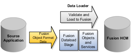

The following figure shows an overview of the data-load process.
To use the data loader, you:
Map data between your source application and Oracle Fusion HCM.
Extract data from your source application and place it in the data loader stage tables in the supported Oracle Fusion HCM object data format.
Run the Load Batch Data process to load the data into Oracle Fusion HCM.
