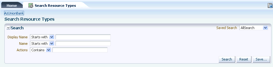

Searching Resource Types
To search Resource Types, proceed as follows:
  1. Select from the following methods to display the Search Resource Types page as in Figure 3-7.
    • In the Navigation Panel, expand the Application node and double-click Resource Types.
      Alternately, right-click Resource Types and select Open.
    • In the Home area, select the appropriate Application Name and click Search under Resource Types.
      Figure 3-7 Searching for Resource Types
      Surrounding text describes Figure 3-7 .

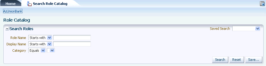

Searching Application Roles
To search Application Roles, proceed as follows:
  1. Select from the following methods to display the Search Role Catalog page.
    • In the Navigation Panel, expand Applications and the named Application node applicable to the search, and double-click Role Catalog.
      Alternately, right-click Role Catalog and select Open.
    • In the Home area, select the Application Name and click Search from Application Roles.
    The Search Role Catalog tab is displayed as in Figure 3-9.
    Figure 3-9 Searching for Application Roles in a Role Catalog
    Surrounding text describes Figure 3-9 .

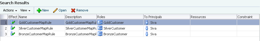

Searching Role Mapping Policies
  1. Select from the following methods to display the Search Role Mapping Policies page:
    • In the Navigation Panel, expand Applications and the named Application node applicable to the search, and double-click Role Mapping Policies.
      Alternately, right-click Role Mapping Policies and select Open.
    • In the Home area, select the Application Name and click Search from Role Mapping Policies.
    The Search Role Policies page is displayed as in Figure 3-11.
    Figure 3-11 Searching for Role Mapping Policies
    Surrounding text describes Figure 3-11 .

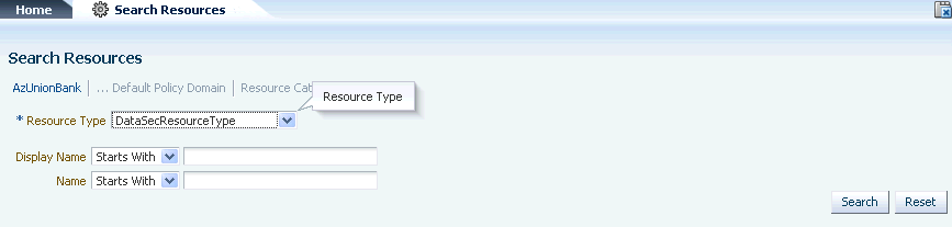

Searching Resources
A Resource can be hierarchical (a scenario in which the sub resource inherits attributes from the parent resource) or non-hierarchical. If a Resource is hierarchical, its tiered-organization is shown in the Search results. To search Resources, proceed as follows:
    • In the Navigation Panel, expand Applications and the named Application node applicable to the search. Expand the appropriate Policy Domain and Resource Catalog and double-click Resources.
      Alternately, right-click Resources and select Open.
    • In the Home area, select the Application Name and click Search from Resources.
    The Search Resources page is displayed as in Figure 3-13.
    Figure 3-13 Searching for Resources
    Surrounding text describes Figure 3-13 .

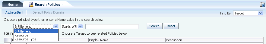

Searching Authorization Policies
Authorization Policies can be searched by specifying a policy name, a principal, or a target. To search Authorization Policies, proceed as follows:
  1. Select from the following methods to display the Search Policies page:
    • In the Navigation Panel, expand Applications and the named Application node applicable to the search. Expand the appropriate Policy Domain and Resource Catalog and double-click Authorization Policies.
      Alternately, right-click Authorization Policies and select Open.
    • In the Home area, select the Application Name, and click Search under Authorization Policies. (In this case, the search is done within the Default Policy Domain.)
    The Search Policies tab is displayed in Figure 3-15.
    Figure 3-15 Searching for Policies
    Surrounding text describes Figure 3-15 .
  2. Select the search type from the Find By list.
    The query parameters change according to the selection. Options include Policy, Principal or Target. Figure 3-15 is a screenshot in which Policy is selected. Figure 3-16 is a screenshot in which Target is selected.
    Figure 3-16 Searching Polices by Target
    Surrounding text describes Figure 3-16 .

      • Name: Select an operator from the list and enter a string to match.
      • Principal: Select an operator from the list and enter a string to match.
      • Target: Select an operator from the list and enter a string to match.
    • To Find By: Principal or Find By: Target, select an operator from the list, and enter a string to match.
      A Resource Type must be provided if the Resource or Resource Type operator is selected.
  4. Click Search.
