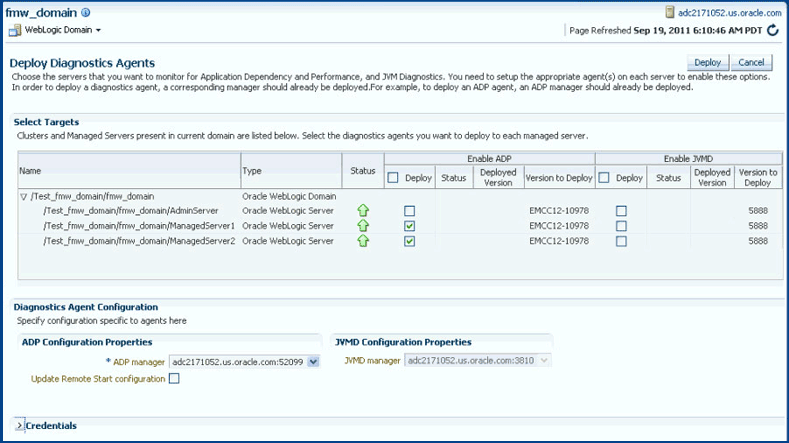

To deploy ADP Agents to a WebLogic Server, perform the following steps:
In Cloud Control, from the Targets menu, select Middleware.
The Middleware page displays a list of all the Middleware targets discovered and managed in Cloud Control. Click target name to select the desired target.
On the Middleware page, click Oracle WebLogic Domain. Ensure that the selected domain is not an Enterprise Manager Cloud Control domain (EMGC_DOMAIN).
ADP Agent cannot be deployed on a managed server (WebLogic Server) present in the Enterprise Manager domain.All the managed server present in the domain appear on the domain home page.
From the WebLogic Domain menu, select Diagnostics, and then click Setup Diagnostics Agents to deploy agents to the selected managed servers.
On the Deploy Diagnostics Agents page, choose the Oracle WebLogic Server (managed server) to which you want to deploy the ADP agents.
Ensure that you retain the selection of only those Diagnostic Agent(s) that you want to deploy to each of the managed server, deselect the others.
By default, the following servers appear deselected:
The Administration server is not selected by default.
All the managed servers that are not up and running appear deselected by default.
If the Deployed Version and the Version to Deploy are the same, and the status of already deployed ADP agent is up and running.
In Addition to the managed server selected, the ADP Agent is deployed to the Administration Server of the selected domain.In the Diagnostics Agent Configuration section, enter the ADP Configuration Properties for the selected agents:
Select the desired ADP Manager from the ADP Manager list.
The ADP agents selected for deployment will report to the selected ADP Manager.
If you select the Update Remote Start configuration option, then some configuration scripts run in the background to facilitate the monitoring process. Select this option if you use node manager to stop or start the WebLogic Servers to which ADP agent is being deployed.
For more information about the NodeManager, see Oracle Enterprise Manager Cloud Control Advanced Installation and Configuration Guide.
If the version of the WebLogic Server is greater than 9.2.X, and if the Management Agent is used to discover the monitored WebLogic domain which is not JRF enabled, then an Additional Configuration section appears.
In the WebLogic Home field, enter the absolute path to the WebLogic home of the monitored domain.
If the WebLogic Middleware Home field appears, then enter the absolute path to the WebLogic Middleware Home of the monitored domain.
In the Credentials section, provide Oracle WebLogic Administration Server Host Credentials , Oracle WebLogic Domain Credentials, Oracle Enterprise Manager WebLogic Administration Server Host Credentials, and Oracle Enterprise Manager WebLogic Domain Credentials.
Where,
Oracle WebLogic Administration Server Host Credentials are credentials for the host where the WebLogic Administration Server is running.
Oracle WebLogic Domain Credentials are credentials of the monitored Weblogic domain in the Enterprise Manager Cloud Control.
Oracle Enterprise Manager WebLogic Administration Server Host Credentials are required to access the host where the WebLogic administration server for the Cloud Control domain is running.
Oracle Enterprise Manager WebLogic Domain Credentials are required to access the Enterprise Manager Cloud Control domain.
For more information about selecting credentials, see Selecting Credentials.
Click Deploy to submit the job. A Diagnostics Agent Deployment status page appears:
The status page appears with a link to the job status. Click the link to see the status of the job that you submitted.
