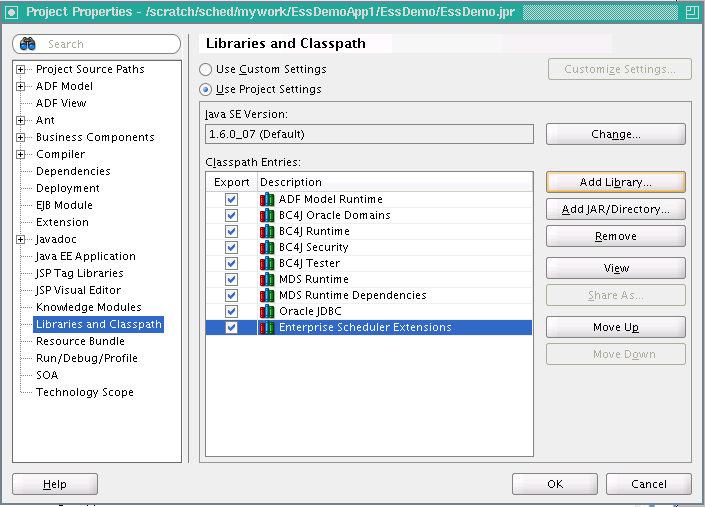

5.2.3 How to Set Project Properties for Oracle Enterprise Scheduler
You need to add the Oracle Enterprise Scheduler extensions to the project before you use the Oracle Enterprise Scheduler APIs.
To allow Oracle JDeveloper to use Oracle Enterprise Scheduler extensions:
  1. In Oracle JDeveloper, in the Application Navigator select the EssDemo project.
  2. Right-click and from the dropdown list select Project Properties....
  3. In the Project Properties navigator, select Libraries and Classpath.
  4. In the Libraries and Classpath area, click Add Library....
  5. In the Add Library dialog, in the Libraries area select Enterprise Scheduler Extensions.
  6. In the Add Library dialog click OK. This adds the appropriate libraries, as shown in Figure 5-5.
    Figure 5-5 Adding Oracle Enterprise Scheduler Extensions to Project
    Adding Enterprise Scheduler Extensions to Project
    Description of "Figure 5-5 Adding Oracle Enterprise Scheduler Extensions to Project"

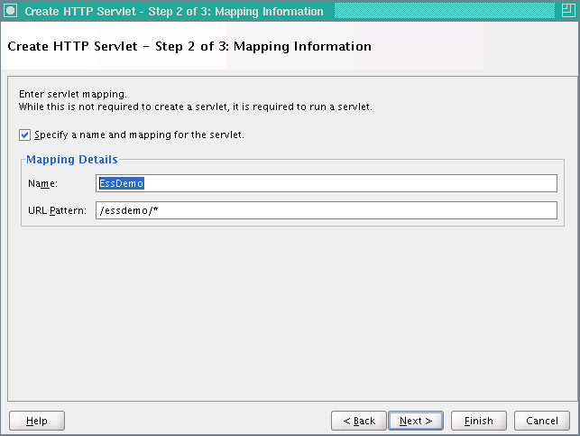

  12. In the Create HTTP Servlet - Step 2 of 3: Mapping Information dialog, in the Name field, enter: EssDemo
  13. In the Create HTTP Servlet - Step 2 of 3: Mapping Information dialog, in the URL Pattern field, enter: /essdemo/*, as shown in Figure 5-11.
    Figure 5-11 Using the Create HTTP Servlet Wizard: Step 2 of 3 Dialog

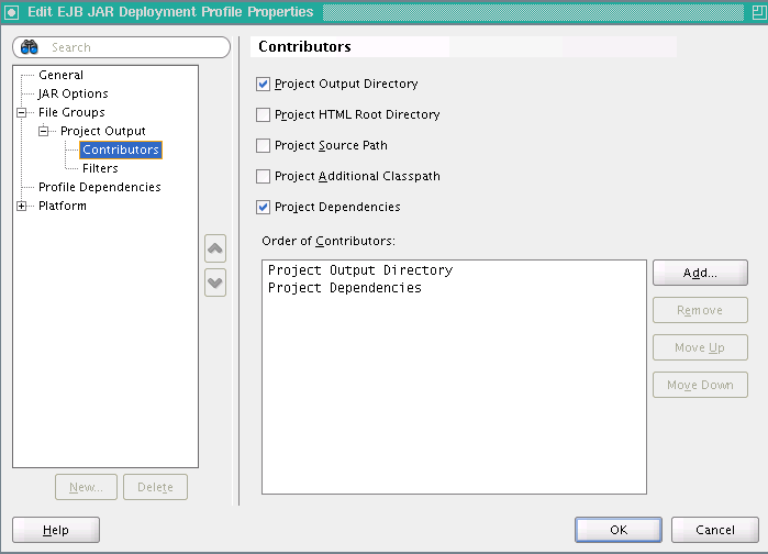

  11. In the EJB JAR Deployment Profile Properties dialog, in the Navigator expand File Groups and expand Project Output, and select Contributors.
  12. In the Contributors area select Project Output Directory and Project Dependencies as shown in Figure 5-20.
    Figure 5-20 Selecting EJB Contributors for the EJB JAR Deployment
  13. In the EJB JAR Deployment Properties dialog, in the Navigator expand File Groups and Project Output, and select Filters.
  14. Select the META-INF folder and the essdemo folder as shown in Figure 5-21.
    Figure 5-21 EJB JAR Deployment Profile File Groups Filters

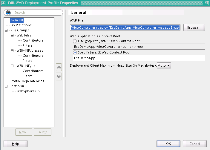

To update WAR archive options:
  1. In the Application Navigator, select the ViewController project.
  2. Right-click and select Project Properties....
  3. In the Navigator, select Deployment.
  4. In the Deployment page, in the Deployment Profiles area select the WAR File.
  5. Click Edit.... This displays the Edit WAR Deployment Profile Properties dialog.
  6. In the Edit War Deployment Profile Properties dialog, select General and configure the General page as follows, as shown in Figure 5-22:
    1. Set the WAR File: path_to_mywork /mywork/EssDemoApp/ViewController/deploy/EssDemoApp_ViewController_webapp1.war
    2. In the Web Application Context Root area, select Specify Java EE Web Context Root:
    3. In the Specify Java EE Web Context Root: text entry area, enter EssDemoApp.
    4. In the Deployment Client Maximum Heap Size (in Megabytes): dropdown list select Auto
    Figure 5-22 WAR Deployment Configuration Options
  7. In the Edit WAR Deployment Profile Properties dialog, click OK.

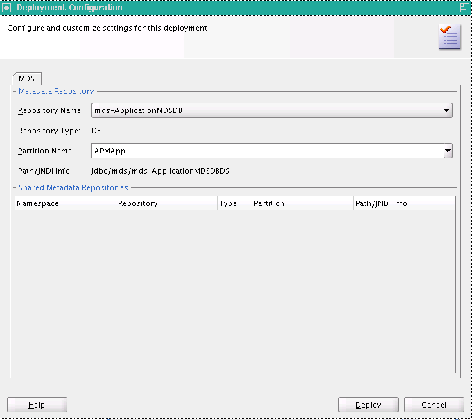

  4. Oracle JDeveloper shows the Deployment Configuration page, as shown in Figure 5-29. Select the appropriate options for your Metadata Repository.
    Figure 5-29 Deployment Configuration Page with Metadata Repository Options
    Deployment configuration page with MDS options
    Description of "Figure 5-29 Deployment Configuration Page with Metadata Repository Options"

    To check and set the context-root value in the WAR archive:
    1. Select the ViewController project.
    3. In the navigator, select Deployment.
    4. In the Deployment Profiles area, select essdemoapp and click Edit.
    5. Choose the desired context-root, this forms the context-root on the URL to access the application.
    6. In the General area, select Specify Java EE Web Context Root.
    7. For the Java EE Web Context Root: text entry area, enter EssDemoApp.
    8. In the WAR Deployment Profile Properties window, click OK.
    9. In the Project Properties window, click OK.

  11. Click the Libraries and Classpath navigation tab.
  12. Click Add Library, select Enterprise Scheduler Extensions, and click OK.

  5. Optionally, in the Edit EJB JAR Deployment Profile Properties dialog, expand File Groups, expand Project Output, and select Filters and clear the essmeta check box.
    Clearing this check box prevents the JAR file from being cluttered with unnecessary XML files and reduces the overall memory footprint.

  15. In the Edit EAR Deployment Profile dialog, click the General navigation tab and enter EssDemoApp in the Application Name field.

  3. When the Deployment Configuration dialog appears, make a note of the default values, but do not change them.

  7. In the Application Navigator, right-click the SuperWeb project and choose Project Properties.
  8. Click the Libraries and Classpath navigation tab.
  9. Click Add Library, select ADF Web Runtime and Enterprise Scheduler Extensions, and click OK.

  2. In the New Gallery, expand Web Tier, select Servlets and then HTTP Servlet, and click OK.
  3. In the Web Application page of the Web Application wizard, select Servlet 2.5\JSP 2.1 (Java EE 1.5).
  4. In the Create HTTP Servlet - Step 1 of 3: Servlet Information page, enter EssDemoAppServlet in the Class field.
  5. Enter oracle.apps.ess.howto in the Package field and click Next.

  4. Click the Servlets navigation tab and click the Servlet Mappings tab.
  5. Change the /essdemoappservlet URL pattern to /essdemoappservlet/*.

5.9.2.9.1 How to Assemble the EJB JAR File for the Front-End Submitter Application
The EJB Java archive file includes descriptors for the Java job implementations.
To assemble the EJB JAR File for the front-end submitter application:
  1. In Application Navigator, right-click the SuperEss project and choose New.
  2. In the New Gallery, expand General, select Deployment Profiles and then EJB JAR File, and click OK.
  3. In the Create Deployment Profile dialog, set the Deployment Profile Name to JAR_SuperEssEjbJar.
  4. On the Edit EJB JAR Deployment Profile Properties dialog, click OK.
  5. On the Project Properties dialog, click OK.
5.9.2.9.2 How to Assemble the WAR File for the Front-End Submitter Application
You need to create a web archive file for the web application.
To assemble the WAR file for the front-end submitter application
  1. In Application Navigator, right-click the SuperWeb project and choose New.
  2. In the New Gallery, expand General, select Deployment Profiles and then WAR File, and click OK.
  3. In the Create Deployment Profile dialog, set the Deployment Profile Name to WAR_SuperWebWar.
  4. On the Edit WAR Deployment Profile Properties dialog, click the General navigation tab, select Specify Java EE Web Context Root, and enter ESSDemoApp.
  5. Click OK.
  6. On the Project Properties dialog, click OK.

  7. In the Create Deployment Profile dialog, select EAR File from the Archive Type dropdown list.
  8. In the Name field, enter EAR_EssDemoAppUIEar and click OK.
  9. In the Edit EAR Deployment Profile dialog, click the General navigation tab and enter EssDemoAppUI in the Application Name field.
  10. Click the Application Assembly navigation tab, then select MAR_ESSDemoAppUIMar and select JAR_SuperEssEjbJar.
  11. Click OK.
  12. In the Application Properties dialog, click OK.

  1. From the main menu, choose Application > Deploy > EAR_EssDemoAppEar...
  2. Set up and deploy the application to a container.
  3. On the Deployment Configuration dialog, there should be two entries in the Shared Metadata Repositories panel. Find the shared repository mapped to the /oracle/apps/ess/howto namespace. Change its partition to the partition used when deploying EssDemoApp. If you used the default value, this should be EssDemoApp_V2.0.
  4. Click OK.
