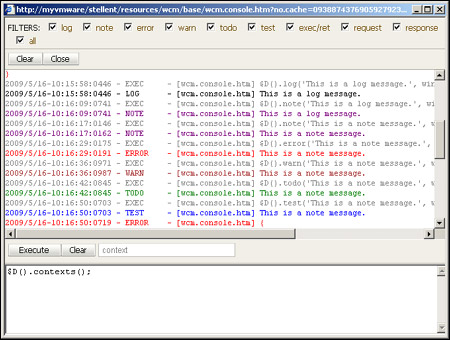

Figure 15-1 Contributor Console Window
Console window
Description of "Figure 15-1 Contributor Console Window"
Element Description
Filters Select the message types to display.
Clear Clears the logging window.
Close Closes the Customize dialog.
Execute Executes the code entered in the command window.
Clear Clears the command window.
Context field Enter the context (file name or ID) to execute within.
Command Enter the command or scripts to run.
