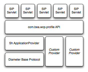

OWLCS includes a profile service API, com.bea.wcp.profile.API
, that may have multiple profile service provider implementations. A profile provider performs the work of accessing XML documents from a data repository using a defined protocol. Deployed SIP Servlets and other applications need not understand the underlying protocol or the data repository in which the document is stored; they simply reference profile data using a custom URL, and OWLCS delegates the request processing to the correct profile provider.
The provider performs the necessary protocol operations for manipulating the document. All providers work with documents in XML DOM format, so client code can work with many different types of profile data in a common way.
Figure 13-1 Profile Service API and Provider Implementation
